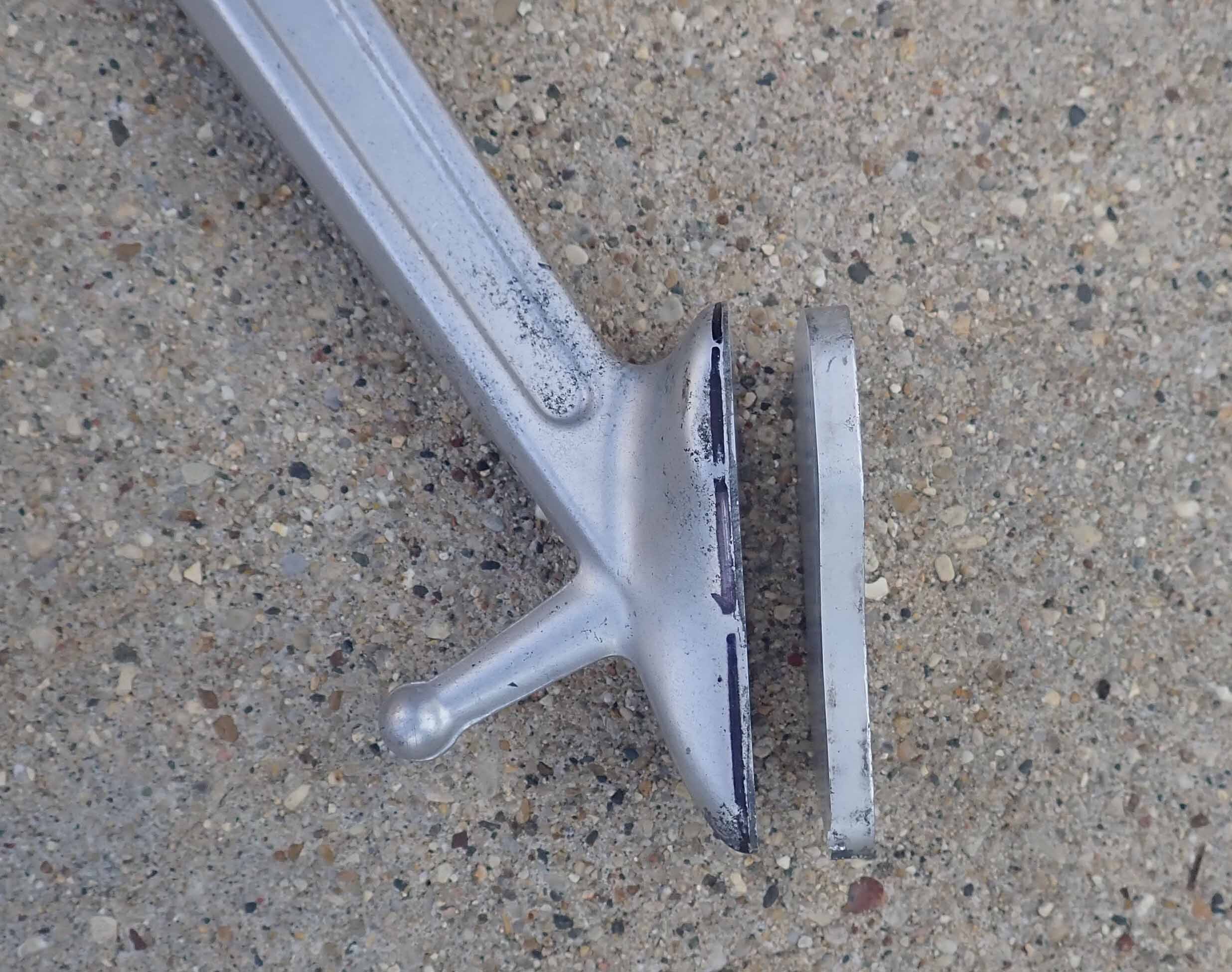

    I recently sold my 2015 Explorer XC, however, I am the same height as you are and I found lowering it 20mm using the Lust Lowering links helped quite a bit. I took a used Explorer side stand I bought off ebay and trimmed 5/16 of an inch off the bottom. I used a 12 inch miter saw with a Diablo 96 tooth non-ferrus metal blade D1296L. I set the saw at about a 40 degree miter and braced the stand on the base of the saw with a couple small boards. I cut slowly and it worked like a champ. I am not encouraging any one to try this nor do I claim it is safe. Can you tell I am a retired attorney?
    If you are concerned about how thin the foot on the stand is after cutting, it is still thicker than the stock stand on my Triumph Trophy.
    It provided the perfect lean angle for me when parking my bike with the 20mm lowering links installed.
