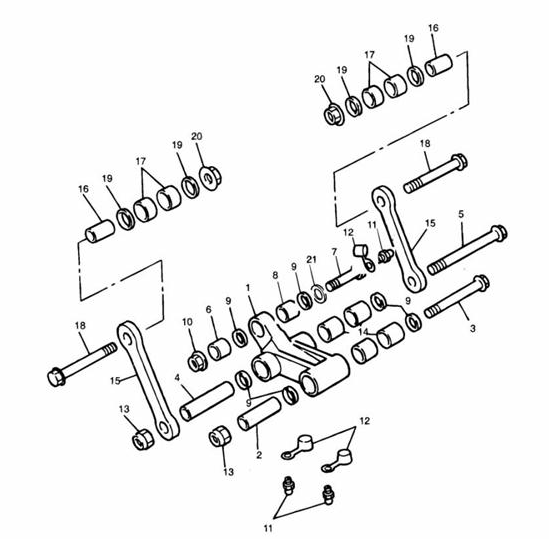

    Hi there. I'm trying yo get hold of a new lower fixing bolt. Part number 330251. Apparently they aren't made anymore. Anyone sourced an alternative please. Thanks. Ian

    Thanks big lad. I've tried a few sources but the original has a grease nipple built in. Unusual but I wanted to get an authentic part

    I'm trying to identify the exact part you need and can't - is it on this diagram and if it is, what number?

    Yes, that the correct drawing. It's number 3' but it doesn't show the grease nipple. It's listed as no longer available. It's an M12 x 119mm torx. Thanks

    Actually, it might be number 7. I'll re-check the bike

    IF it's no. 7 the part number is: PFKL1205091 and the cost is £ 7.04 (€ 8.45)+ vat .

    It is number 7 and fowlers have them. Problem solved. Next time I won't listen to my triumph dealer!!!
