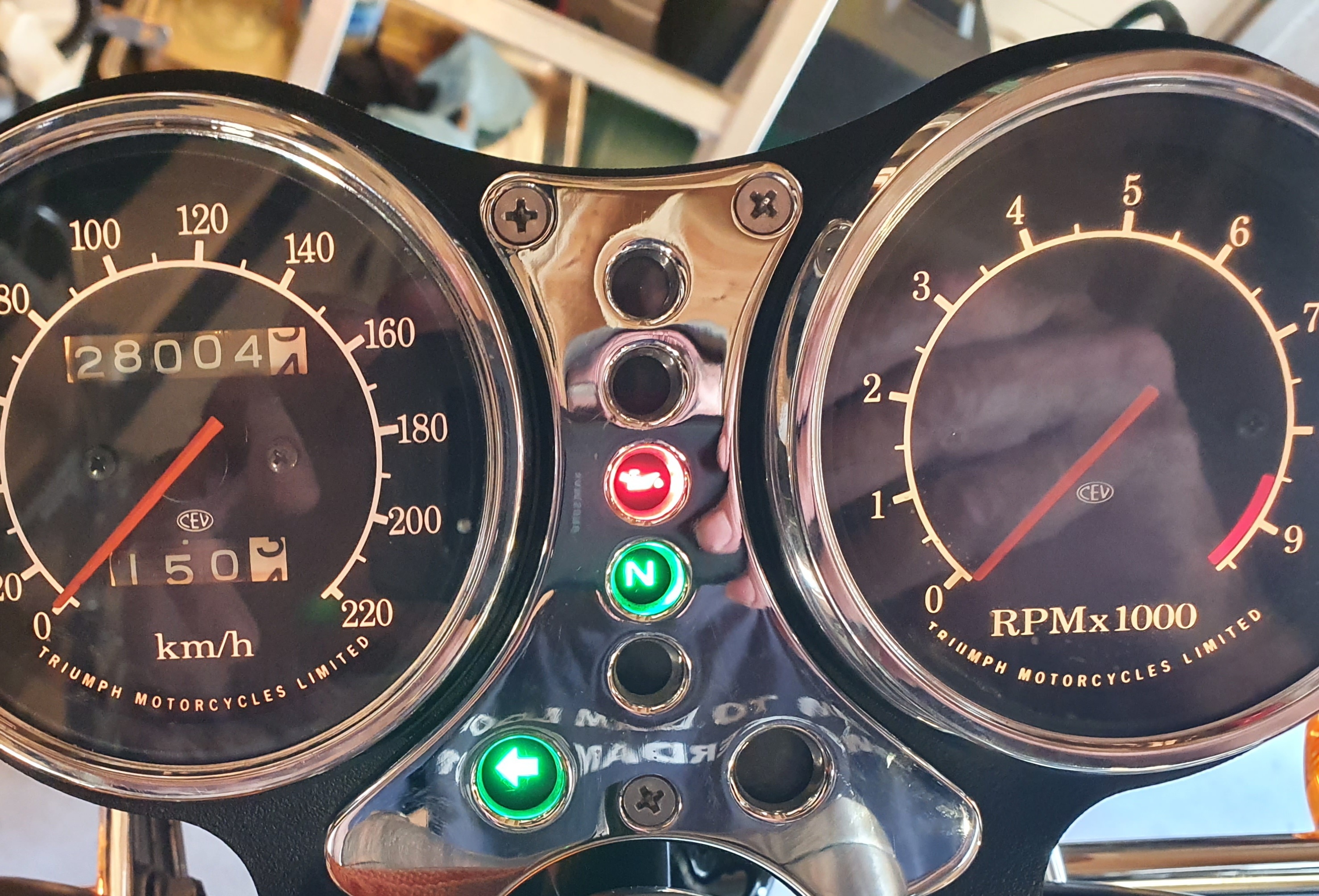

As I had to order from abroad anyway, I got these wedge type LEDs from superbrightleds.com in the US. You'll probably be able to get them in the UK. Here's my order: 3X 74-GHP: Green 2X 74-RHP: Red 1X 74-BHP: Blue 5X 194-WW5: Warm White The 194 LEDs were for the instruments, and I have so far not used them. The total order was 25 USD plus 18 USD shipping, but that was 2-3 years ago. A bit fiddly to replace the old ones, but absolutely doable.
