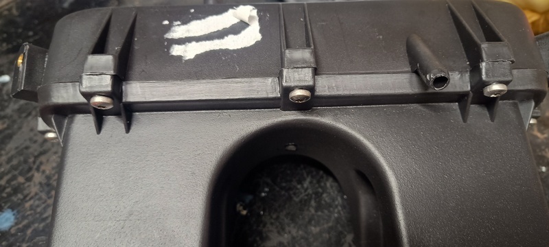

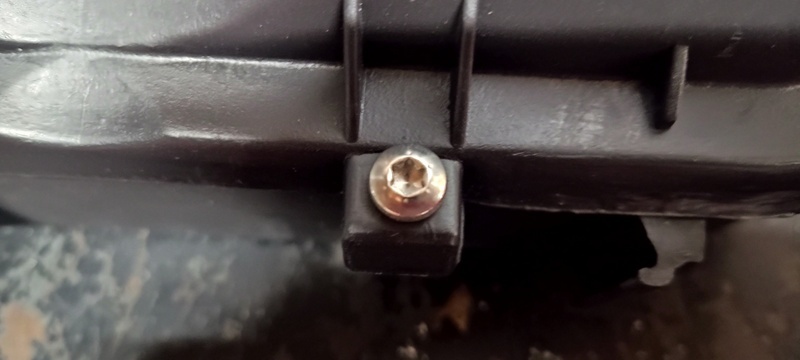

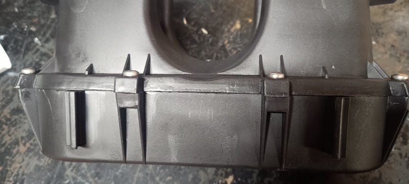

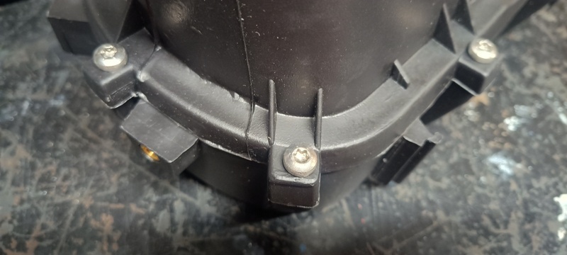

  6. Bikerman
    3,696
    It does split, this is my air box I bought a few years ago, I replaced the other one, and bought another air box for later.
    I've never split one myself mind.
    IMG_20250830_204457270.jpg IMG_20250830_204508852_HDR.jpg IMG_20250830_204523789.jpg IMG_20250830_204534595_HDR.jpg
  7. Mark TGR9
    Mark TGR9 Well-Known Member
    Jun 17, 2025
    370
    Rhuddlan North Wales
    Thanks biker man I thought it would do as there are quite a few different aftermarket filters available I just don't understand why triumph want to sell you a complete unit instead of just the filter Piper cross arrived today comes with a lifetime use guarantee but I suppose I will have to jump through a few hoops to claim on that if needed in the future
