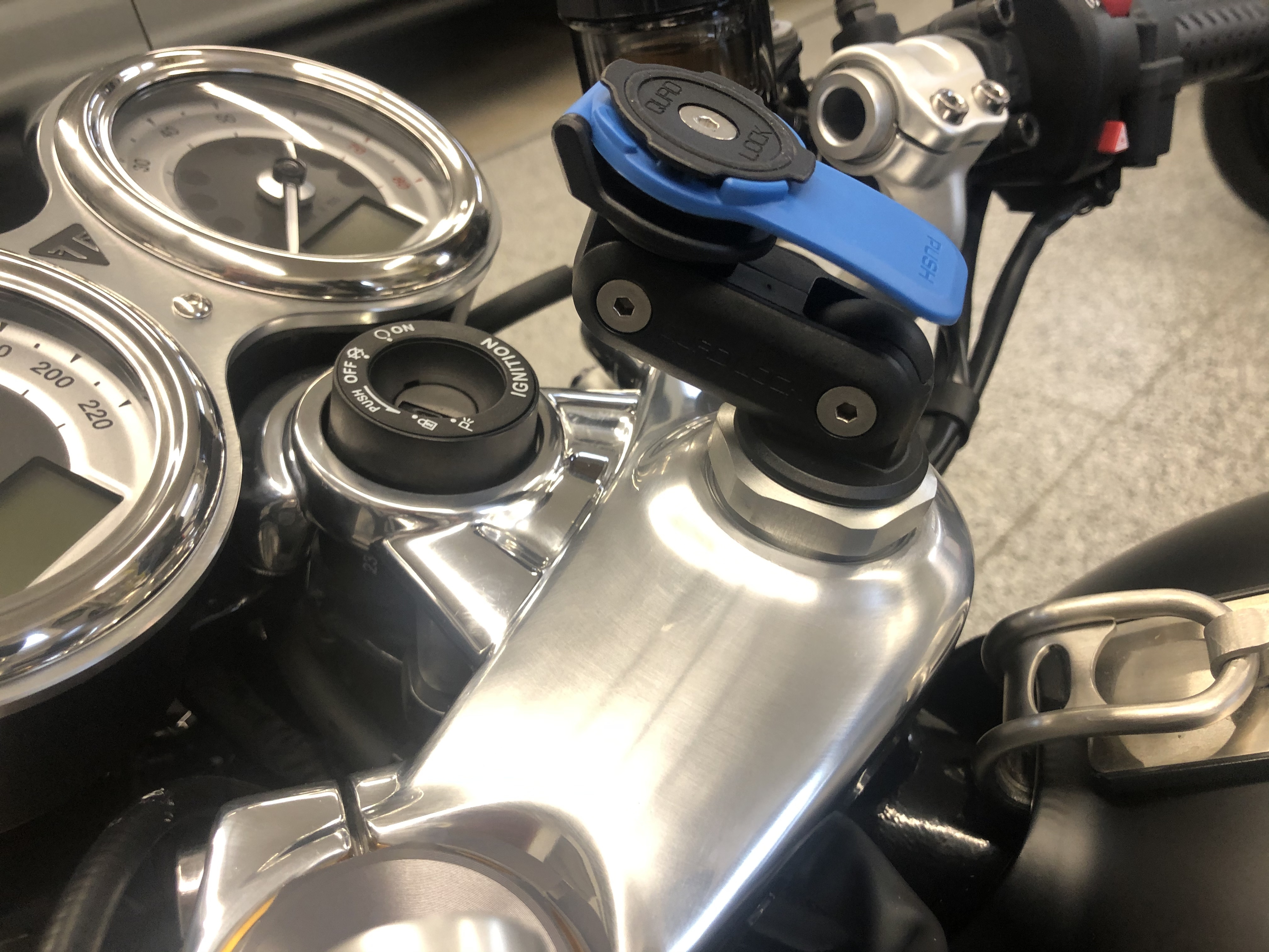

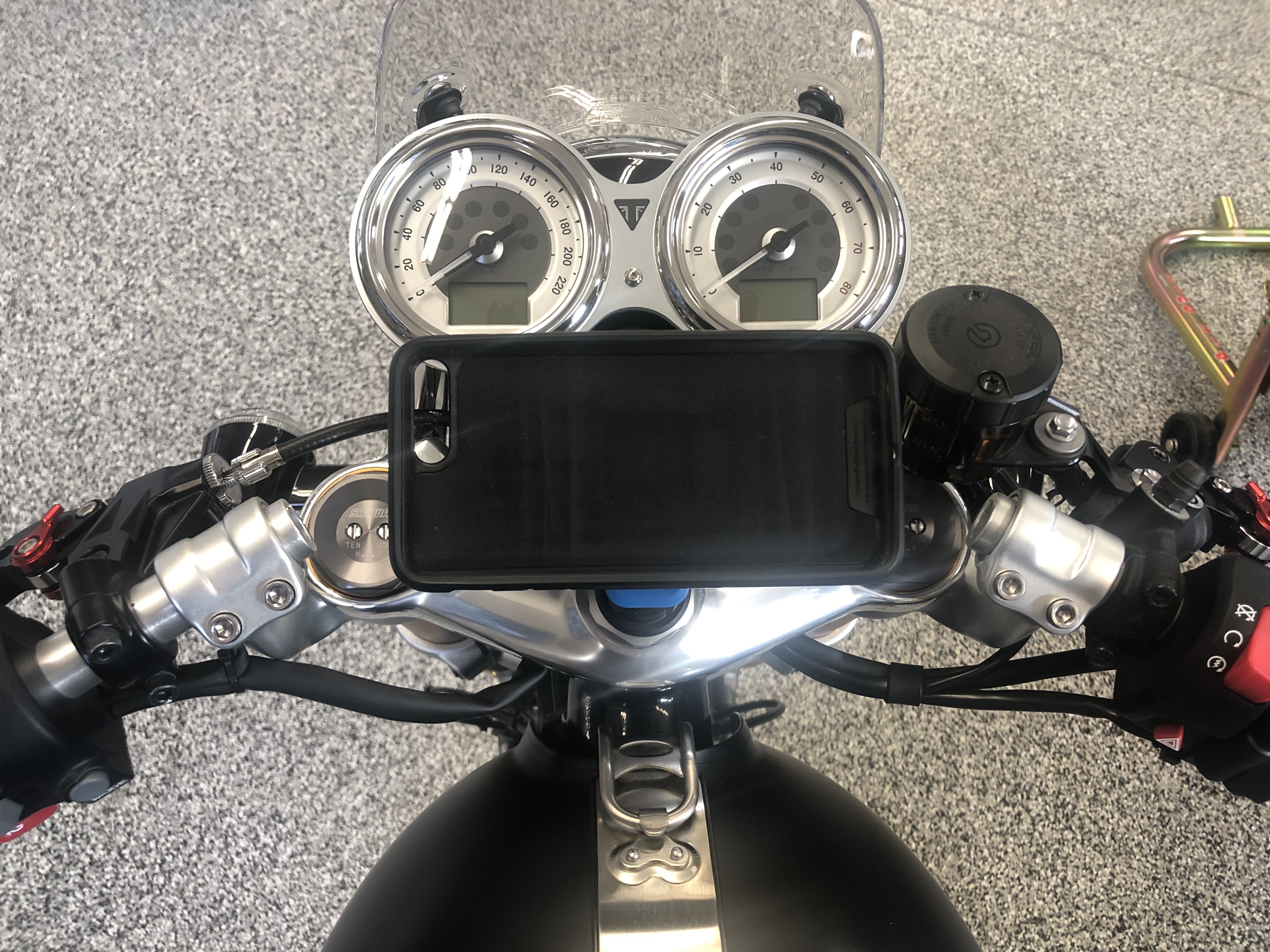

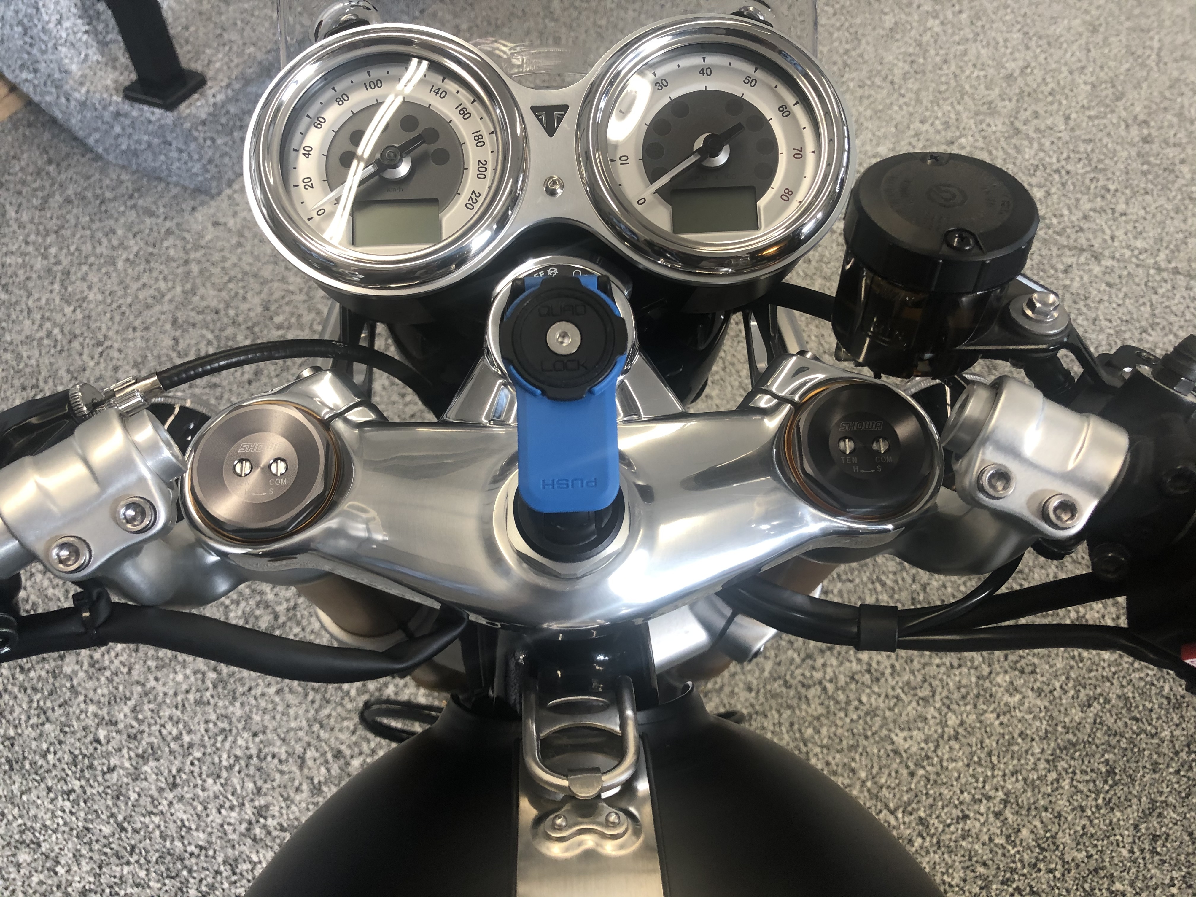

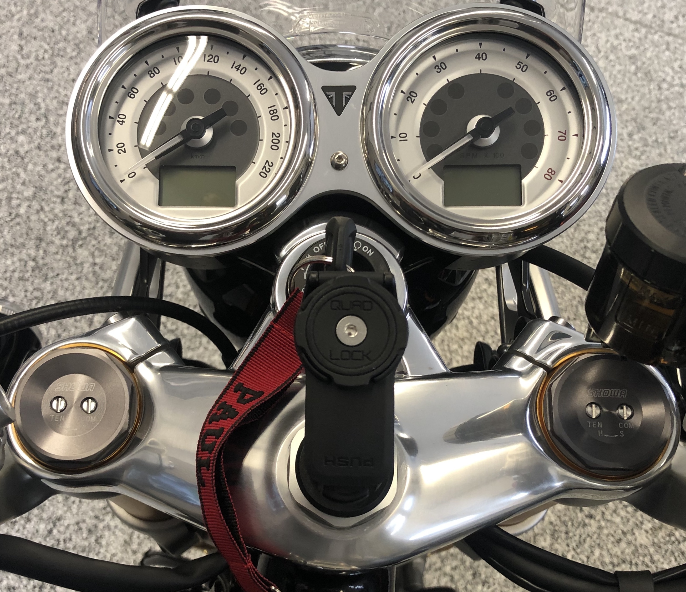

    I got the quadlock stem mount installed. It is super solid, seems great. I have a black tab coming for it, red and white are also available.
    I have an iPhone 8+ so pretty much any phone works with this mount location. I like their cases a lot. Now I just have to run the charge cord under the tank I suppose.
    New stem nut... and beautiful new levers
    Quadlock stem mount, gonna get a black tab for it.
    Installed the black lever
