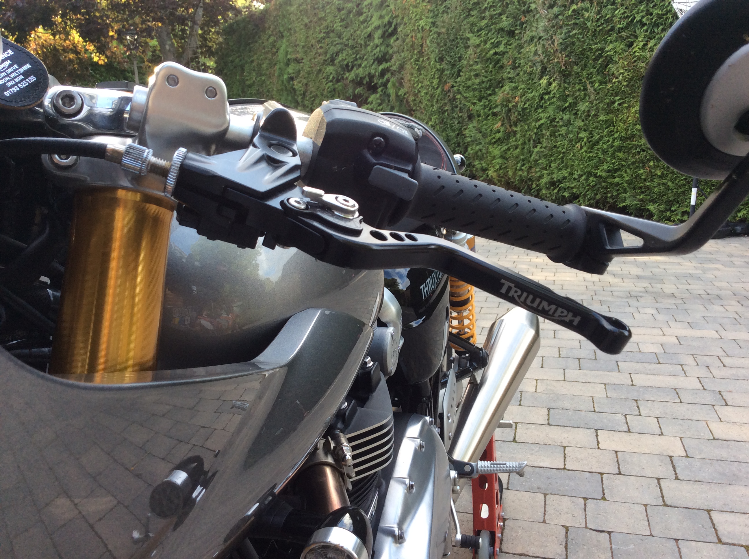

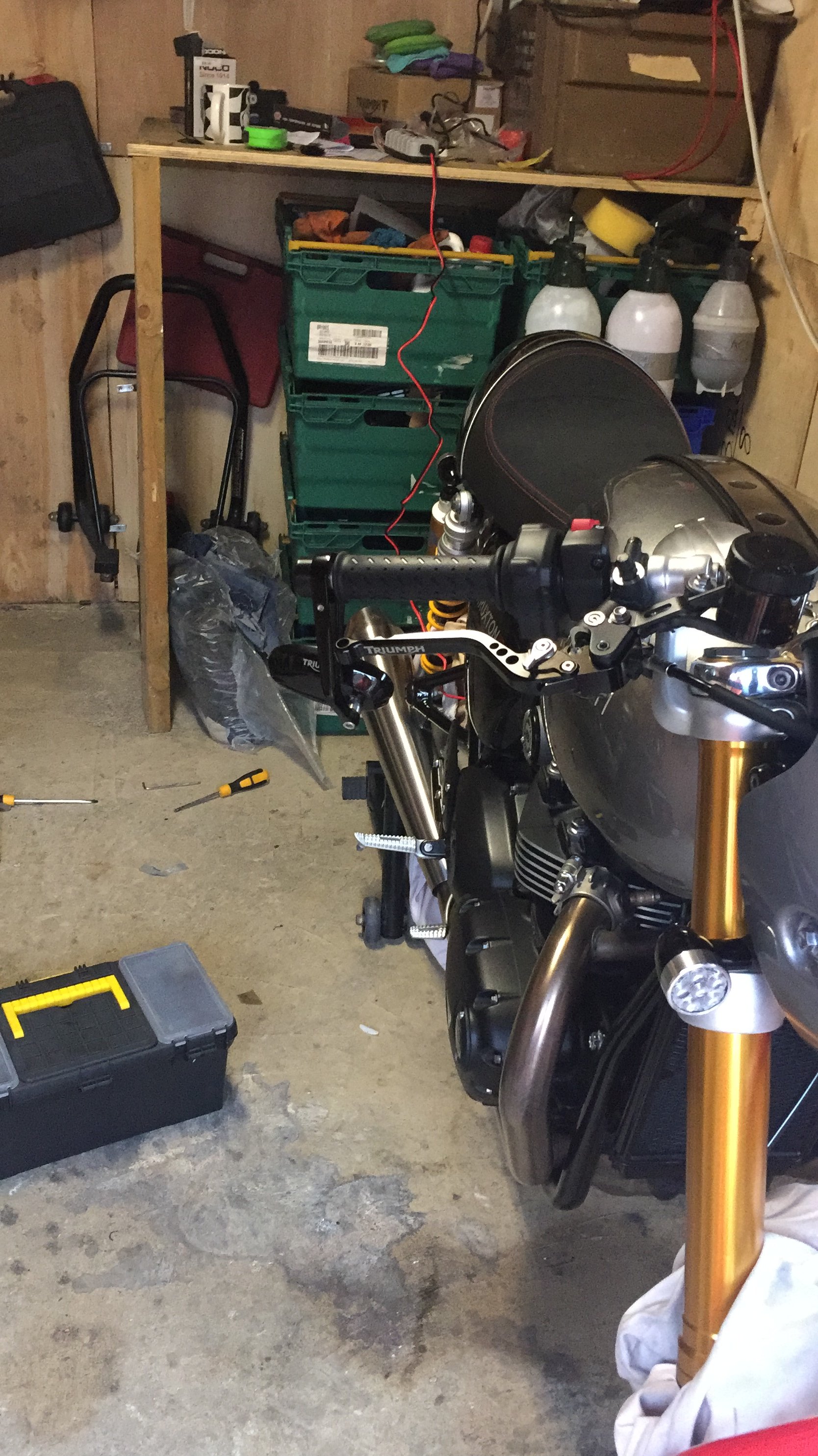

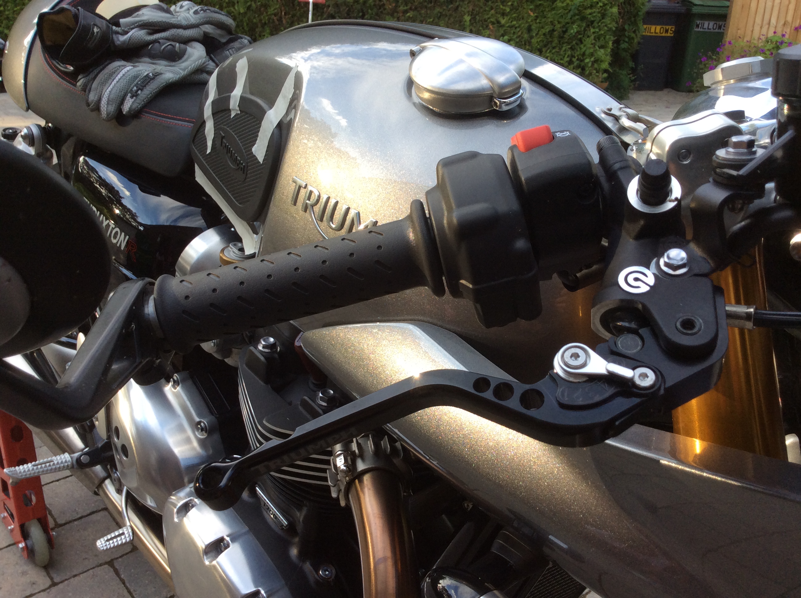

    If anyone is after levers for their R I can recommend these, got them from fleebay for a tad under £50, were posted same day and arrived two days later. The quality is very good and the etching really sets them off. As with Pazzo's you have to knock out the bushes on the Brembo lever to release the little plunger and you also need to use the bush from the clutch lever but its a 10 minute job to fit both.
    Ignore the masking tape on the second pic I'm just deciding if I like the look of the tank pads.

    Nice levers Drinky,
    I also didn't like having different levers on each side and went with some folding extendables.
    I used a 60mm long 6mm full length threaded screw with a countersunk head that wouldn't quite go through the sleeve insert. I slipped a hex socket on the other side (that the sleeve would go through) then a washer and a 6mm nut. Then I wound the sleeve out of the lever.
    Almost lost the tiny spring.

    Bought the same ones as Drinky. I've not been known for my patience but I can't get the flippin bushes out of the brembo lever to release the plunger.....any tips ?
    Also do you need to slacken the clutch cable or leave as is ?
    10 minute job has already resulted in a lot of swearing, good job the wife's not home !!

    I've had a big problem with these levers from jaybeebikerbits.
    I decided to take the bike with the levers down to my local triumph dealer as had concerns with the fitment. After about 10 minutes they confirmed they couldn't get the pivot holes to line up and were having to push the lever in more therefore pushing the plunge pin in further. We, they messed about for a while adjusting the plunger then took it for a test ride and after 500 yards down the road the front brakes locked on.
    I know members on here have bought these levers and jaybee sell thousands but the ones I bought clearly had been machined incorrectly. The guy at the dealer said they had a few doing the same thing albeit on other bike manufacturers.
    I, and the dealer agreed for the money they seem excellent value and look good quality but my concern is for someone without experience or knowledge in fitting levers could end up in serious shit !!
