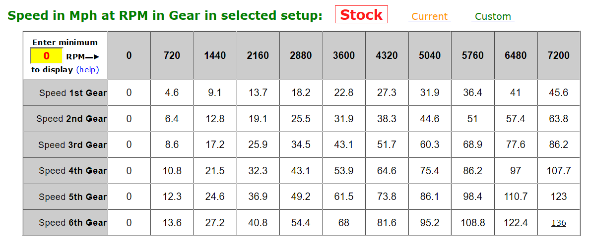

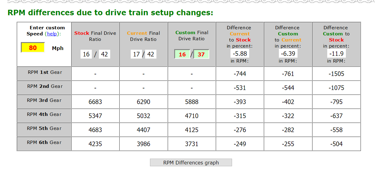

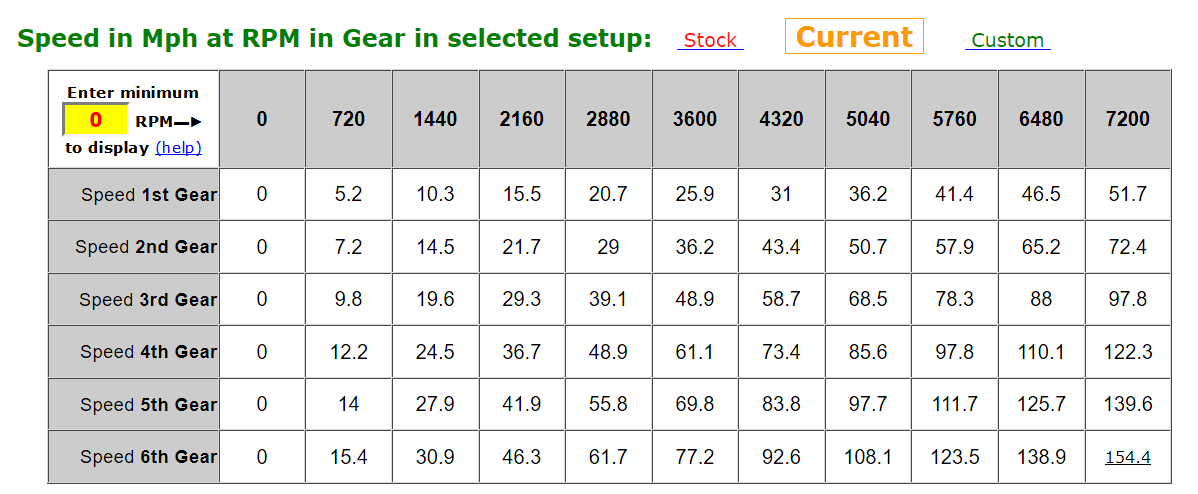

    No but I have put a T120 rear on my Thruxton and taken 2 links out of the chain.....One tooth on the front sprocket from a 16 to 17 is virtually unnoticeable....But, its inexpensive and easy to do, so why not give it a go and see how it works for you.
    bellow is what you will get with the rear from a T120 (37) compared to the stock Thruxton (42)

    Yes, 1 on the front is the equivalent of 3 on the rear. I have gone from 42 rear to 37 rear, to get a similar effect from the front you would need to go to 18 tooth from the stock 16 tooth, Triumph do not do an 18 tooth front sprocket to suit a 525 chain, so I went down five on the rear to get where I wanted to be. Which is as near as you can get to changing the front to 18, which is not enough
    If you go from 16 stock front to a 17 (stock T120 front) it makes next to no difference on the bike.
    I'm not sure where you get the "37/45 tooth on all bikes" rear thing from, the Thruxton R has a 42 tooth rear and the T120 has a 37 tooth rear....
    The two charts that I posted above show the difference after my modification between a stock Thruxton R with a stock rear 42 tooth sprocket and 37 tooth rear sprocket. Look at the chart, their isn't a huge difference and if you put a 17 tooth on the front you end up being more or less in the middle of those two charts, and that was not enough. The bottom chart is the stock Thruxton and the top one is same bike with a 37 tooth rear.
    With the 37 tooth rear I had to shorten the chain, if however I could have bought a 18 tooth front I would not have had to shorten the chain.
    This question is about the 2016 Thruxton R gearing which is way to short and I'm not sure what part of my first post you are disagreeing with...Maybe I should have explained the part about not being able to get a 18 tooth front sprocket.
    I have also told the OP to try the 17 tooth front first and see what they think, but as far as I'm concerned it made next to no difference.
    Useful tool, link below, the Thruxton R is in the database, use it as stock and you can alter whatever you want to in the Current or Custom columns. Click on the ones you want it to display and it shows you where you will end up after whatever change you make. It even shows chain length and the amount of distance you need to move the rear axle one way or the other to suit your gearing choice.
    great tool once you figure out how to use it....
    http://www.gearingcommander.com/

    Below is a chart of the rpm changes at 80 mph from the "stock" gearing, the "current" is with the 17 tooth T120 sprocket and stock 42 tooth rear Thruxton sprocket and "custom" is with the stock front Thruxton 16 tooth sprocket and T120 37 tooth rear.....
