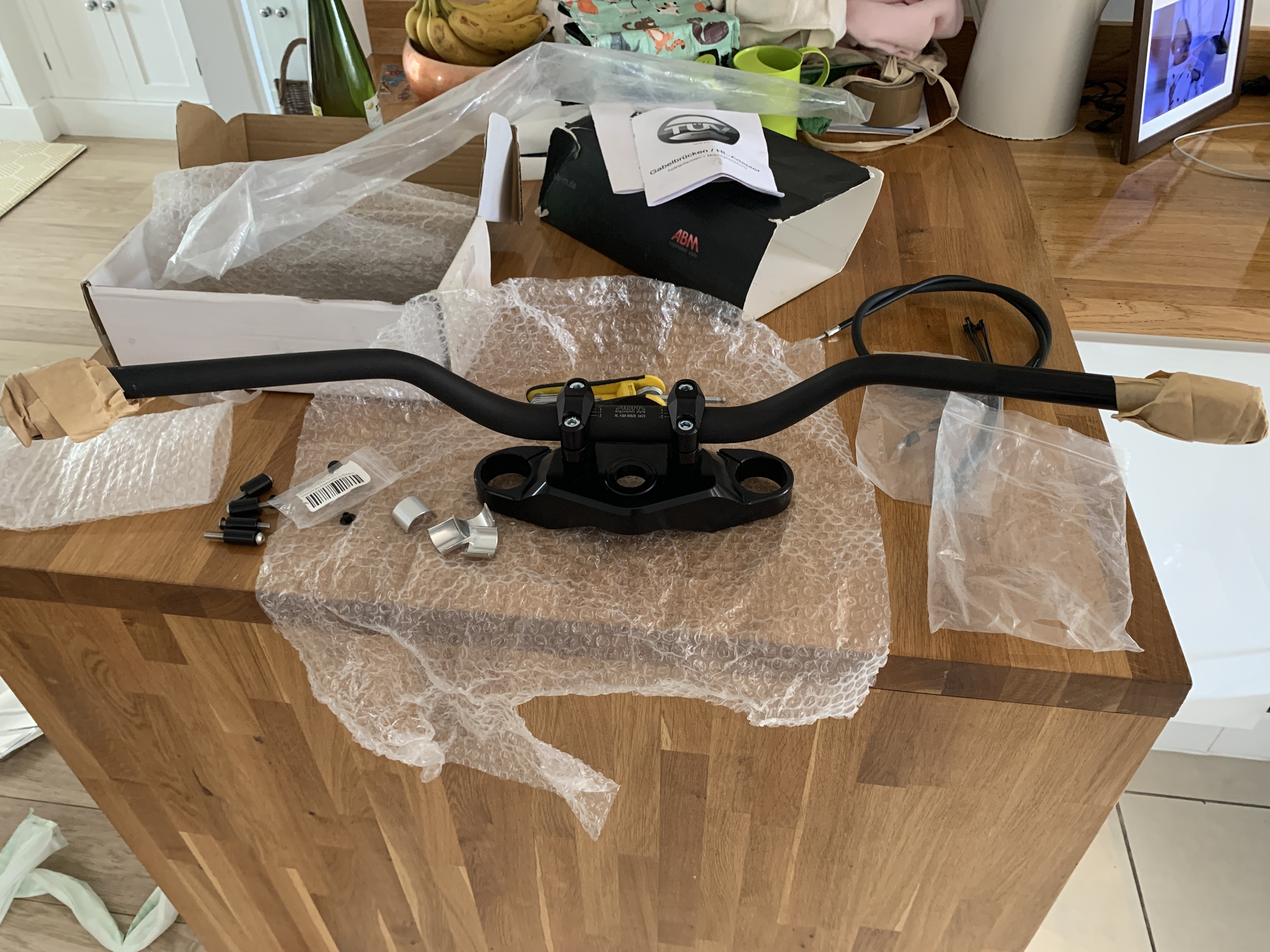

    So the kit arrived yesterday with no drama! Did a dry run just now and everything is there so roll on a week Monday!!!

    @Wessa did the garage who fitted your kit have any issues with the switch gear fitting? Mine have just rung saying the bars a way too small at the ends, almost like the wrong bars for the kit.
  19. Wessa
    11,903
    No didn’t have any issues. I know on the web site you had to select the bars for heated grips if they were fitted and a different bar for no heated grips. Other than that no issues mate.
