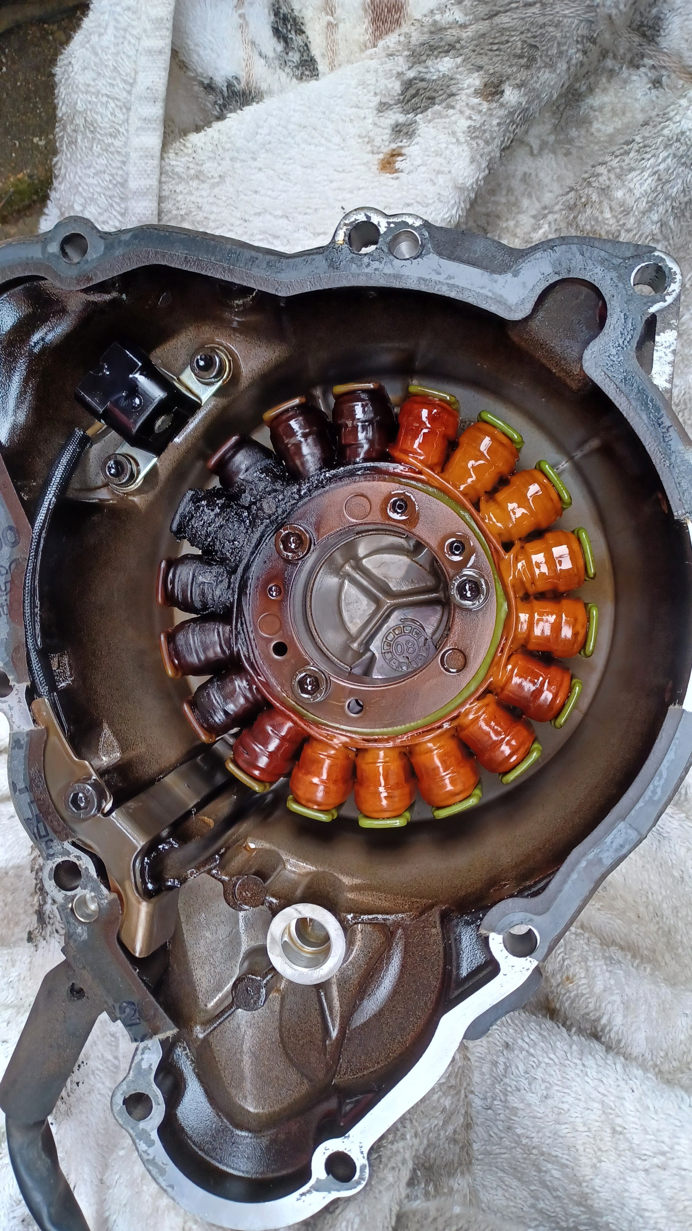

  20. Dave Teece
    Dave Teece Well-Known Member
    Jun 17, 2016
    174
    South Essex
    So...I had a mobile mechanic visit on Saturday. Long story short, the Street is behaving like a Triple again. Starts a treat and is running well. The throttle cable was inexplicably taught and seemed to have the position sensor confused. Charging, as it turns out, was the stator although I had measured the three phases for resistance.
