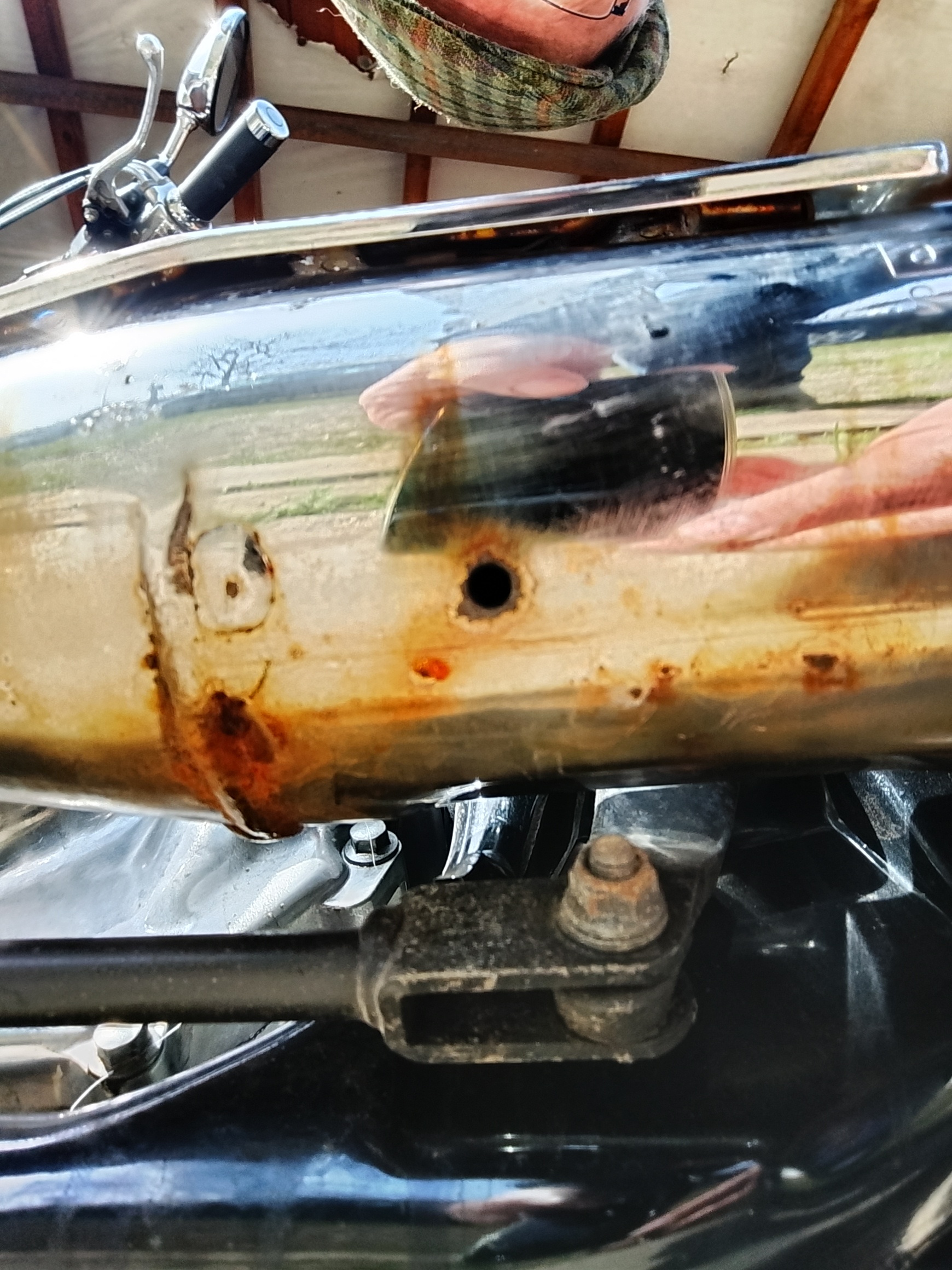

    Made another discovery today it seems that a previous owner has drilled 6mm or 8mm holes in the bottom of the mufflers by the first baffle only noticed when it started blowing the saw dust put down to mop up the petrol I spilled when the hose came out of the fuel can while emptying the tank.

    Well that nice spring clip was not sealing the hose it was leaking so it's been replaced with a hose clamp with a screw that tightens it ...... leak gone.
    Also discovered that someone in the past has drilled a hole into each muffler by the first baffle;-
    The mufflers are showing their 26 years of age too.

  6. Regit nogara
    Regit nogara Active Member
    Apr 22, 2025
    North, North Wales
    Drain holes ???
  7. Plezier
    Plezier Senior Member
    May 21, 2024
    435
    Gradina Bulgaria
    Maybe but as I seem to recall leaks like this would mean failure during an MOT have things changed on that score?
    The Honda forum has informed that they are standard. Well I intend the change the exhaust next month need to wait before spending more after the recent spending on jacks and parts.

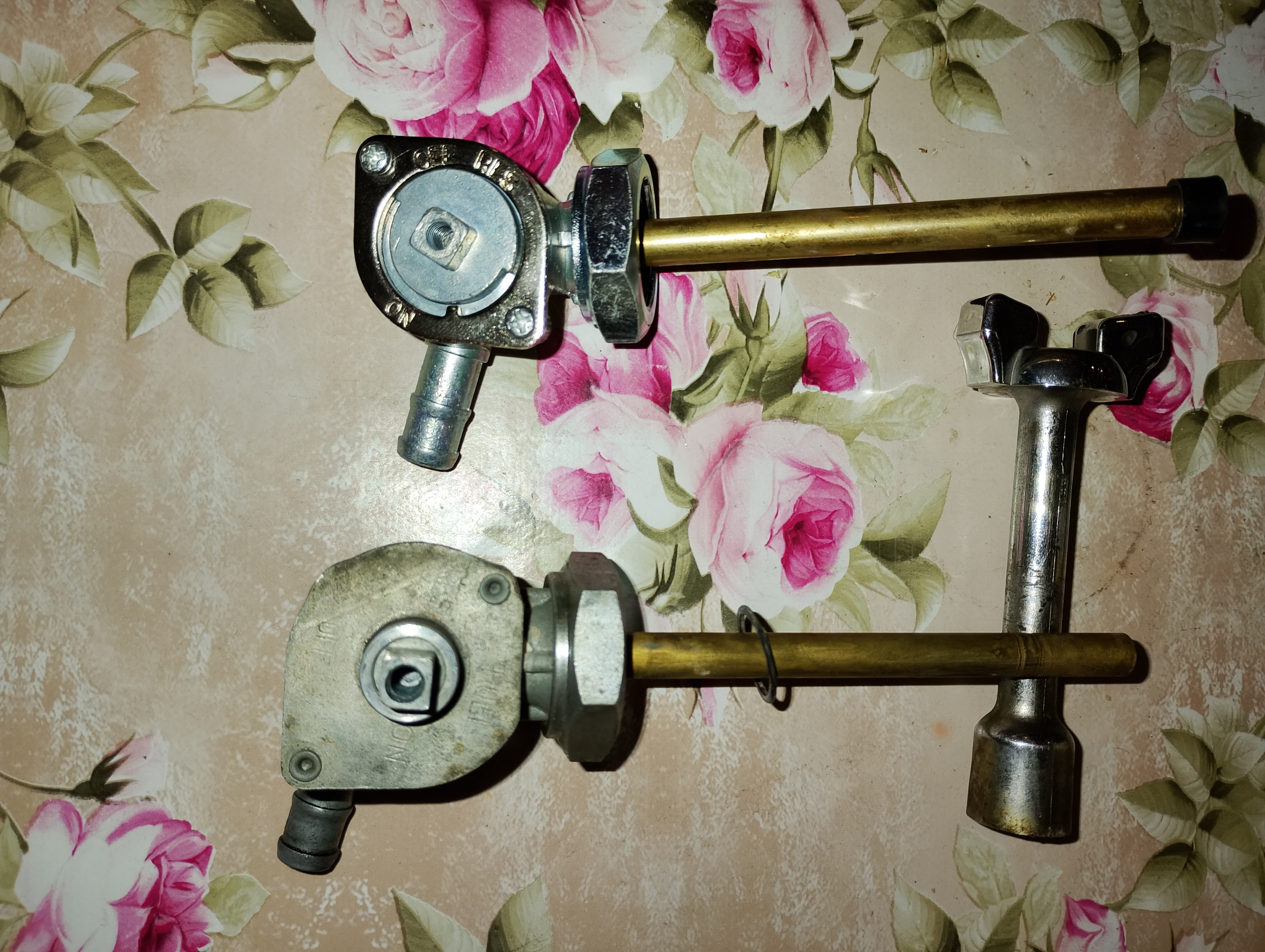

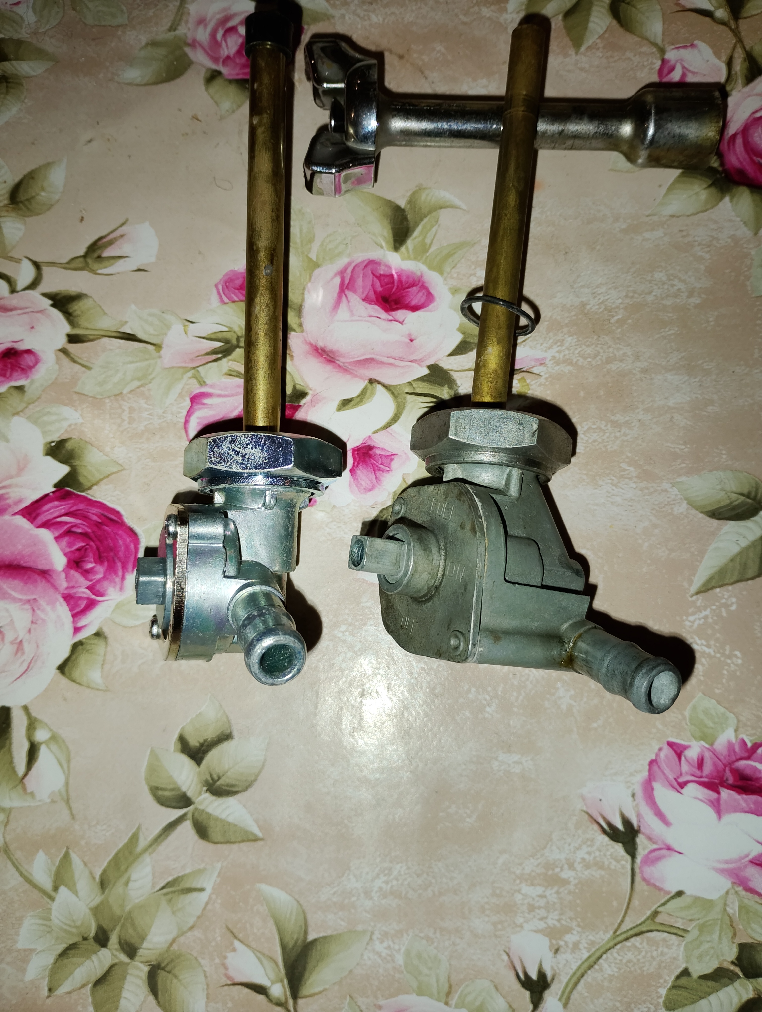

    Well the new fuel tap turned up this afternoon and so went to fit it and of course it's not the same as the original so it;s no good:-
    Have waited weeks for this when took it out of the box found the the plastic bag it was in had been opened and taped closed again am wondering if this had already been sent out once before. Have messaged the seller now have to wait and see what they say.
    Will have to visit the city again and the bike shop and ask them what they can get and how much.

    Well it's actually worse than the old tap that only drips this new one dribbles a constant flow the seller is actioning a refund and I have bought one using a link a member over on Shadow.net gave me for AliExpress it will take a few weeks to get here but they say it's a good make.
