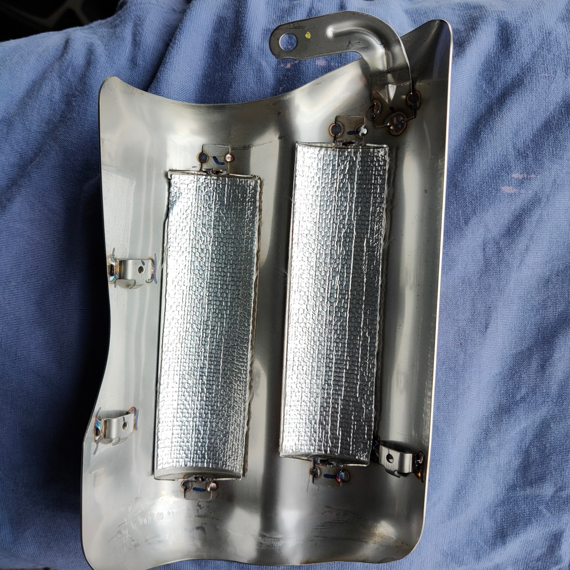

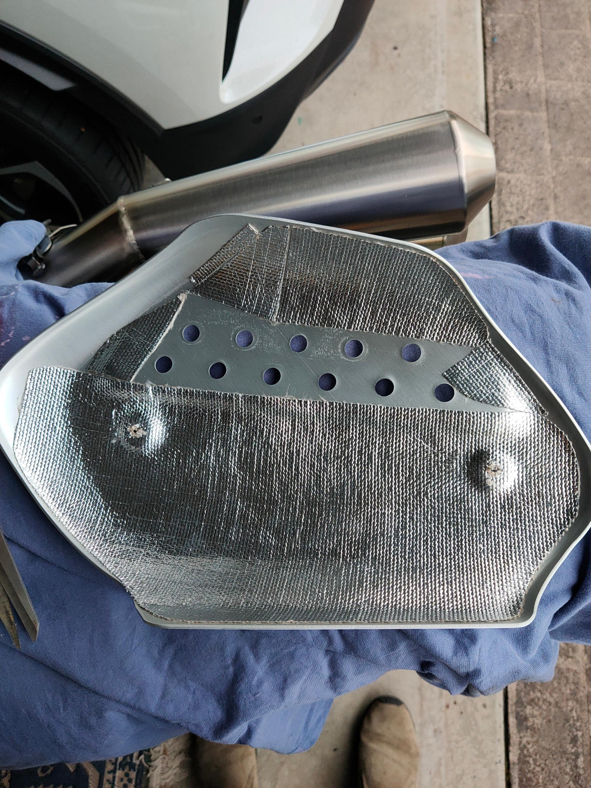

    I have coated the 3 heat shields with self adhesive heat mat from heat protection products. I can keep my bare hands on the rear and middle shields with out any problems. The front shield I can place a bare hand on briefly.

  19. Haro
    Haro Well-Known Member
    Jul 13, 2020
    158
    83
    Australia
    #19 Haro, Sep 29, 2020
    It is called Heat Protection Products heatshield. Several variations of it available. I bought the rolled up sheet with a self adhesive backing. I will get a photo of it later. You can use multiple layers if you want to. I have 2 layers on the front shield simply to use up all the sheet. It moulds to the shapes of the shields too, great stuff to work with. And yes, it has definitely made a difference.
