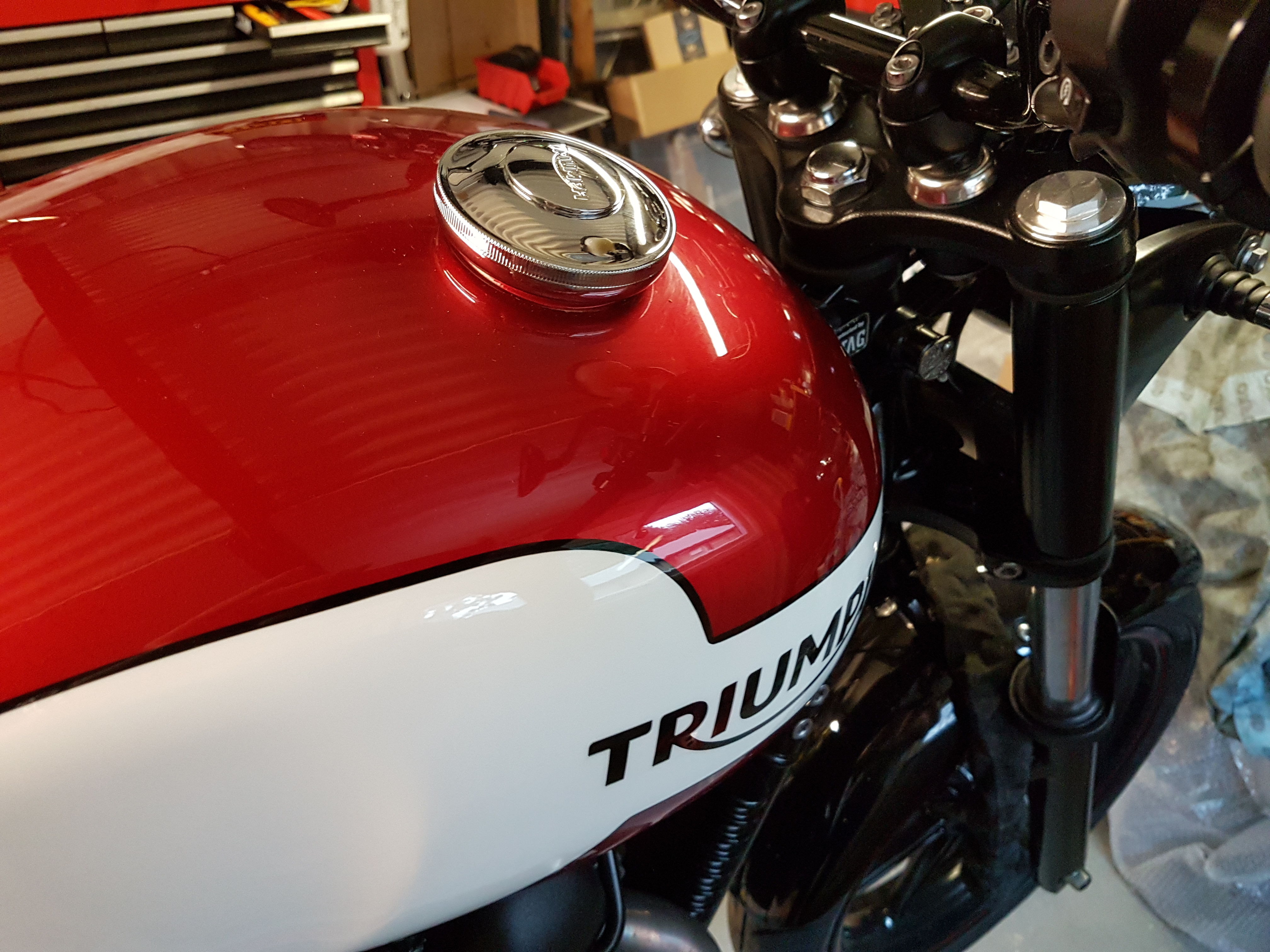

    First one was easy, add a locking fuel cap :)

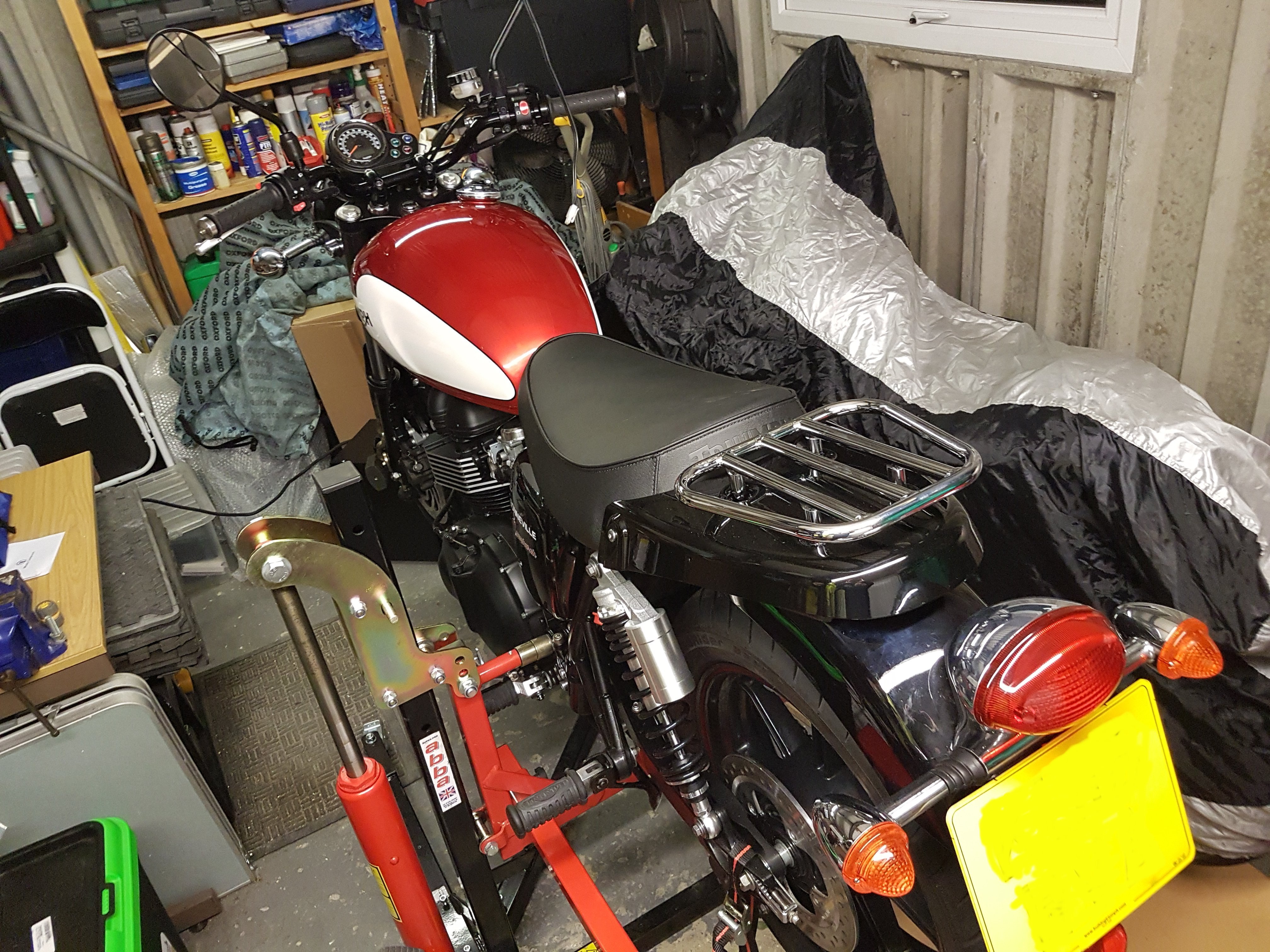

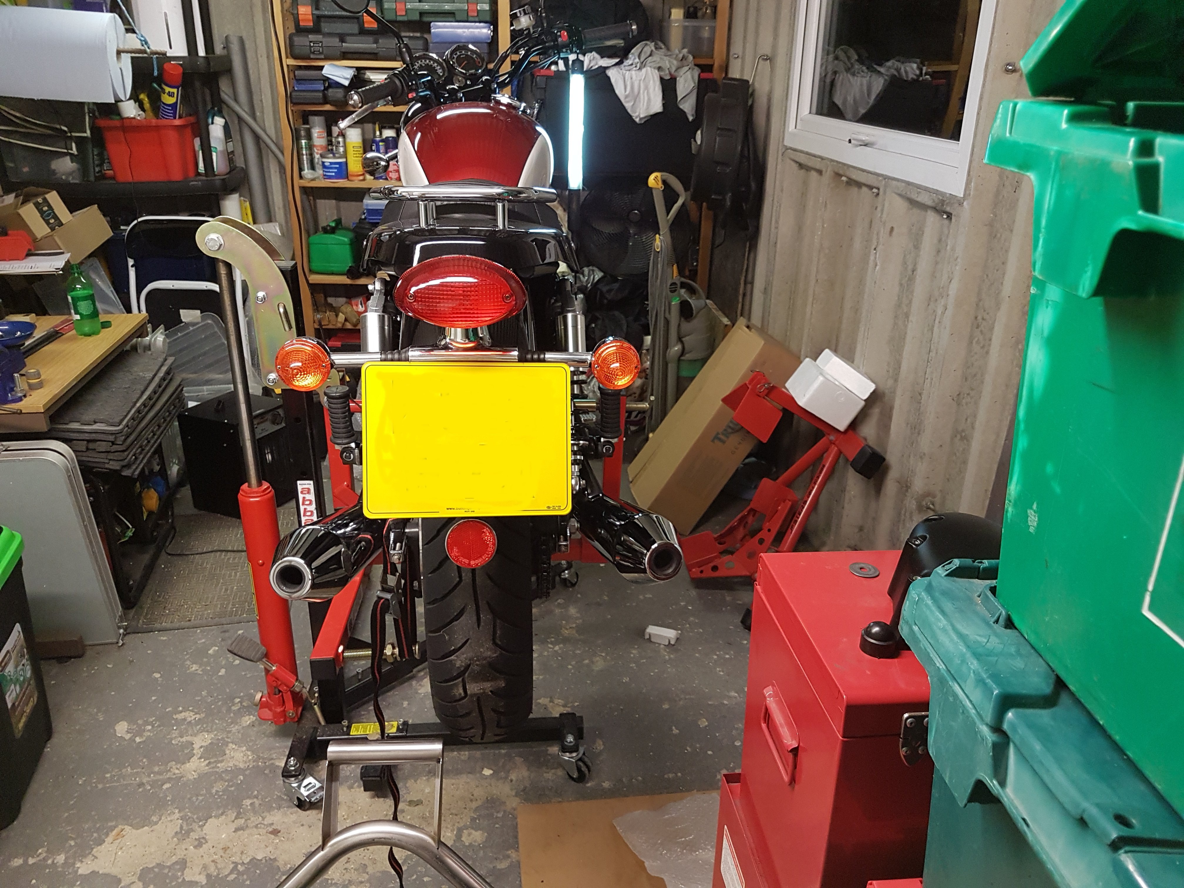

    Next was the single seat and rack

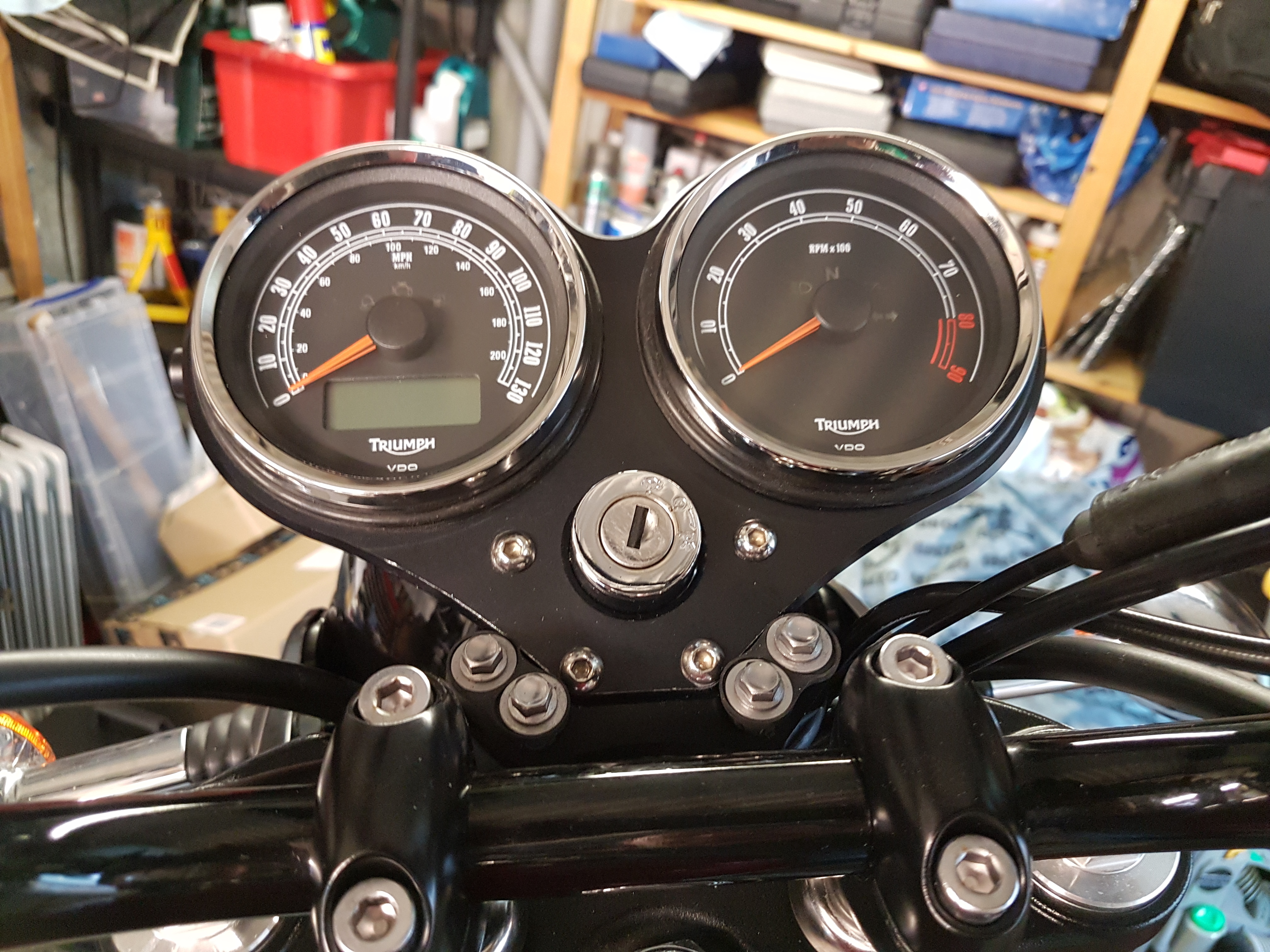

    then add the rev counter and relocate the ignition switch to a more useful place.
    Fairly straight forward although the wiring was a bit tight!

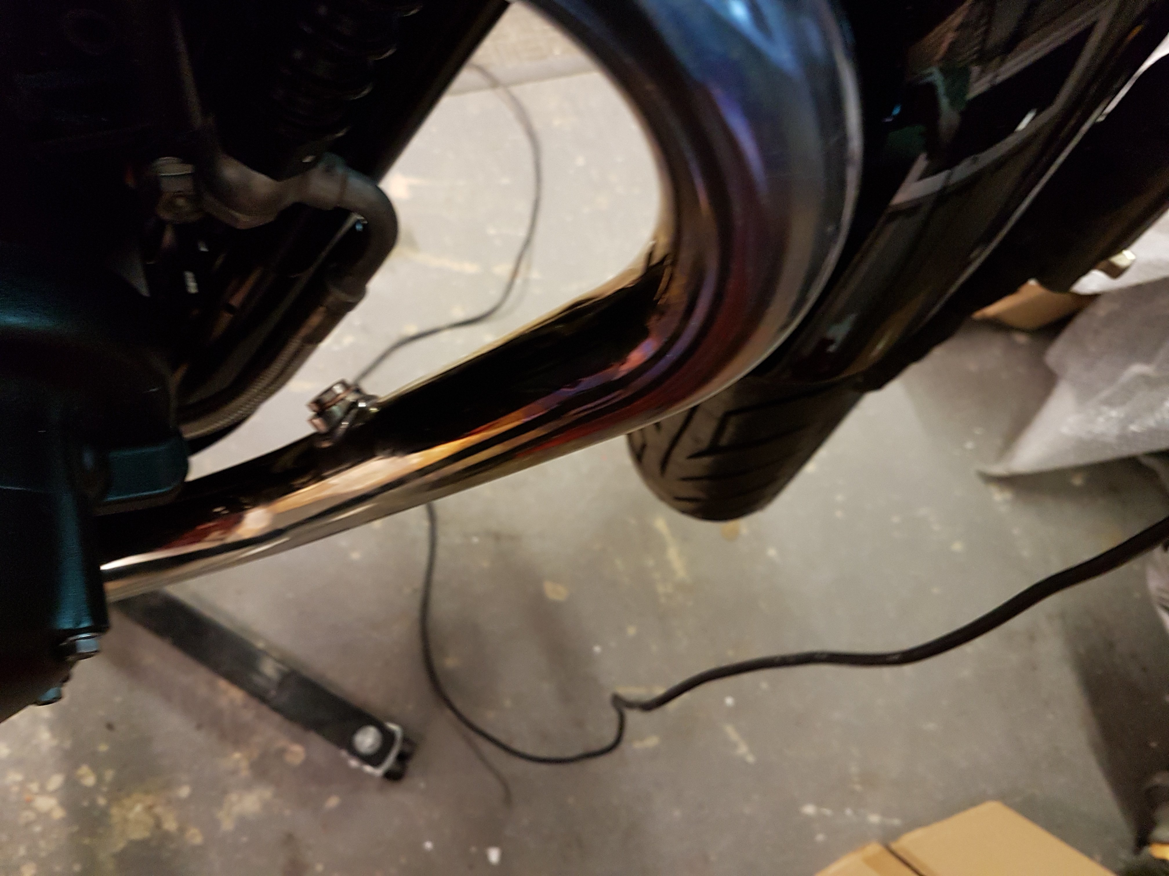

    Next remove the Arrow 2:1 and replace with std down pipes and TOR pipes.

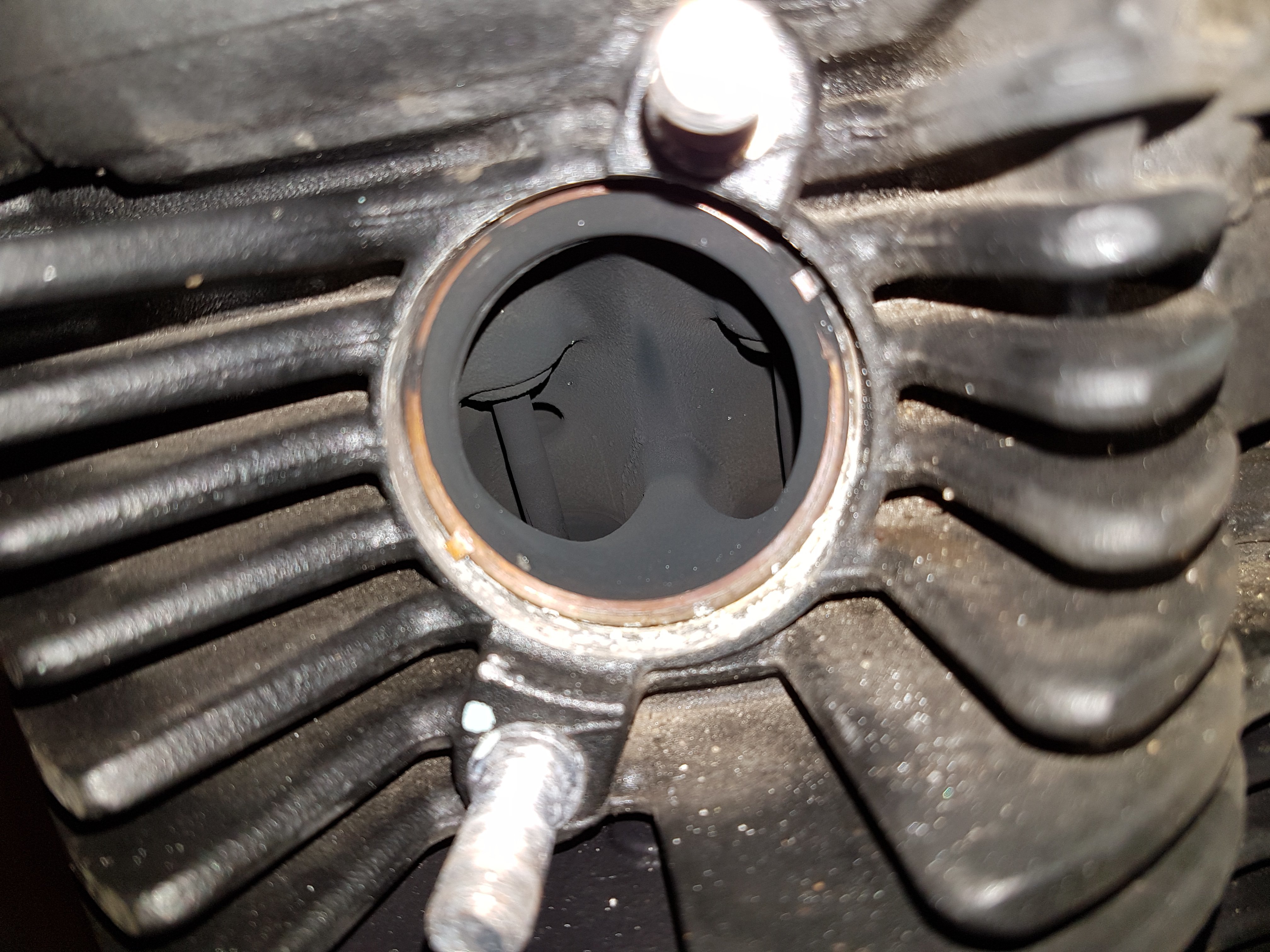

    While doing the pipes, a quick look at the exhaust ports would seem to indicate it's running a bit rich !

    While doing the downpipes, it seemed like a good time to do the CO2 removal kit.
    Bung fitted and resistors plugged in.

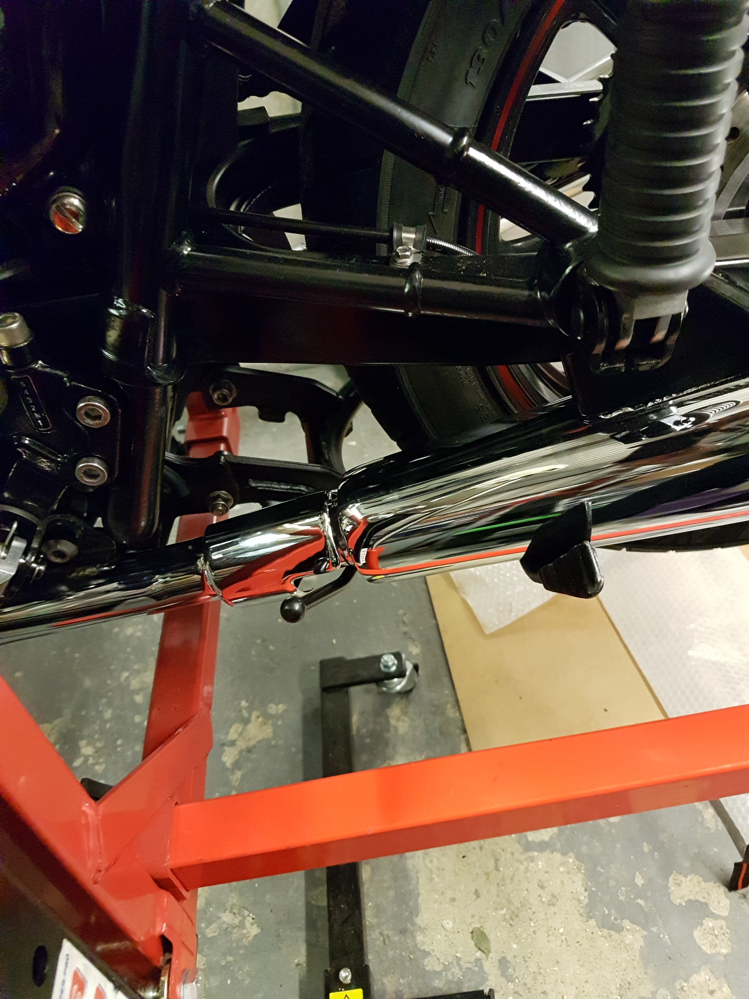

    I also thought it was a good time to fit the centre stand while the pipes were off.

    Got to pick up a spacer for the centre stand tomorrow and a new exhaust clamp as one of the original ones had a stripped thread.

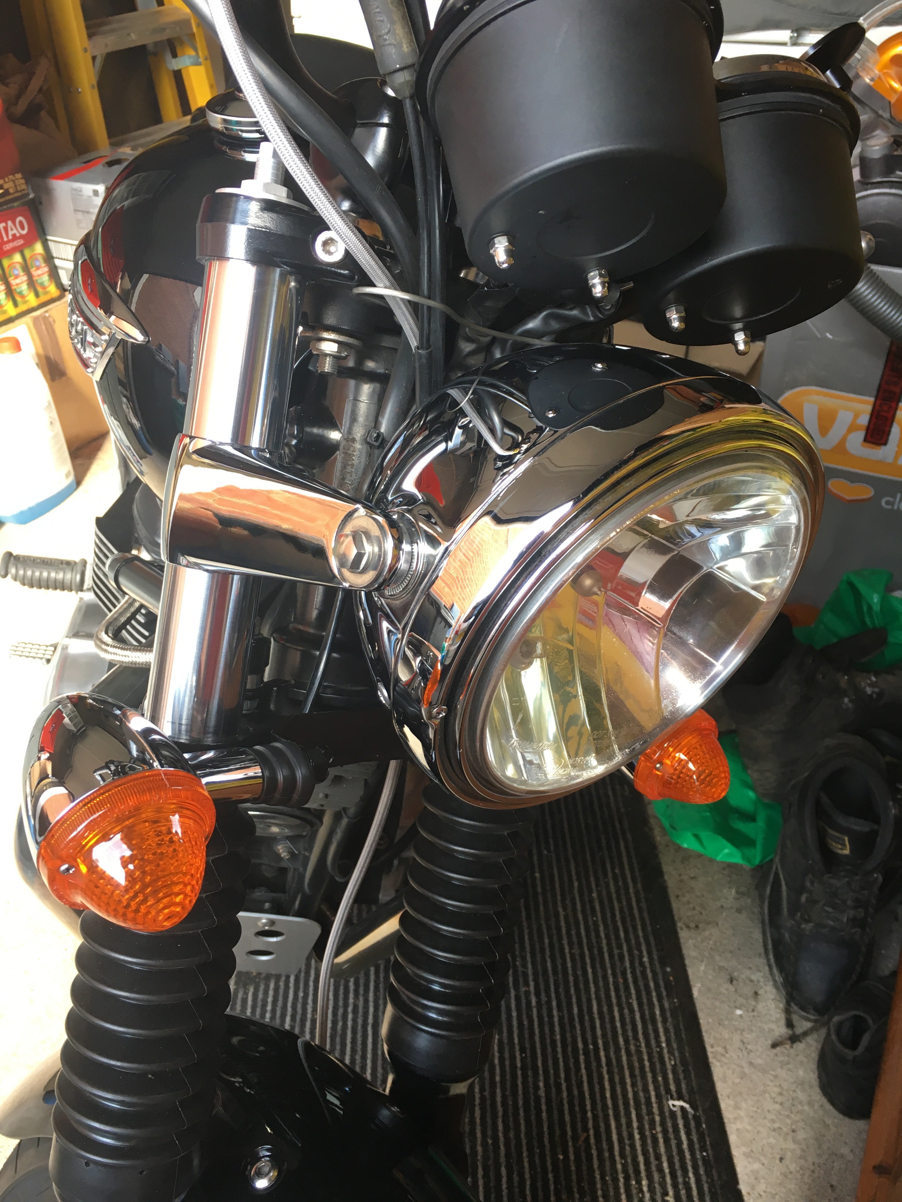

  12. tcbandituk
    Apr 8, 2016
    2,856
    Reading

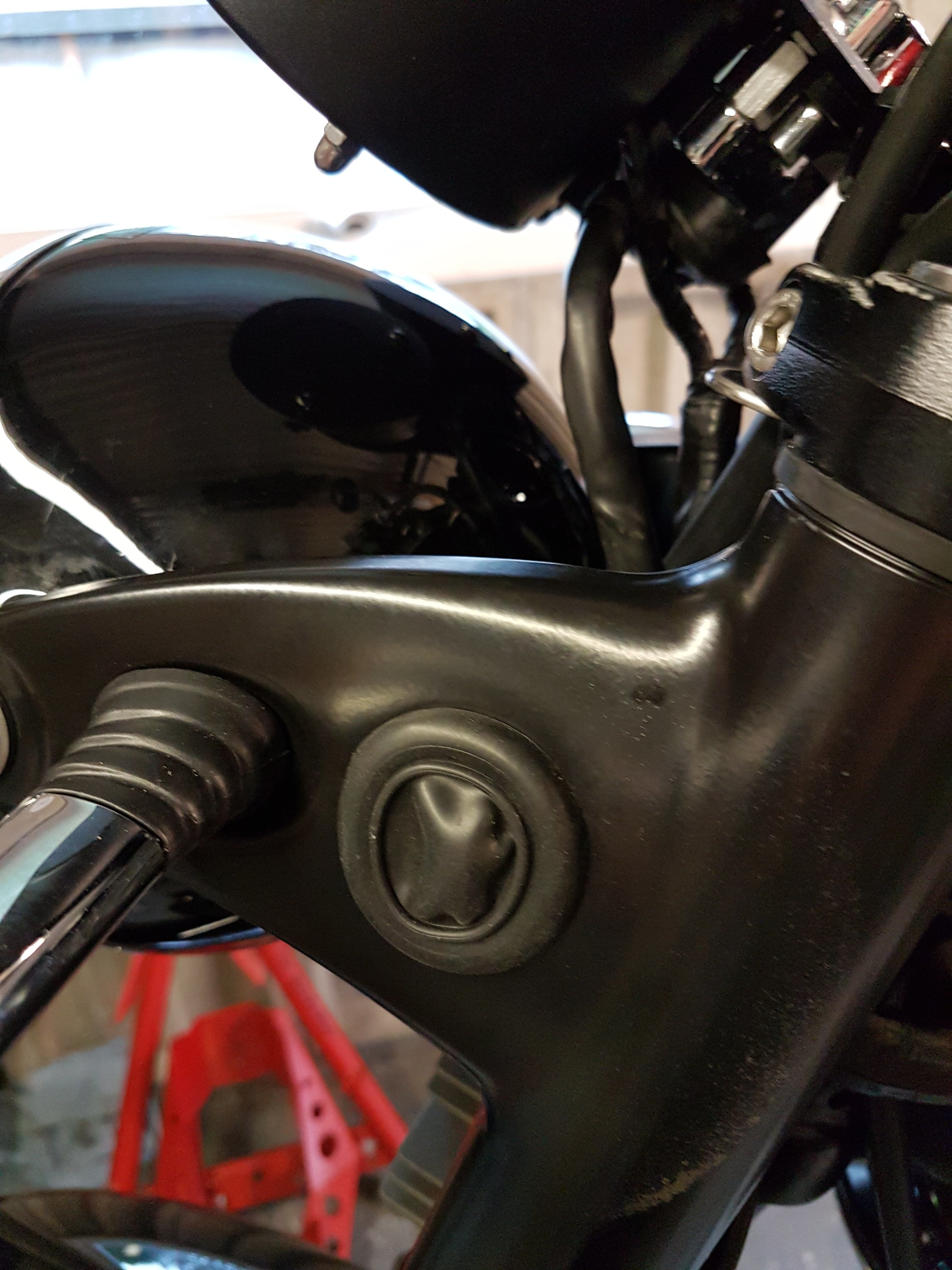

    One thing I'm not keen on and will change was the bung to cover the old ignition switch hole.
    It looks like a flipping condom or sommat! : unamused:

  14. Tigcraft
    2,622
    It’s coming together!!

    Looking good, very interesting to follow, you're right, that bung monstrosity just has to go!

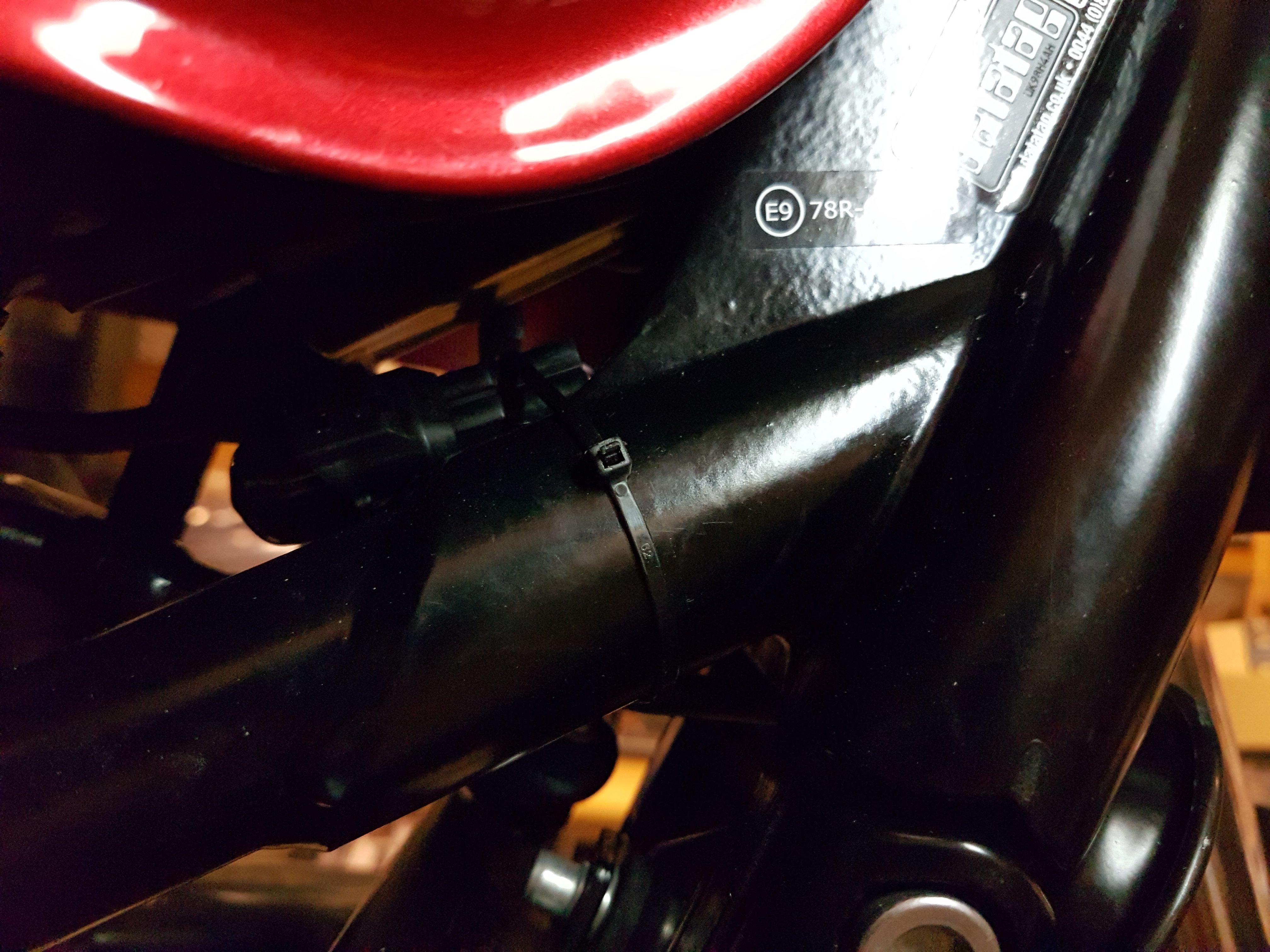

    Wiring tight? When I shifted the voltage regulator to the frame the wiring was so tight I removed the block connector from inside the headlight shell and rerouted it externally. I ' shrink wrapped ' the block connector in a length of bike inner tube which is a really tight fit and cable tied the ends of the tube to the wiring to be as water tight as possible.
    Keep posting the pics, really enjoying this one, not sure how much more work you have in the pipeline though?
    Curly

    The previous owner had obviously had something that flapped on the ignition key, there's a mark on the headlight mount on that side, so I was going to look at alternative shrouds.
    I did get a relocation bracket and a set of smaller front indicators in the box of bits that came with the bike.
    I'll probably go for some that are black still as, other than the tank, most of the bike is black.
    I also need to find some rear indicators to match what will be the new front ones.

    I ended up having to reroute the clock cables outside the guide bracket and even then they were tight, but it was worth it.
    I found the headlight mounted ignition a pain on the other half's Bonnie....
    I still have a few things to look at and do :p
