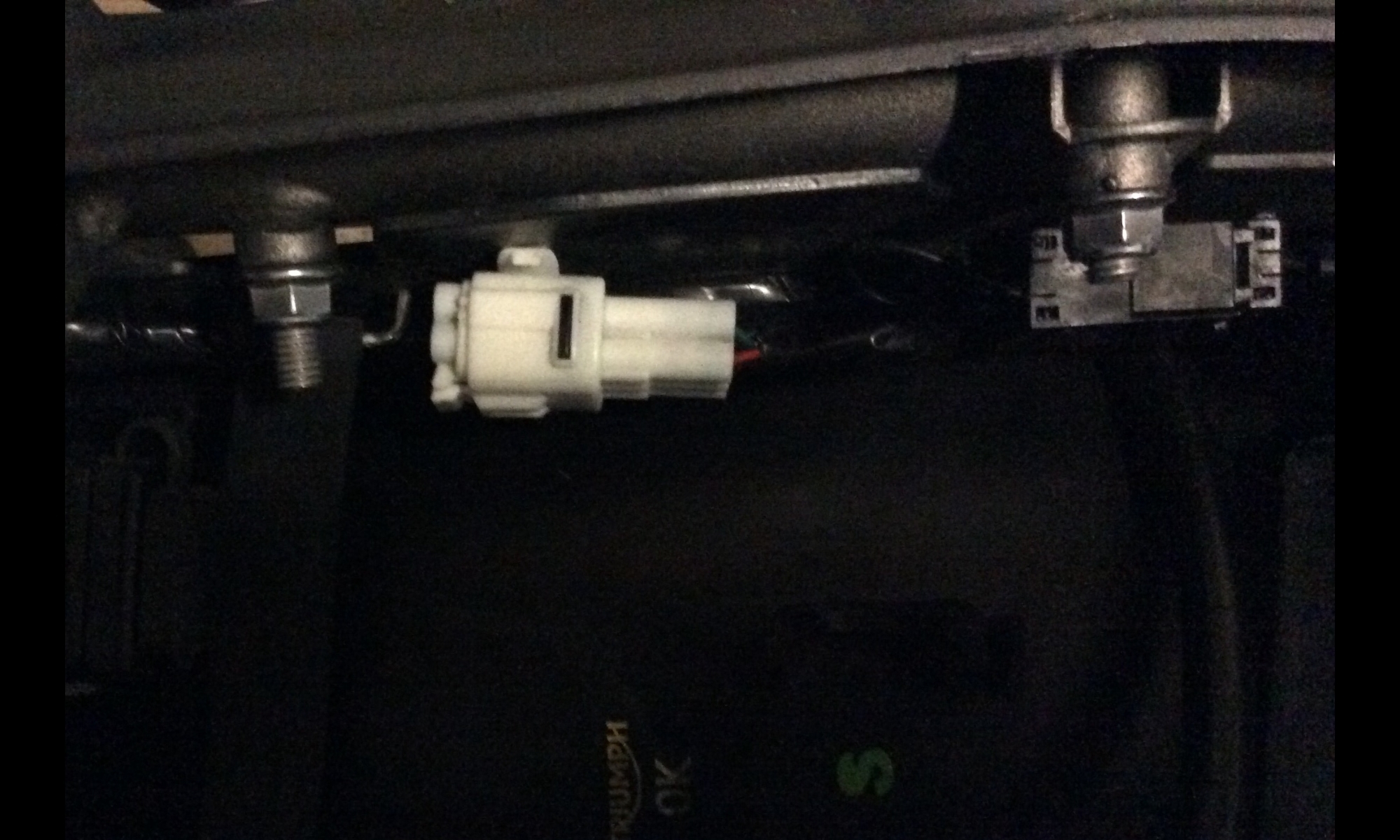

    With regards to your search for a switch live do you have a white plug which is on the left hand side of the bike,it's clipped to the plastic tray under the riders seat.
    Like this(sorry about picture quality) If so does it have 5 coloured wires going in. How many going out?

    Ray, if you've got a white plastic connector as in my picture you'll not need to go digging to find it. OK it's smallish but fairly obvious,,,,once you see it.
    I think your original wiring problem is you hooked up to a canbus.
