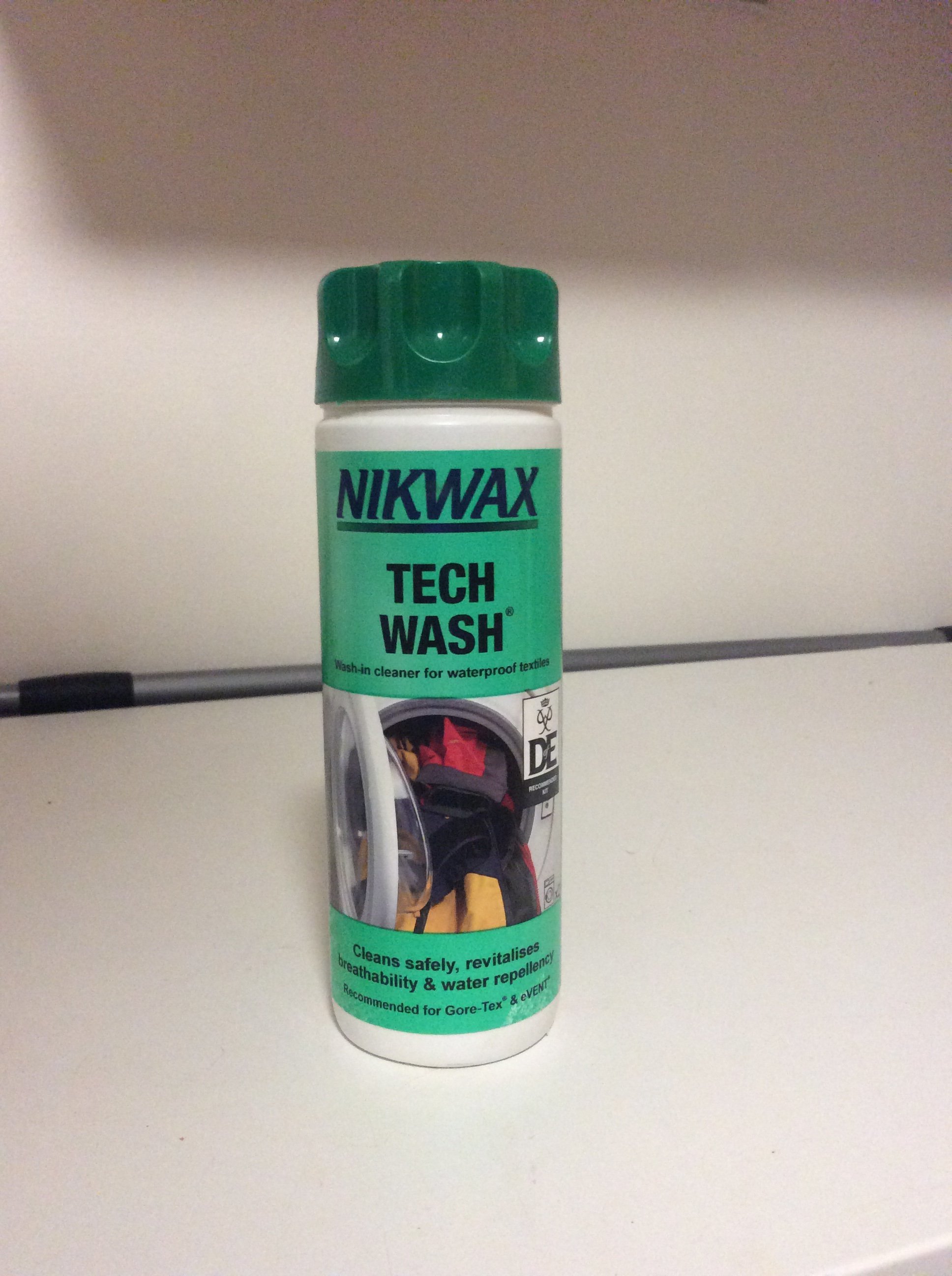

I am going to wash my Bulson textile jacket using Techwash and there are no washing instructions on the jacket. I have taken out the body armour and removed the zip in membrane am I okay washing the two together? I know you have to thoroughly wash out the fabric conditioner from the tray prior to washing the jacket then leave it to dry naturally. Advice appreciated guys. Regards, Pete.

Speaking on behalf of my wife who delegates all the sh***y jobs to me...... This stuff? Hein Gericke texttile jacket Armour out, thermal liner out and everything opened up. Into the washing machine as per instructions and a clean, re-proofed jacket emerges. Good stuff and worked as advertised for me.
That's the stuff I'm going to use, I've taken out the body armour and the waterproof membrane (I've never had the thermal liner in the jacket its too warm) so there's just the two items to wash. Excuse my ignorance but you do wash the waterproof membrane I presume?
Hi Pete wash the suit as directed with the Tech wash,then use Nikwax TX Direct as instructions we have used these products for many years on Hein Gericke suits which must be 10yrs old and still waterproof
