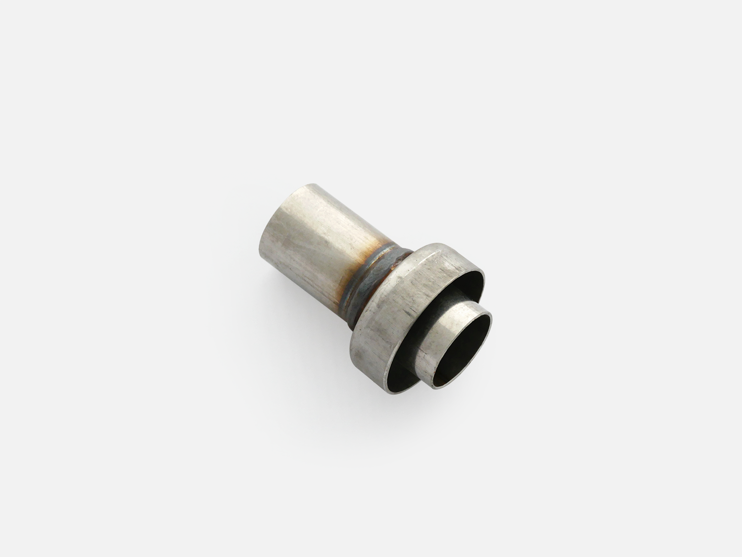

    I drilled extra holes then cut it down to about 3” long, didn’t seem to make much difference, problem with no baffle at all it sounds a bit like a Nissan micra with the header pipes missing. Although it’s meant to sound better to those following, so I’m told.

    Short video of the exhaust with TEC hi-flow performance baffle.
