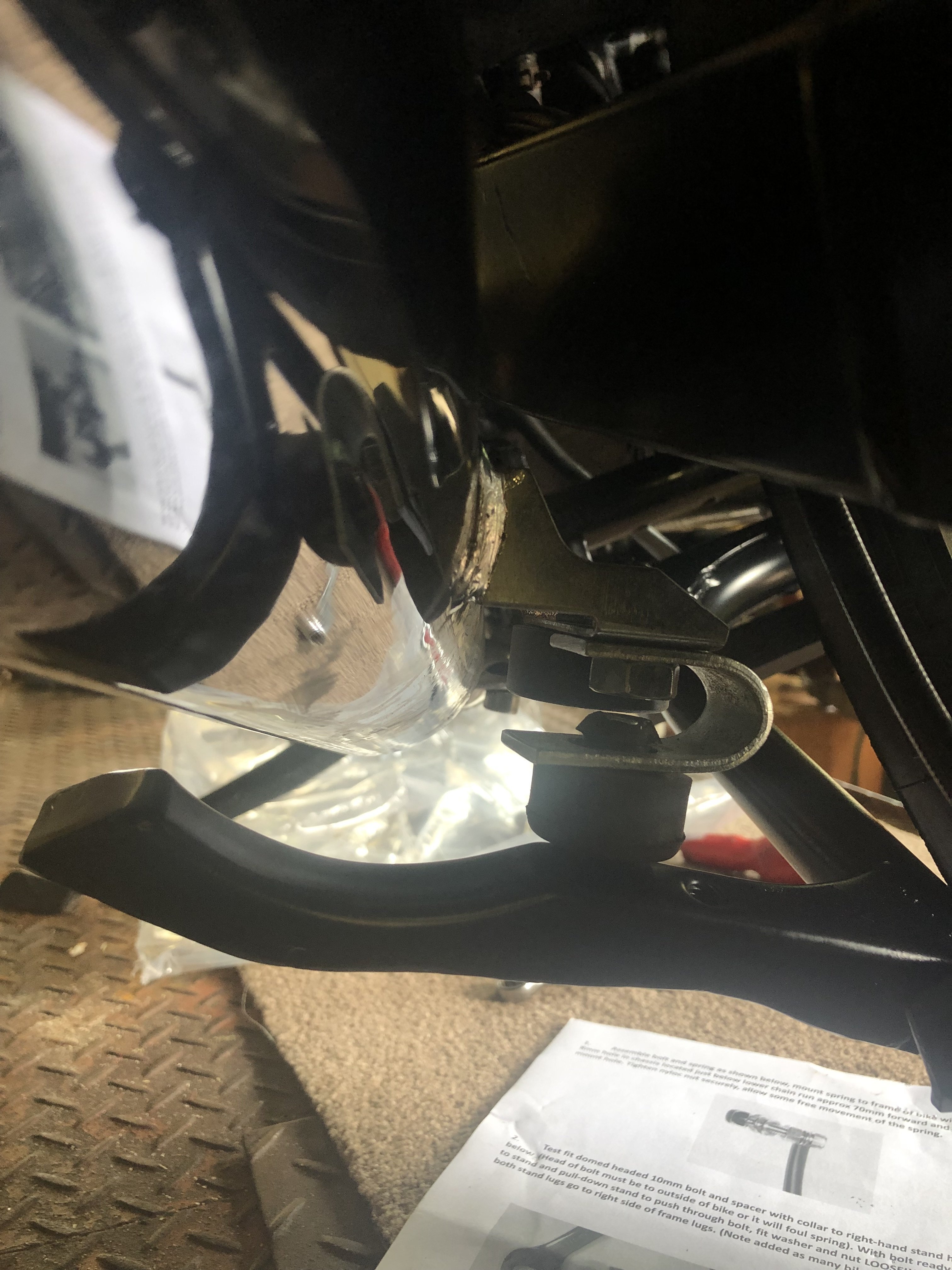

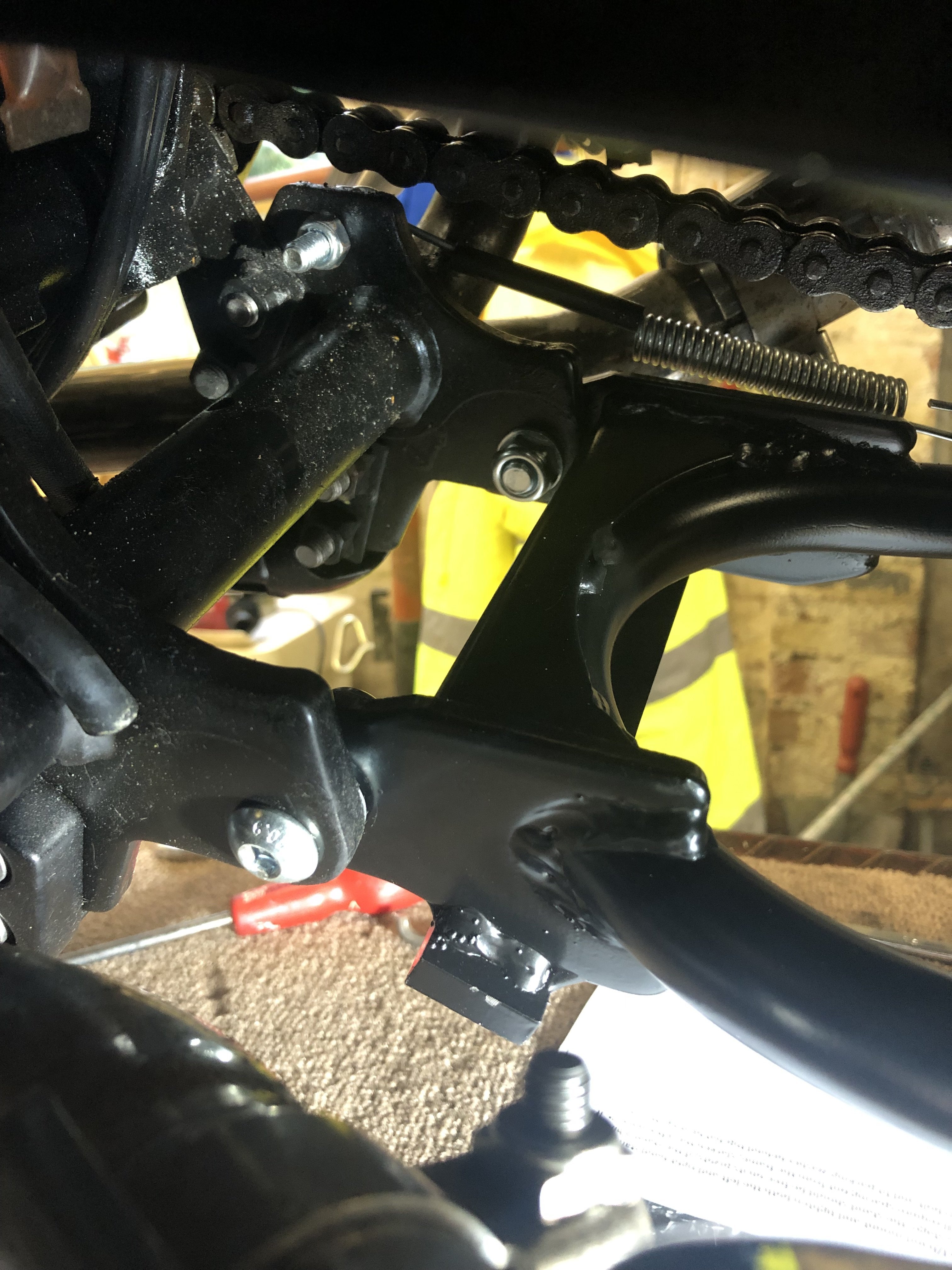

    Hi, just fitted a TEC stand to my 2014 Thruxton, easy enough to fit but the stop for the stand to prevent it hitting the silencer doesn't line up with the rubber?
    I have mailed TEC but they are not responding, anyone here fitted the same? See photo below, its as if the stand is too far to the right. The instructions say that the stand lugs are to be to the right of the frame lugs, which they are (next photo). The instructions also say that the gap between stand and tyre is different on each side... which it is.

    To update, got a message from TEC today appologising for the delay in response, they have had a few staff sickess issues which i can relate to as I also deal with customers that expect imediate responses etc....
    So apparently the exhausts changed at some point so there is a bracket I need for the exhaust / rubber stop which they are sending out....
    As for the stand, looks well built and the finish looks good as well. Putting the bike up onto the stand is a bit of a heave but I tried rolling the back wheel onto a piece of 1/2" thick wood and "hey presto" easy peezy :)

    I was going to say, I'd just weld a tab onto the top of the stop bolt, job done!

    I ended up making a bracket to hold the rubber stop, just removed the bolt altogether. Will see what the bracket is like that TEC is sending....
