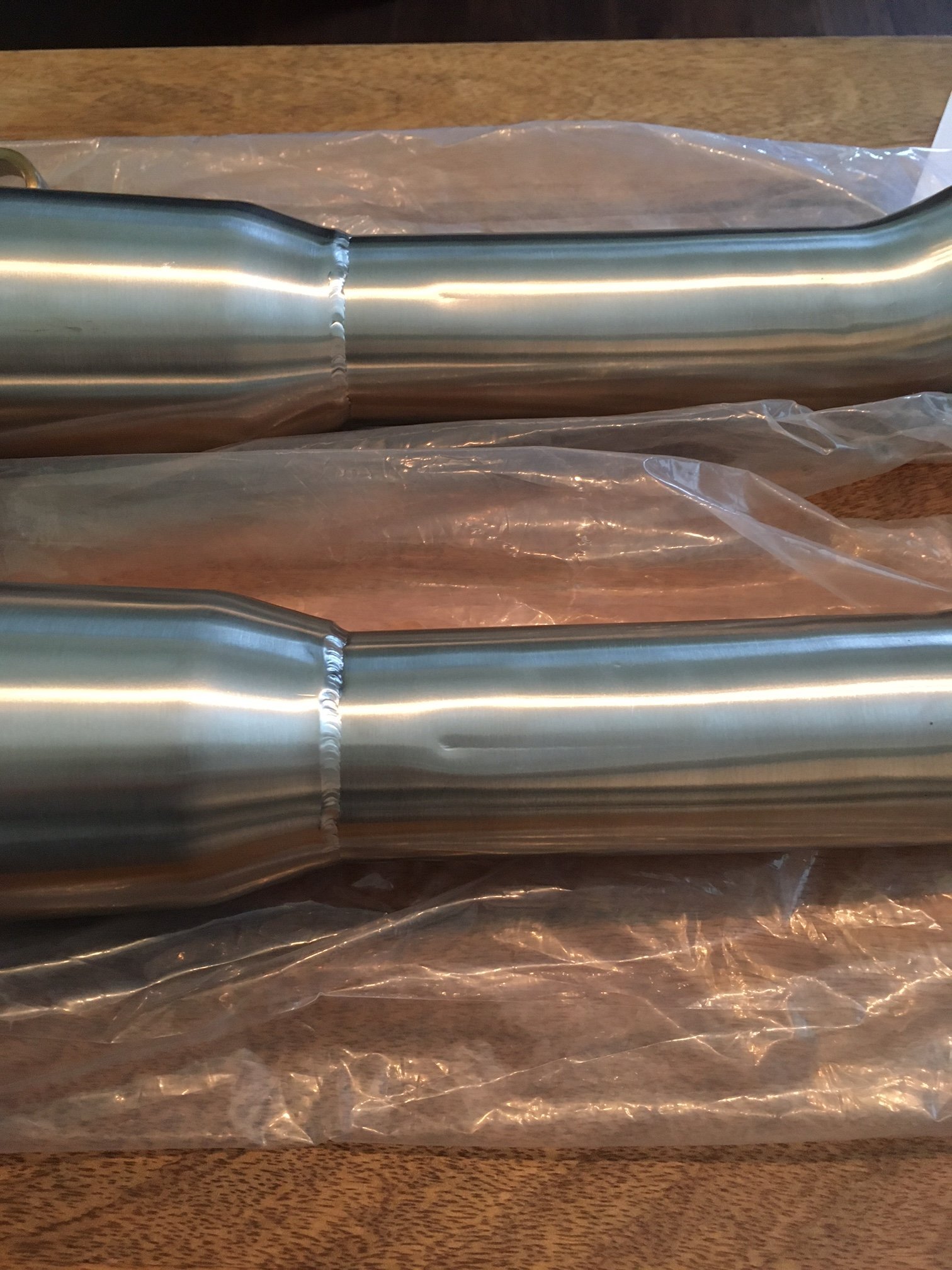

    so I bought the rebel exhust system knowing about tecs quality control problems, and they diddnt disapoint, the tailpipe section welded to the muffler was dented on both sides like it was clamped in a vise when welded, I tried to contact them by e mail and phone with no response till my cc company got involved and stoped payment on the card, then they miraculasly got back to me, asking what was wrong and saying they never got my e mails, so I re-sent the pics and they agreed to send a new part, whitch they did, but its dented in the same way the first pipe was, I sent them new pics and havent heard back yet, I know its a 400 $ system, but it still shouldnt be dented, im going to give them anouther chance to send an undented part, then decide weather to spend the big bucks on a quality brand or install it and keep the other muffler as a spare, I hope the fitment isnt as frustrating as the purchase

    yea I wouldnt use their shocks but my bike is a 22 street twin and I just wanted to get rid of that cat and giant exhaust system,I like the bike and the way it runs and sounds, hopefully I still will when I get done messing with it, as they say you get what you pay for, tec did get back to me and called them manufacturing marks not dents, wich I agree with someone clamped it in something to tight, but ive never seen pipes dented like this

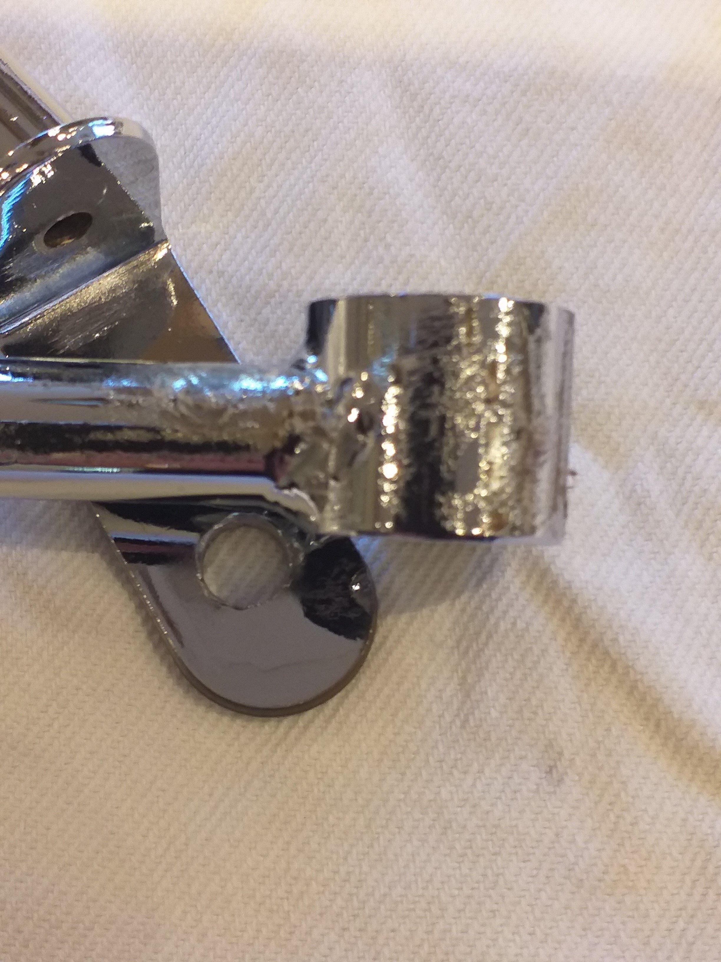

    Bought some TEC pannier rails. The plating literally came off in my hands. Their response was basically at this price point what did you expect? Ho hum.... 20230425_084606.jpg

    yea I bought the system knowing it wouldnt have the fit and finish of a system that cost 3 times as much, I just diddnt think it should be dented, and they did send me another muffler that was dented in the same manner, so I excepted their explanation that they werent dents they were manufactuing marks, and put the system on yesterday and it went on ok but like you said I had to modify all the springs and bend out the tabs to get the springs to stay on at all, I hope those springs arent holding that thing together, on its first ride I was waiting to hear it rattle apart, but it was fine, ran fine, louder under throttle but not to bad at idle, diddnt have any popping or backfireing, getting the factory system off was another story what a pia

    If the bends are pulled (yes pulled, look up how it works as it's quite fascinating) on a mandrel bender and someone sets up the backing runner piece wrongly then you can get those marks. Think of a piece of solid square probably aluminium say 200 mm long with a half round cut in one face along the length the radius of the finished pipe article. Those marks look like the end corners of the backing piece.
    It's only about 30 years since I used one :eek:
    A little more care could minimise, or avoid in the first place, those marks but yes I would agree they are manufacturing marks.

    thanks Eldon, that explains it very well, cant really see them on the bike, we'll see how they work out
