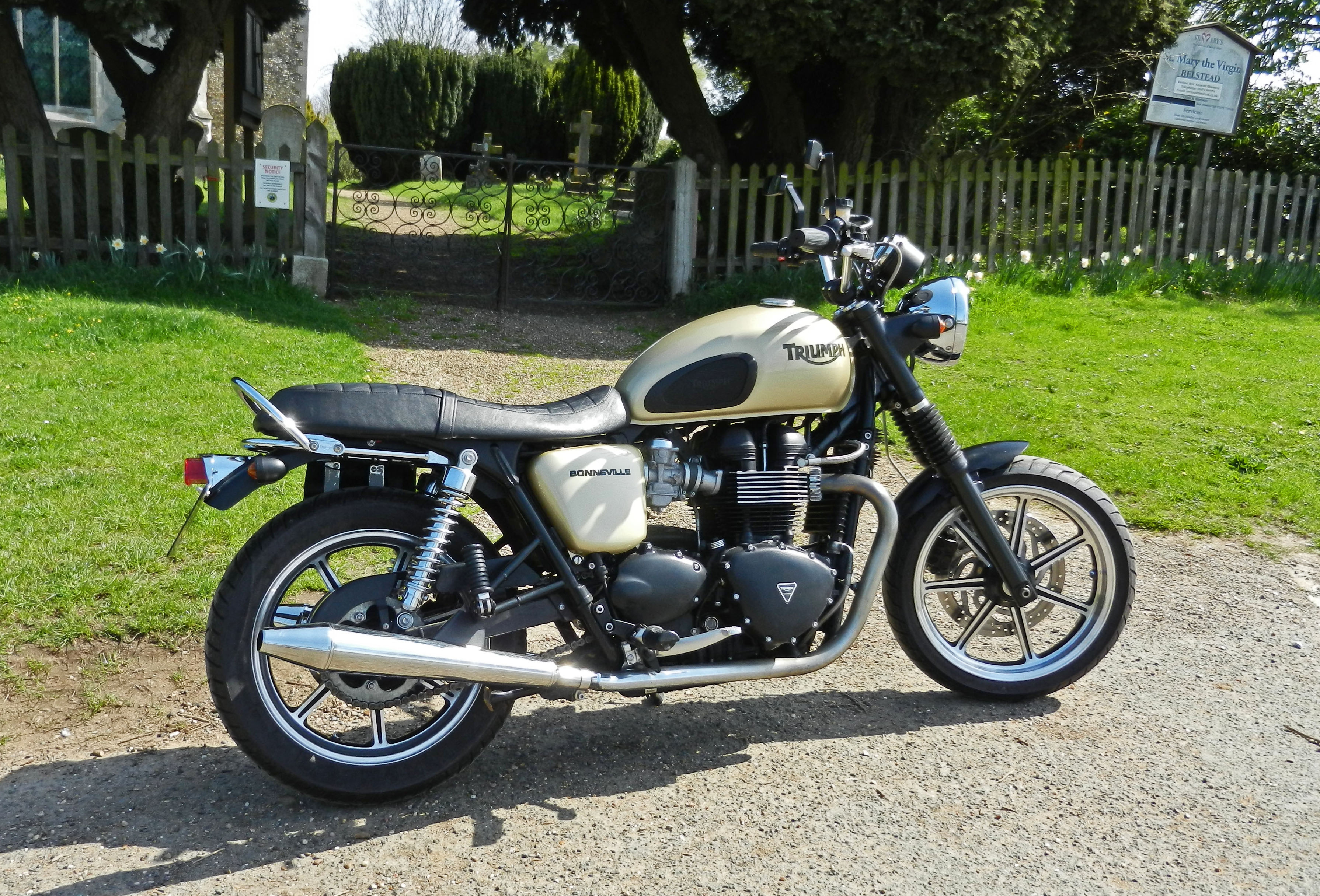

    I got the TEC Bikeparts tail tidy for my bonneville. It comes with LED rear light and plug and play wiring harness, and includes mounting for indicators and number plate bracket. Easy to fit - comes with instructions and all the fittings needed.

    Looks really great 0-) Does it keep all muck off the electrics if ride through winter? As there are add-ons that tidy up/replace the stock lights and indicators whilst retaining the mud guard? cheers Andy

    The electrics end up under the seat so are protected by the tidy itself. Had my seat off yesterday and all looks clean. Can't say the same for the back of your jacket though! :cool:

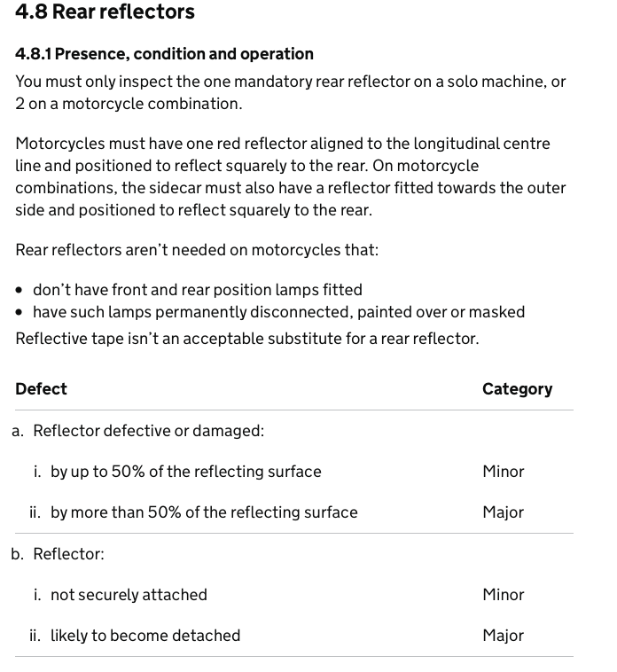

    Steve, the licence plate reflector is needed for MOT isn't it ?
    Did you buy yours on Square deals ?

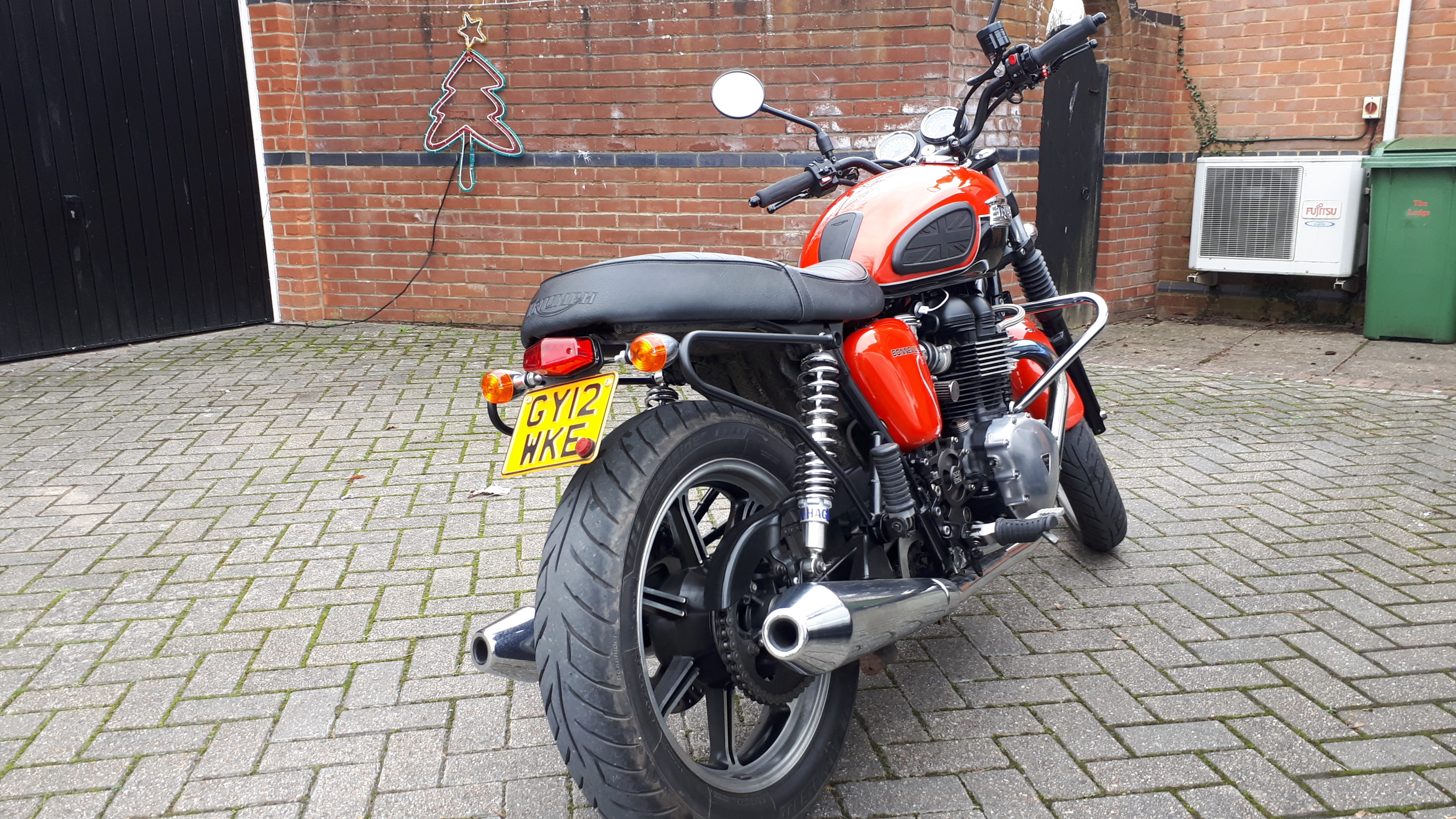

    I don't think the motone one does. Which is what I have just installed with my tail tidy.

    It has to be central now, if you have space on the bottom of your plate the little stick on circular ones are available on most bike, accessories shops. I got one of these and bolted a rectangular reflector to it

    Link doesn't work, but I think I know what you meant. I was told the reflect was needed and to be central for MOT indeed.

    Interesting, The MOT manual section 4.8 indicates that
    "Motorcycles must have one red reflector aligned to the longitudinal centre line and positioned to reflect squarely to the rear."
    but does not list the alignment of such reflector as a fail. Only if gets loose or possibly lost, or if it's damaged.

    My CX500 passed the MOT under the new rules with an off - centre stick on reflector, put on by the tester himself. To be fair, the bonneville passed last year without one at all but he did say i should put one on. :cool:
