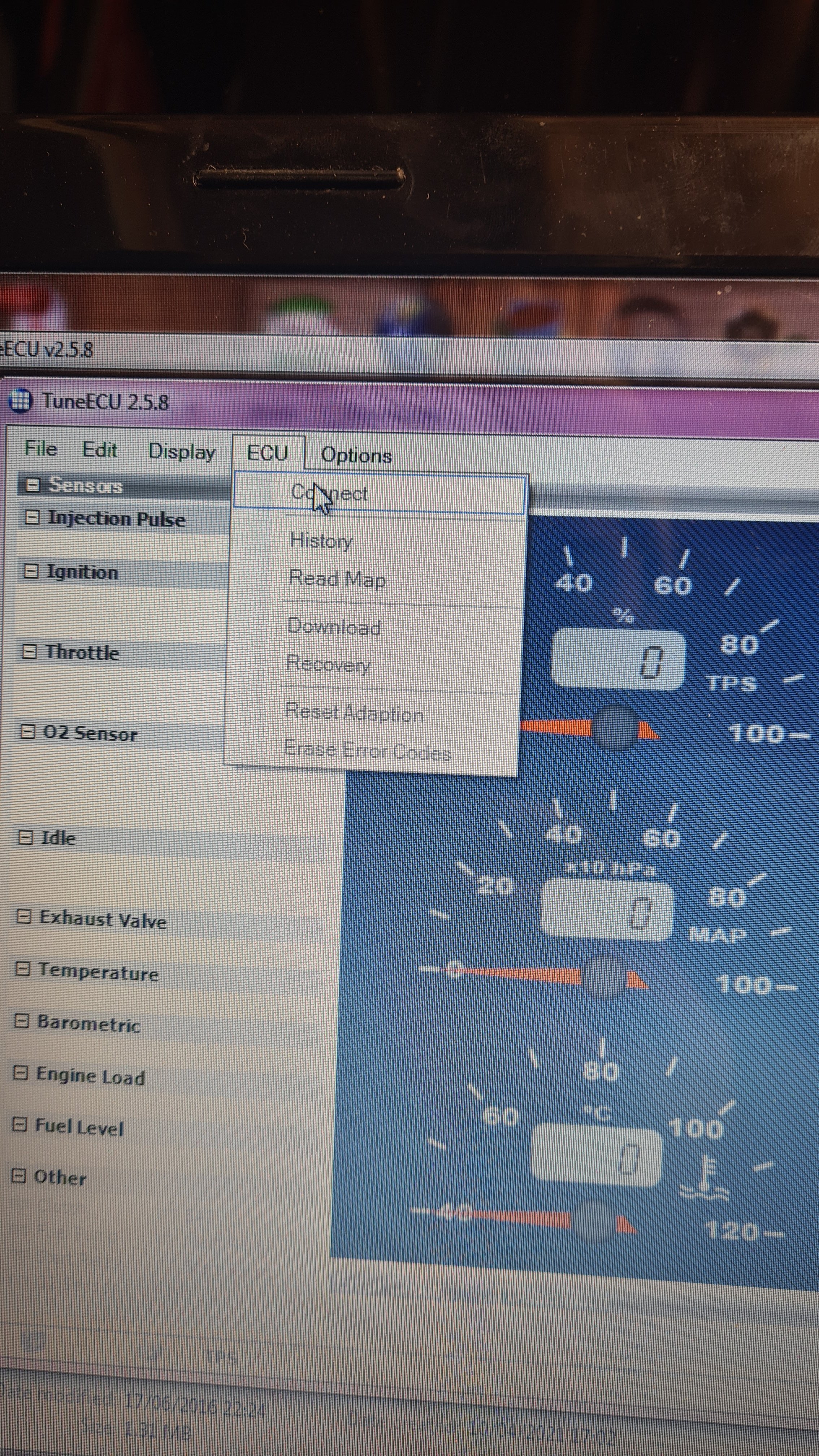

    Evening all,
    I have an engine warning light on the dash so bought myself an obd to USB plug.
    Loaded the tune ecu software onto the laptop, plugged in the bike and switched on the ignition, opened the tun ecu app and let it load/connect as the tune ecu page says but nothing so went to push connect and the button is not allowing me to push it.
    Got a wee light coming up on the obd of so figured that must be working, any ideas as to why it won't connect?
    Cheers in advance

    There are a few possible issues.
    What operating system windows ??
    Did you install the correct cable driver.
    If windows 7 it requires all the correct networks updates.
    It may need a map loaded into tuneecu of/for the correct engine.
