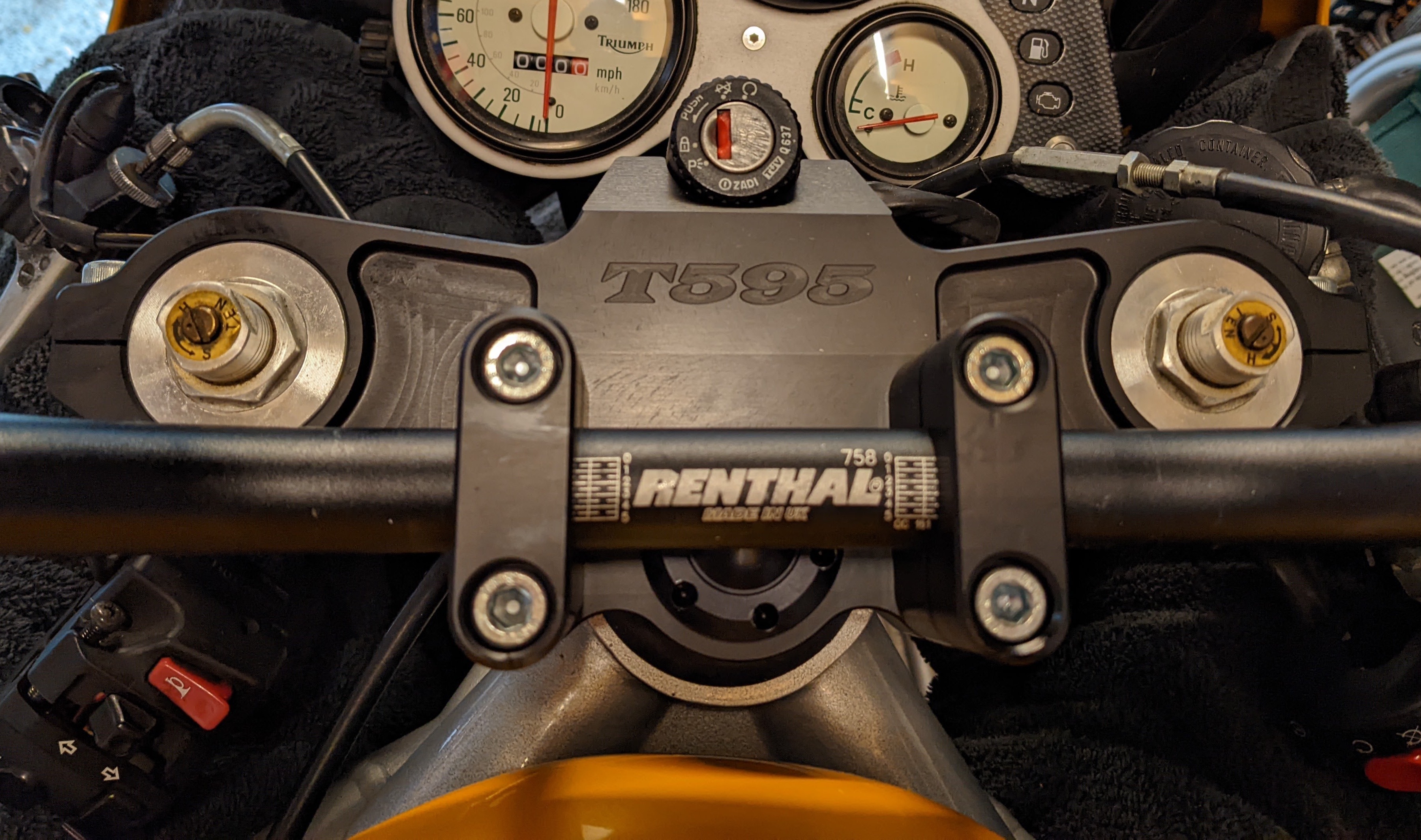

    At long last, I have now received my CNC Top Yokes kit exactly 1 month after my order was confirmed and paid for! Communication was pretty bad with them at first but they did keep me informed for the last week, only after lots of chasing.
    Anyhoo, here it is and I will post an update once fitted. o_O

    Wow, that took about an hour to fit and will now take several hours to re-route cables, fit new brake lines and mount the reservoir.
    The only unexpected snag so far is that the wiring for the left hand switch gear is about 4” short and their is no flexibility to extend. Is this a cut and graft job or is there another version for say a Street Triple that fits and is longer?
    I would appreciate any guidance you have. :)
  10. Geoff Butler
    Apr 5, 2021
    627
    143
    Hampshire & Powys
    #10 Geoff Butler, Dec 4, 2021
    I overcame most of the obstacles today and am pretty pleased with the results of my new CNC Top Yoke conversion.
    For anyone doing the same job and looking for tips, here are some of the idiosyncrasies I found with fitting a new top yoke for a higher handlebar position. It may seem obvious to some but don’t forget to protect your tank, clocks and fairing before starting (I use old towels).
    1. Removing the old T595 top yoke is straight forward but removing the 2 headless bolts for the ignition is tricky. I used a small drill and was then able to undo the bolts with some needle nose pliers. Keep the 2 offset washers for reassembly.
    2. Extended front brake lines are needed
    3. The Clutch and Throttle cables should reach with a bit of re-routing
    4. There is 2-3 inches more length available on each of the left and right switch gear harness. You just need to cut the small cable ties under the fairing behind the headlights (very fiddly!)
    5. I used Renthal 758 22mm bars and they just slightly nudge the fairing in left and right hand lock positions (this is a UK MOT failure by the way)
    6. The left and right switch gear will need the small lugs cut or filed smooth if you are using generic bars (such as Renthal) and not standard Triumph bars
    7. I made a small aluminium L shaped bracket for the brake reservoir because the old one no longer fits
    Thanks for looking.

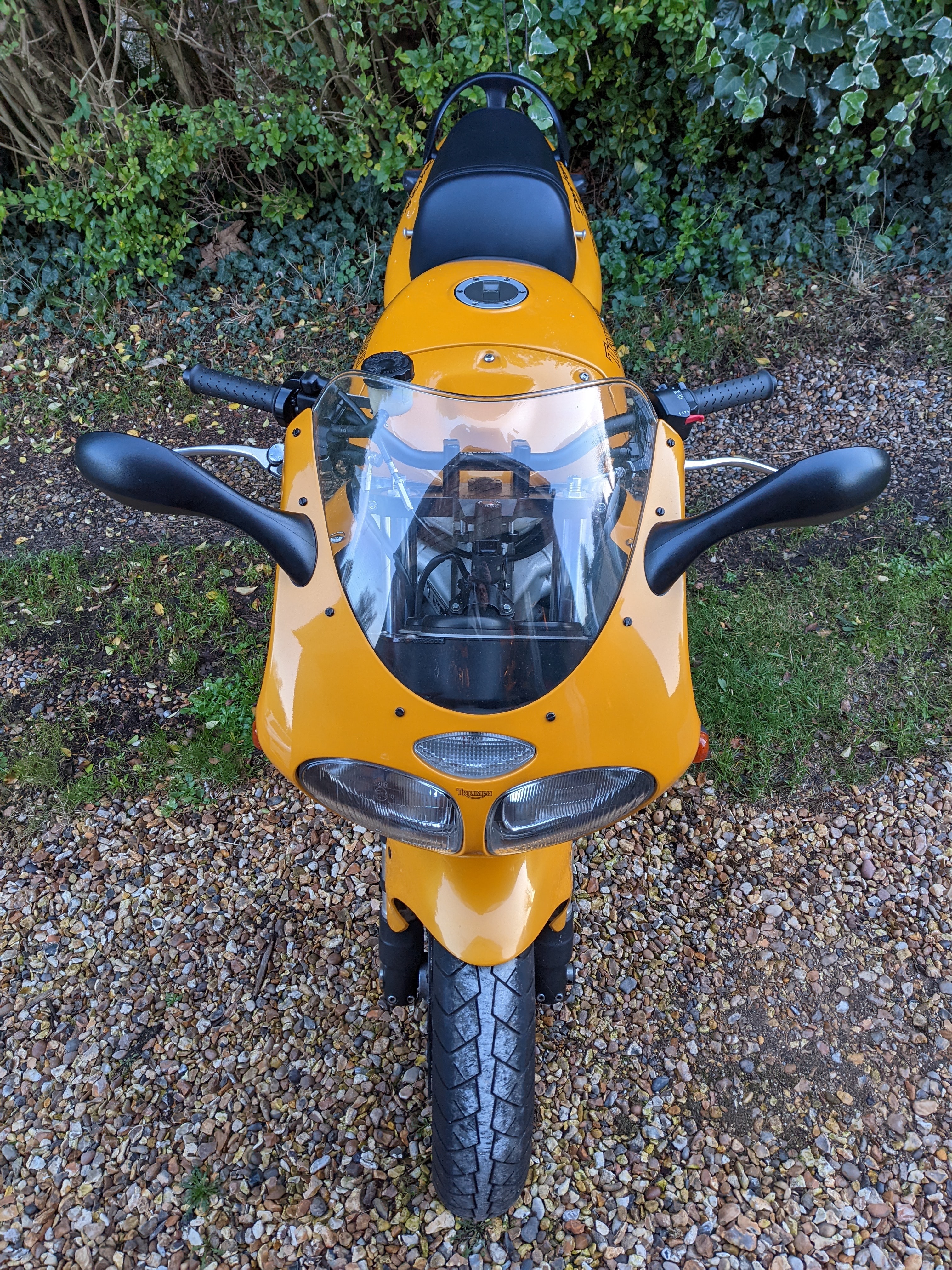

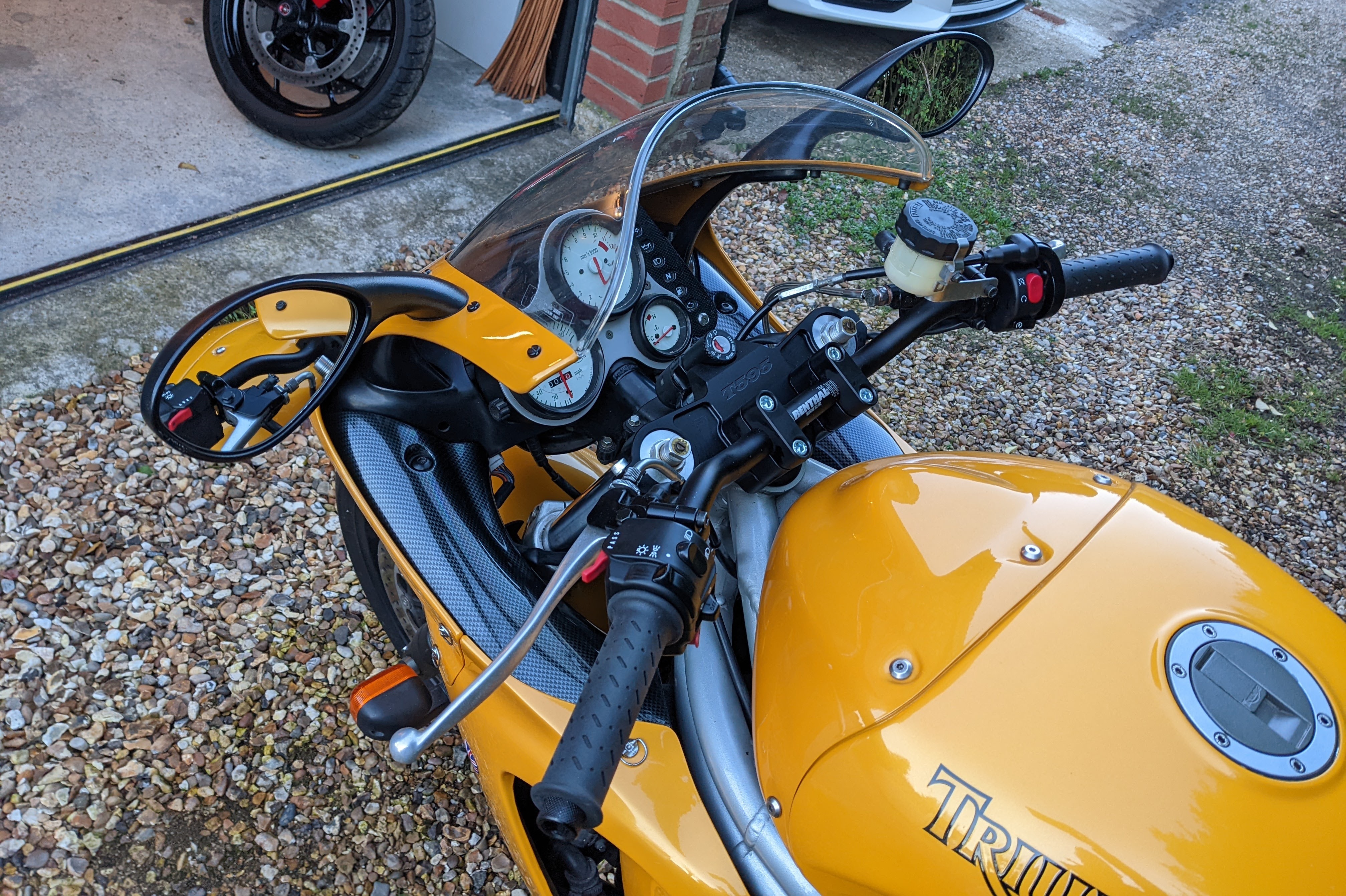

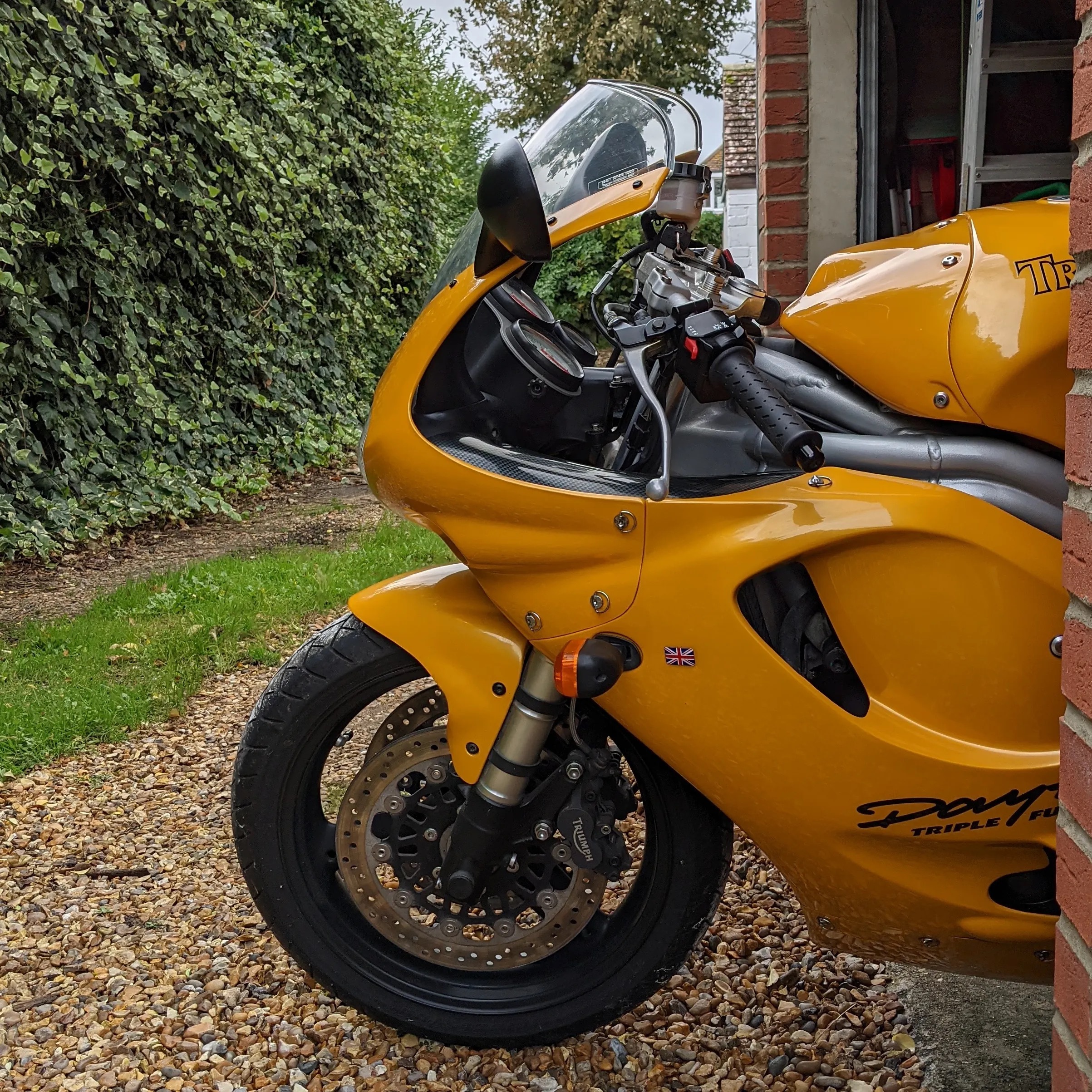

    By way of an update.
    I have since fitted Renthal 754 Road Low bars that sweep back a bit more and miss the fairing, so no more steering lock limitations or MOT failure.
