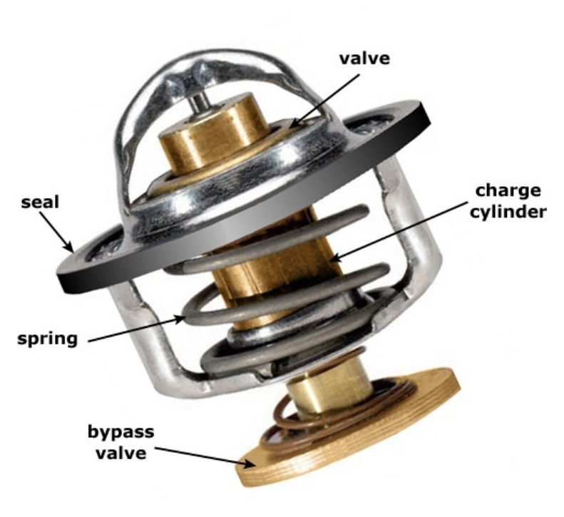

    A) should I assume my thermostat is finished if the centre pin pulls free of the thermostat and remains in the housing, as per the photos?
    B) How can you check a thermostat of this type, because presumably it requires the housing to press against, not having the ‘metal frame’ around it?
    C) How does it work...surely the spring expands when the temperature increases, but this would surely be opposite to the desired effect.

    I’m not familiar with that style of thermostat Stuart but I’m wondering if the pin is just to centrally locate it in the housing? Does the pin come out? It does look a bit “used” and if it was me I’d change it if I had any doubts about it. I’m sure you probably think the same.

    I am thinking down the line of replacement, but would love to check it out first if it’s possible to do that outside of the housing?

    Does anyone know if I should at least see something moving when brought to the boil, even with it being outside the housing?
    Namely should the charge cylinder still push out the ‘inner cylinder,’ even though it doesn’t have the the metal ‘shroud’ around it to push against?

    Found it! The Triumph thermostat test! Thanks Sprinter...found it after watching your link on YouTube.

    Having said that...upon second watching, the thermostat has behaved the reverse of what I was expecting...it looks as though this action would actually CLOSE the flow, NOT open it? :worried:

    Perhaps it closes the main flow to direct through the rad.

    Good logic, I’ll check that out!
