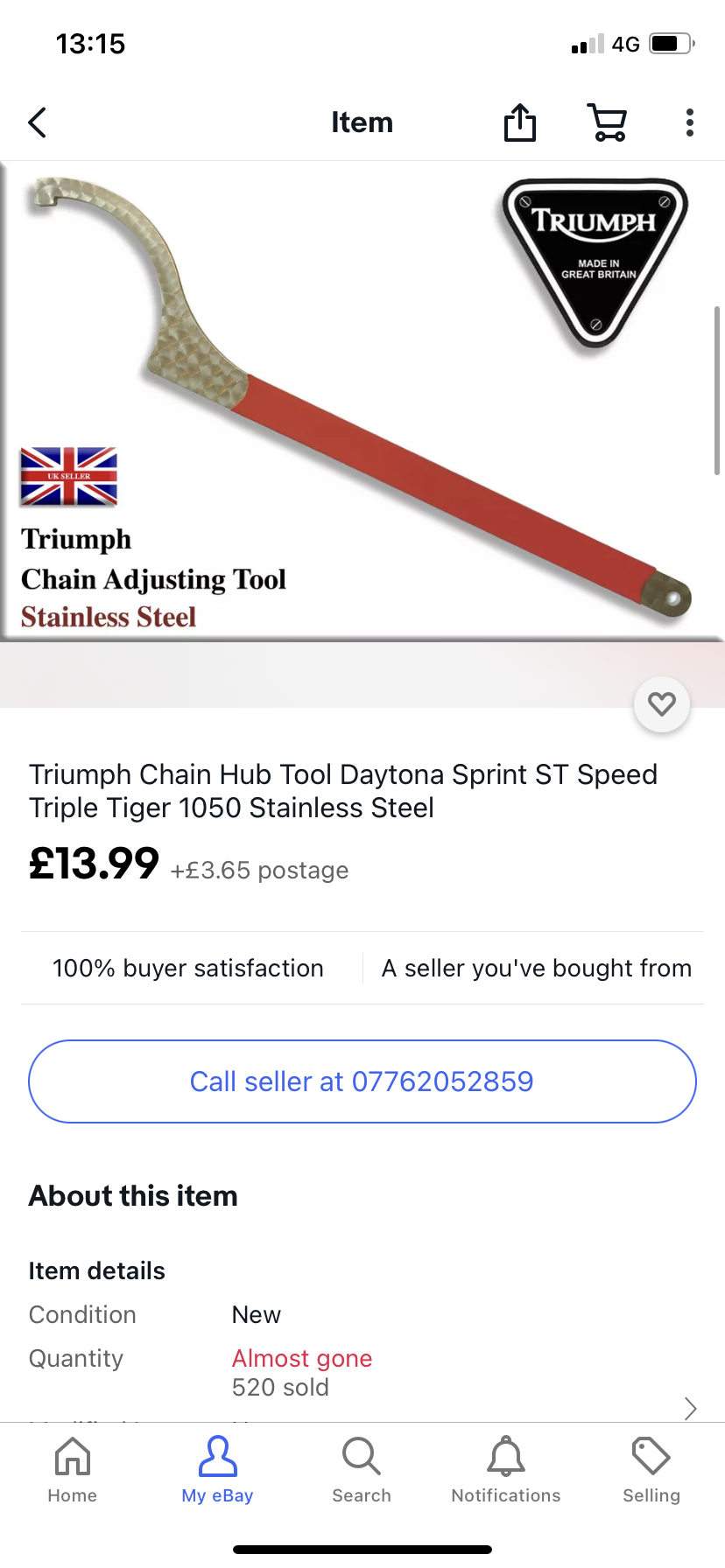

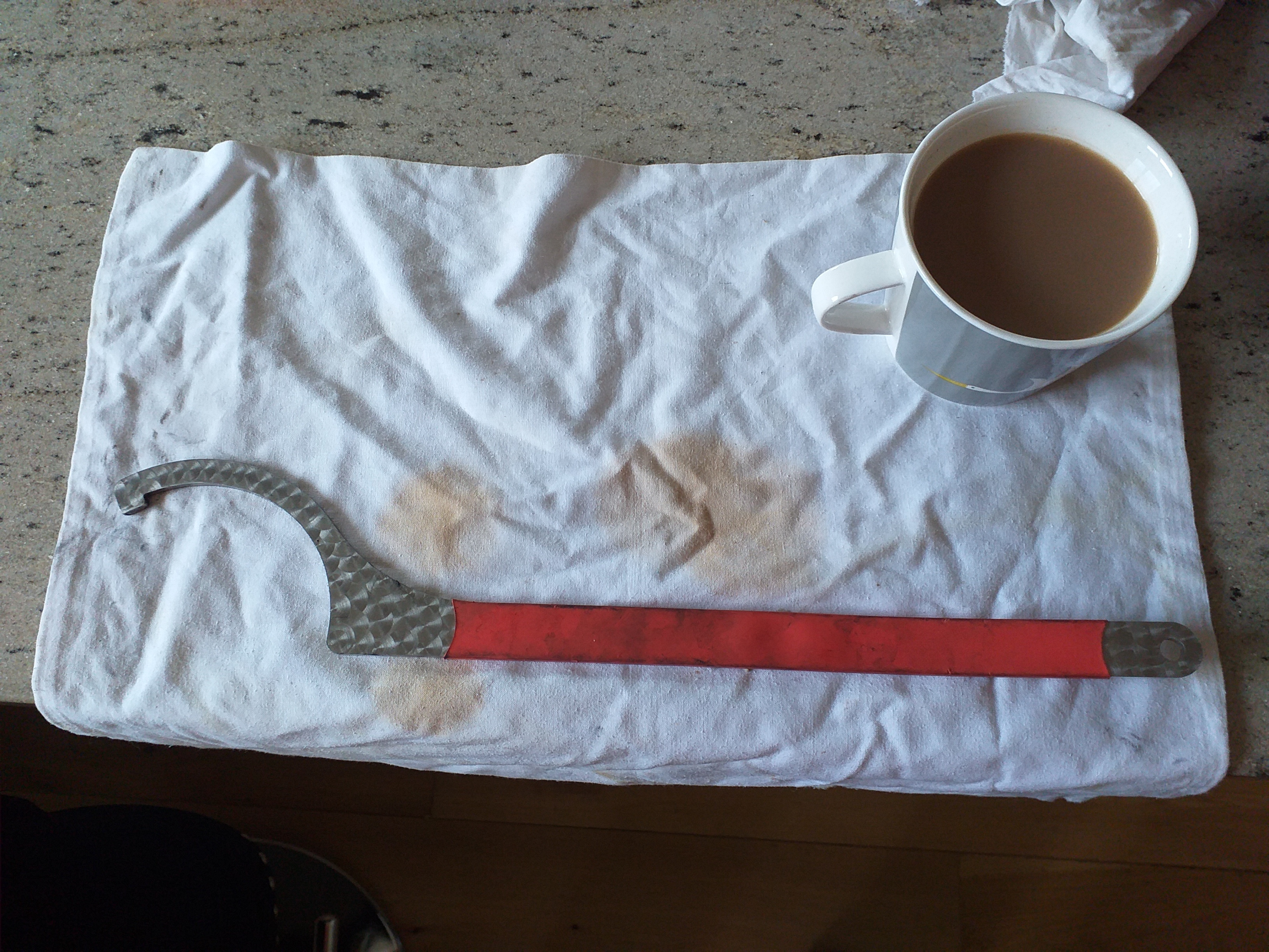

    Lots of Plusgas around it, remove the pinch bolt which secures it. I bought an extra long adjuster C spanner off Ebay*, and ideally get someone to use a suitable lever to try and prise the faces of the clamp a little bit, to release some pressure. Then try to work it with the C spanner. Otherwise, teardown :confused:
    *lt was a chap in Yorks somewhere, laser cuts them. Forgotten his details though. Sorry

    Bought one myself :)
    His telephone number is here...or you could search the title on eBay.
