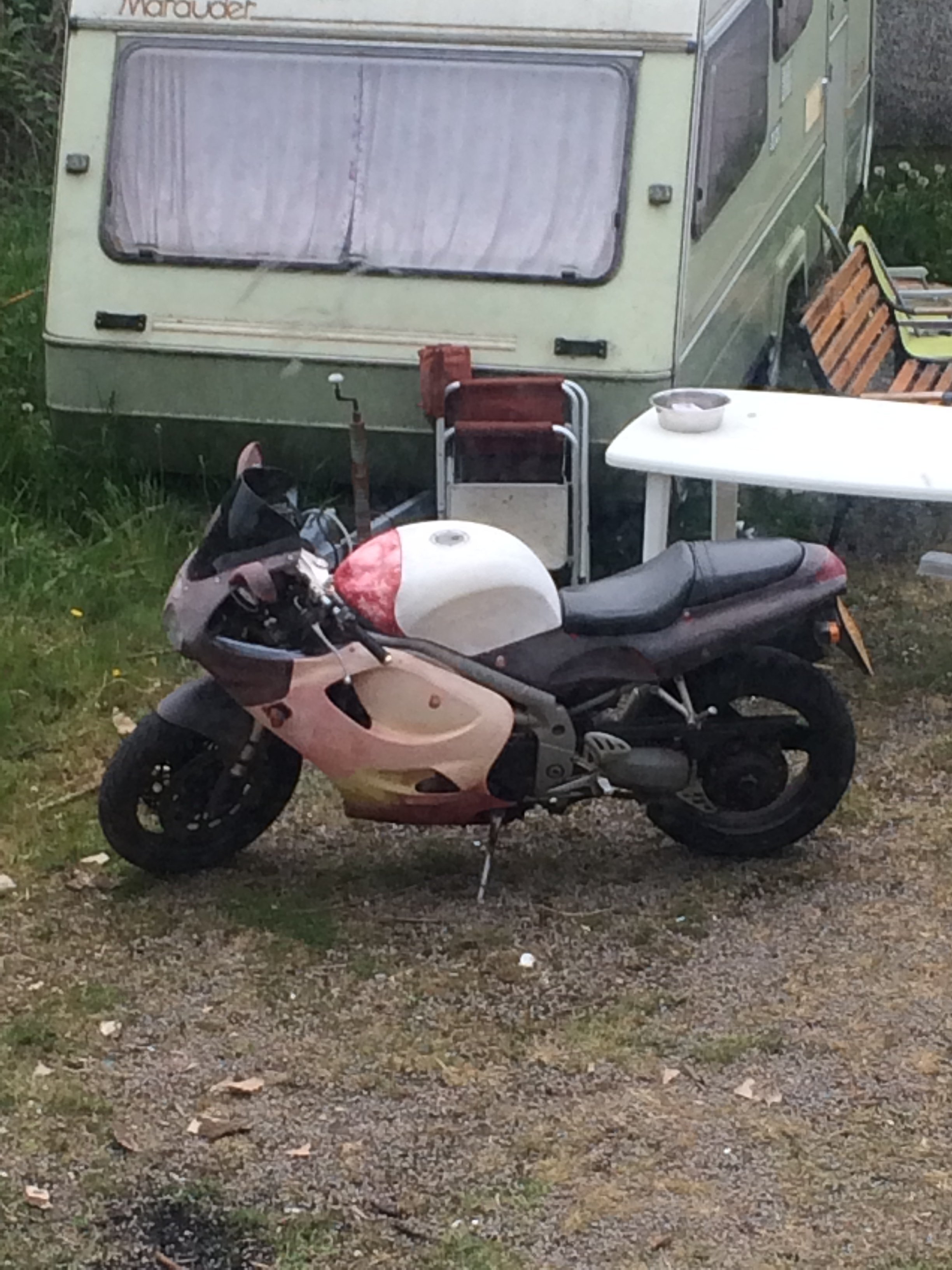

    Hi everyone, im having some real issues with my bike starting after its been raining. I know the simple answer is to get a cover, which is on its way, but in the mean time, how can i get her to fire up? I leave the throttle well alone, and just seem to drain the battery as the starter motor kicks over. There is compression but she just wont fire up. Ive cleaned the battery terminals and made sure they are connected properly. (there was an issue with both terminals getting hot.).
    The bike is kept outside in Wales (lots of rain). Like ive said there is a cover on its way, but ive heard of using a silicone based spray to coat the electrics? but what electrics? can i tape them up?
    When i first got the bike i had to replace alot of pipes and parts, she only has 14k on the clock and has been in storage for quite a few years before i bought her (mot history shows it did 8 miles one year!). As you can see by my pictures, the multi colour panels upon paint removal must mean that she has been down the road a couple of times.
    One odd thing that i cant fathom, is that the spark plugs were 16mm at the bolt, i replaced them with the 18mm as per Haynes bumper bike book of bodgery, i have no idea why this was done???
    All the coils are fine and dandy.
    Any other info im happy to give. Can anyone help???

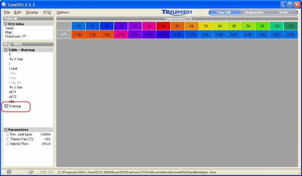

    There is actually a minor table in the ECU mapping (the Warm-Up table) that can make that better - you would need the TuneECU program (and either laptop or Android phone/tablet) and cable to be able to change that.
    With that tool, you would also be able to check and zero the TPS as that could also be making it a bit lean. And there is one more setting that can be adjusted called the Idle Fuel Trim (aka CO adjust) which can also make it a bit richer in the idle and off-idle - if otherwise running well when warmed up, I prefer the warm-up table adjustment as it ONLY affects the cold-starting air'fuel ratio and not warm running.
    ^ You increase the values of the cells in the 'cold' region (these are coolant temps, so your 'cold' temp is going to be pretty much what ambient temperature is - I suggest up to 14 deg to 1.25, 24 to 0.75 and 34 to 0.5 for starters and see how that goes (you have to save the changes and re-load the new saved map)

    So..... ive ripped her appart and got into the spark plugs, they were in good order. As i decided to give the battery a good charge in the house i went to clean the O rings from the Neg/Pos wires. On the Neg i have two wires, one (as i discovered) powers the starter motor and the other does all the other bells and whistles. Well as i was cleaning the muck off it, it fell apart. So after putting it all back together im hoping that just replacing the O ring on the end of the Neg wire will solve the problem.
    When she runs, she is sweet as a nut, get the whine and whistle at the right revs. Only after rain does she sound like a two cylinder, but after a warm up, which includes the exhaust puffing away with steam (exhaust is getting replaced once i fab a bracket), she returns to good standards.
    I may omitted in my previous posts that the throttle bodies may need to be done as she sometimes stalls when idling when she is hot.
  6. Baron
    Baron New Member
    Sorry for the late reply, ive been on my back for a week due to a Pub related injury! However, SHE LIVES!
    I changed the fuel pump and filters and all that jazz, upon opening up the tank it was quite obvious that water was present. So after emptying it out, cleaning out years of sludge etc, i cracked the injector rail and flushed some V-power through, then she ran fine but not under her own steam. I binned the gel battery and ordered an nice old Acid battery and now she is as good as new!
