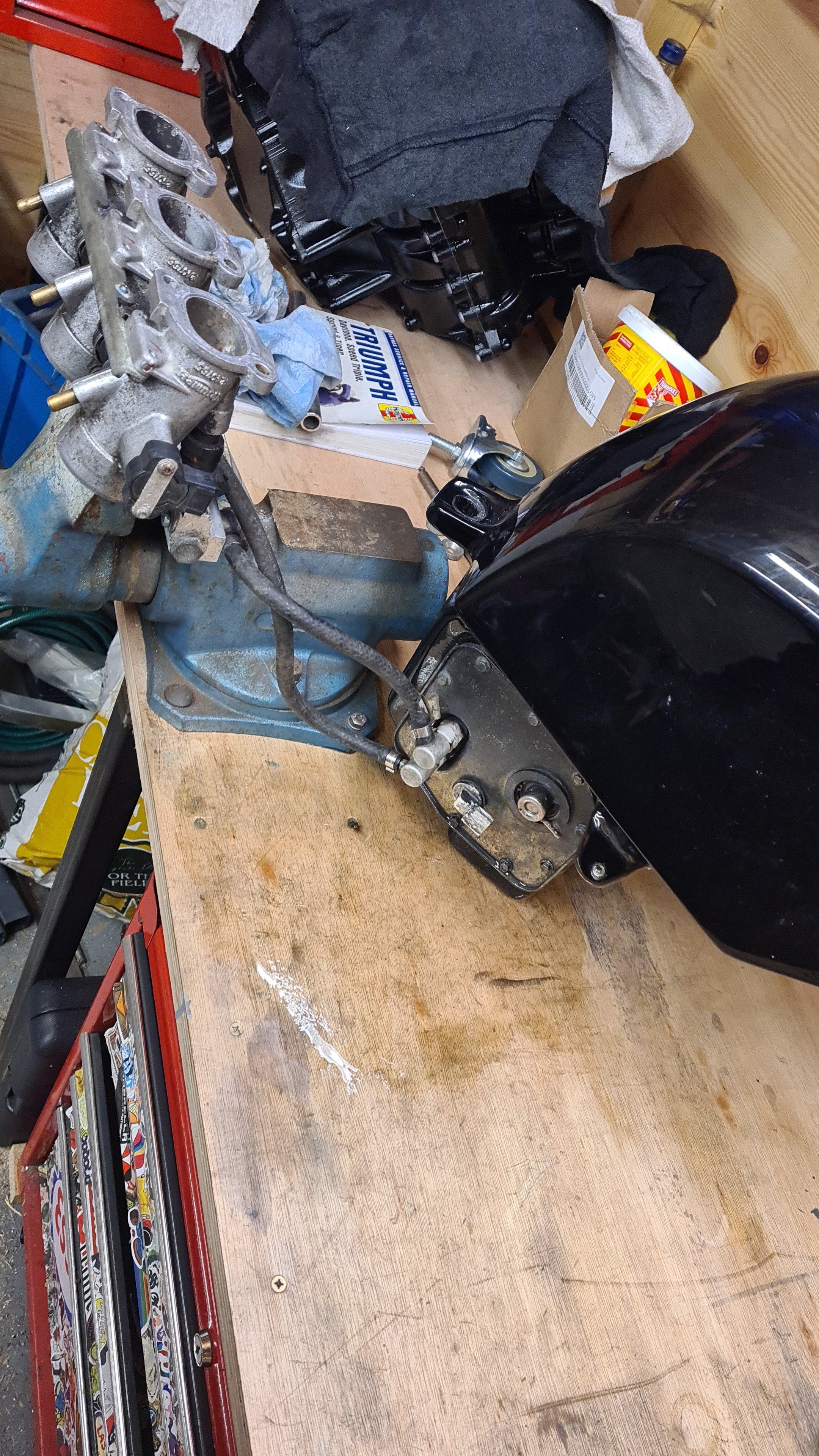

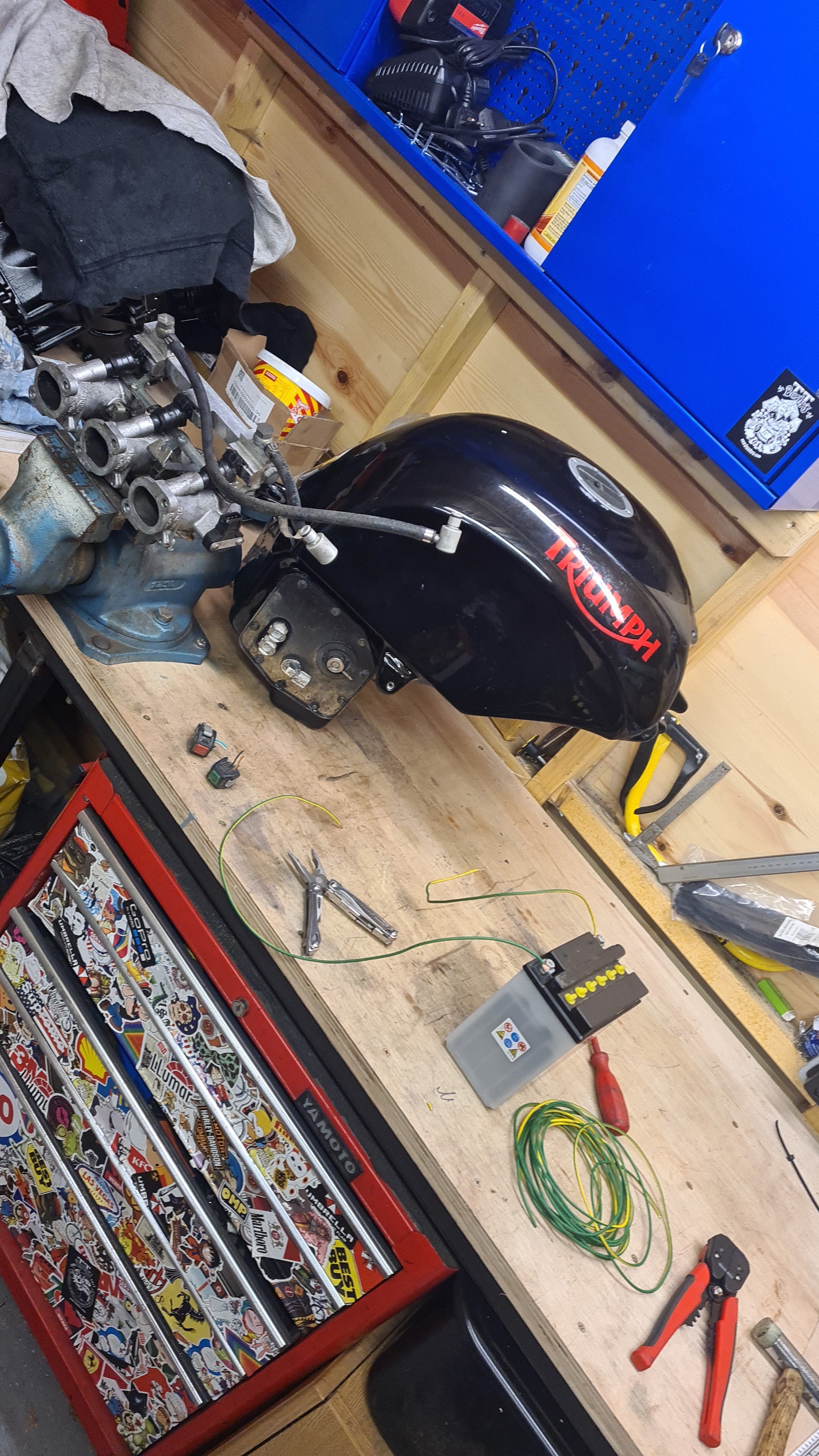

    Out in the shed and very quickly chucked together a wee set up to check the sealing of the injectors and it worked but the fuel line o-rings passed so will replace them and try again. No way of knowing what actual pressure is in the fuel rail but I know roughly how long the pump runs when the engine primes so will just do around that time and hope for the best! Yeeha (insert cowboy emoji)

    That's a pretty good work around !
