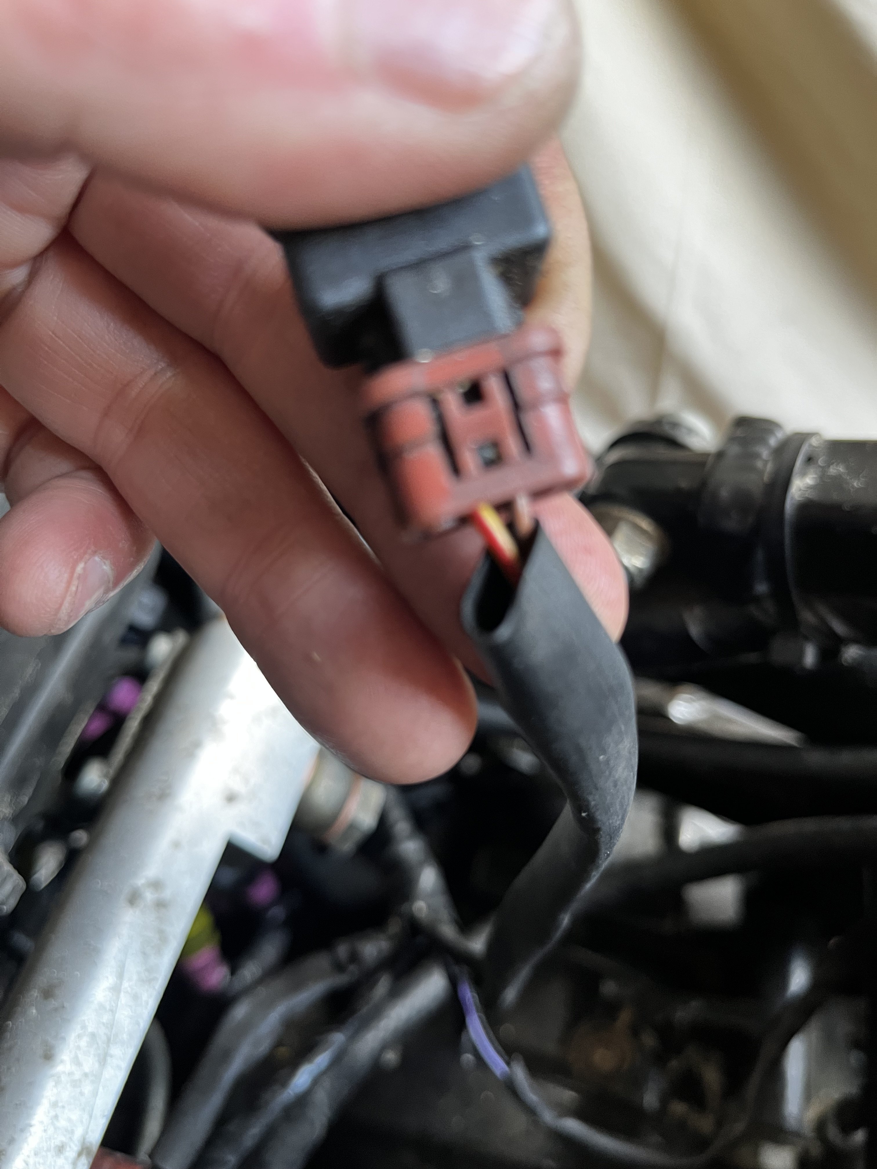

    Hi.. Just started stripping the daytona, and underneath the tank I have a wire dangling loose. ANyone know where it plugs in? I thought it went onto one of the injectors but they all appear to have a wire plugged into them... its 2 wires as in the pictures one red/yellow and the other looks brown. I dont have a wiring diagram yet for the bike does anyone know where I can download one? its a 1997 T595.

    It seems that there is a purge valve connector in the wiring loom but it is for California models only so would be redundant on your bike. It has 2 wires, 1 yellow & red, 1 brown & pink - could this be it?

    Hi... Ive got to the bottom of the mystery wire... apparently the triple uses the same loom as the 4 cylinder bike so its a spare injector connector.. very odd but i suppose makes sense there was nothing to connect it too!

    It's because of the early modular design of the T300 's , they shared many parts!!
