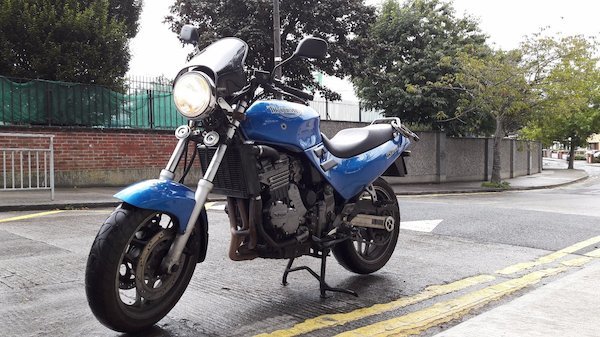

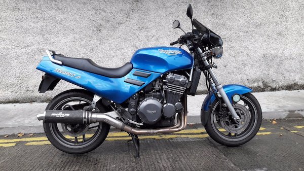

  4. Oldyam
    Oldyam Grumpy Old Git
    May 14, 2017
    613
    ireland
    This is the beastie

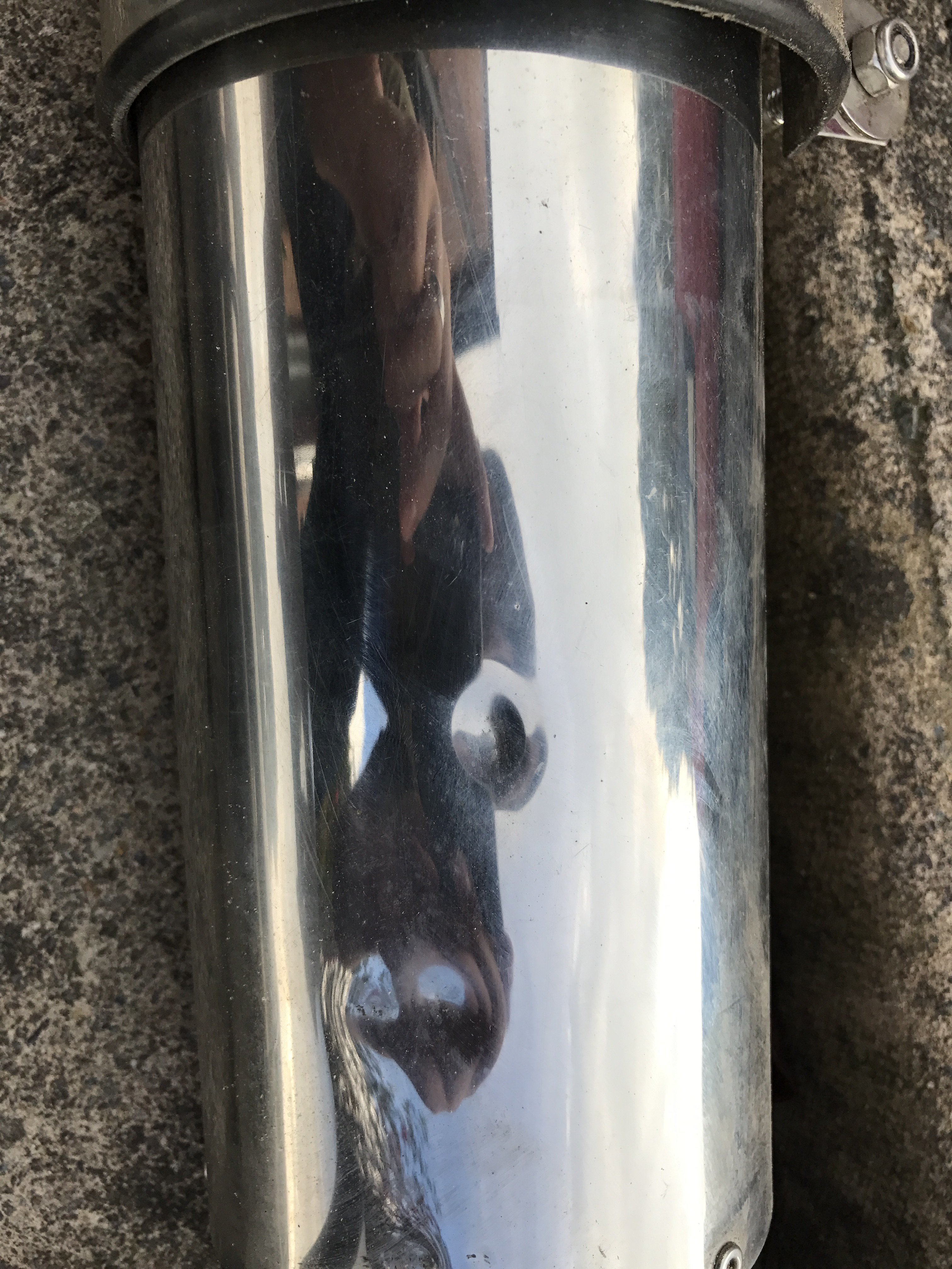

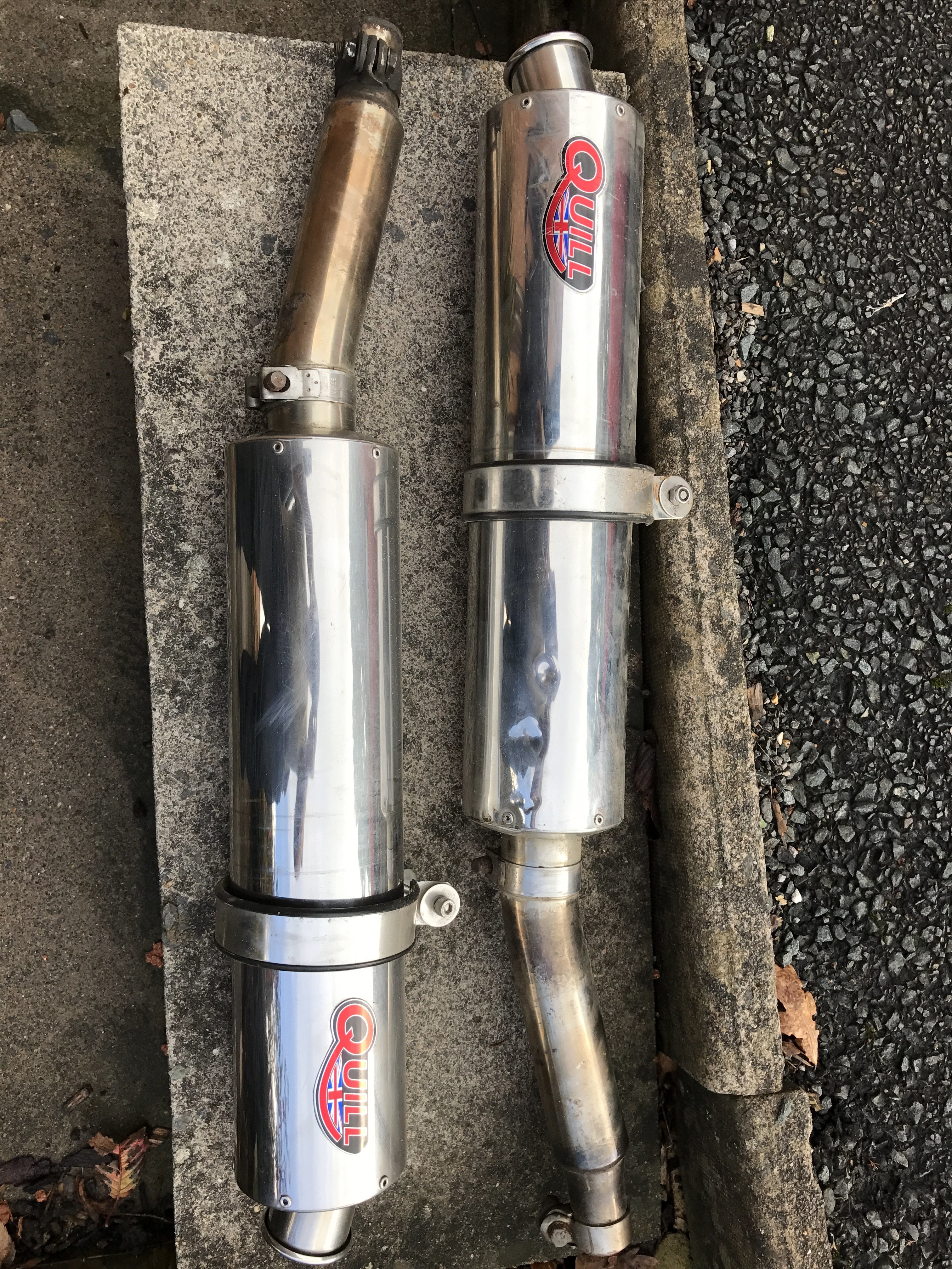

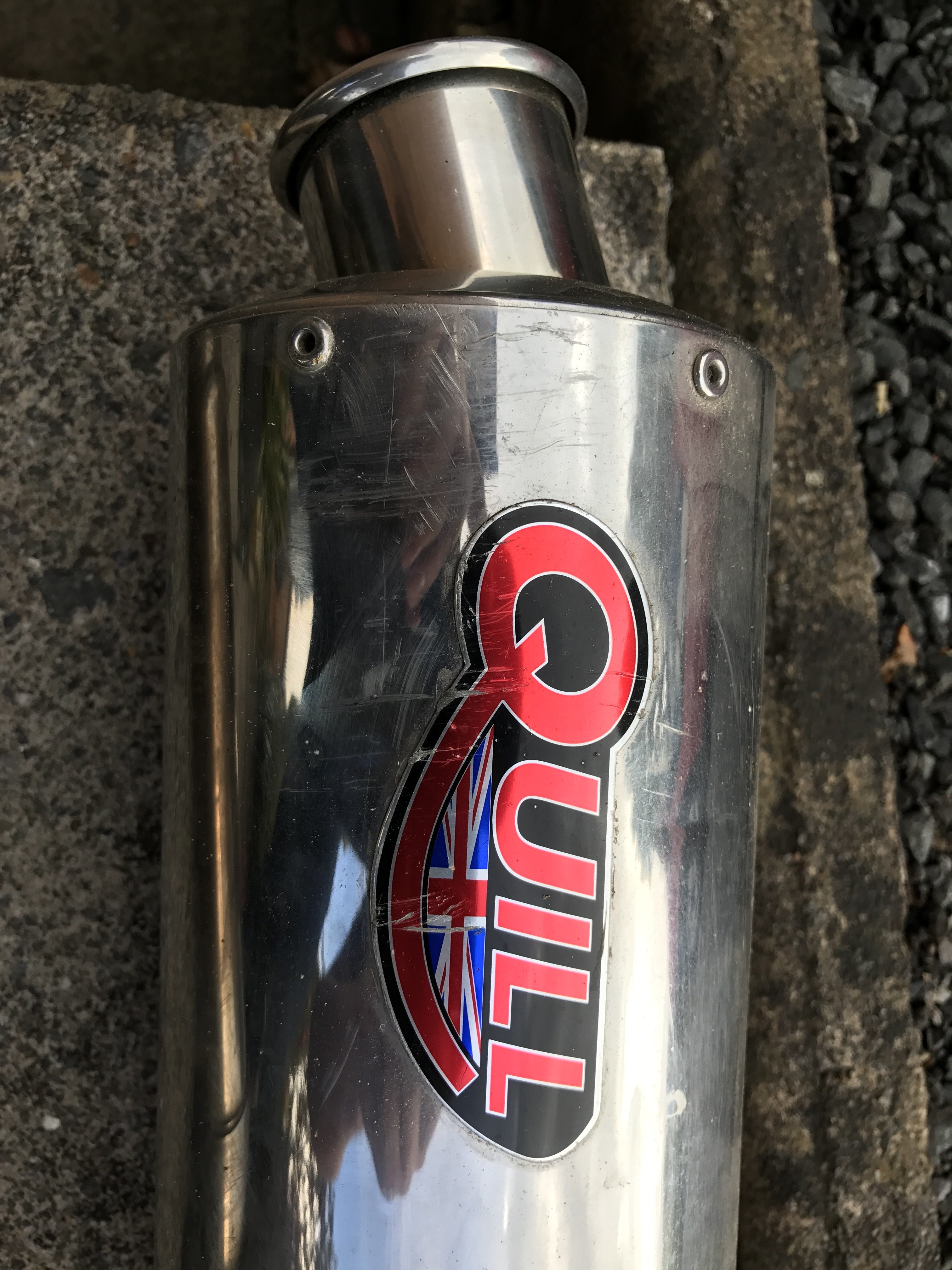

  14. matt botterman
    matt botterman Active Member
    Feb 4, 2016
    106
    33
    sussex
    Pics they are quill not fuel! I've pm'd too
