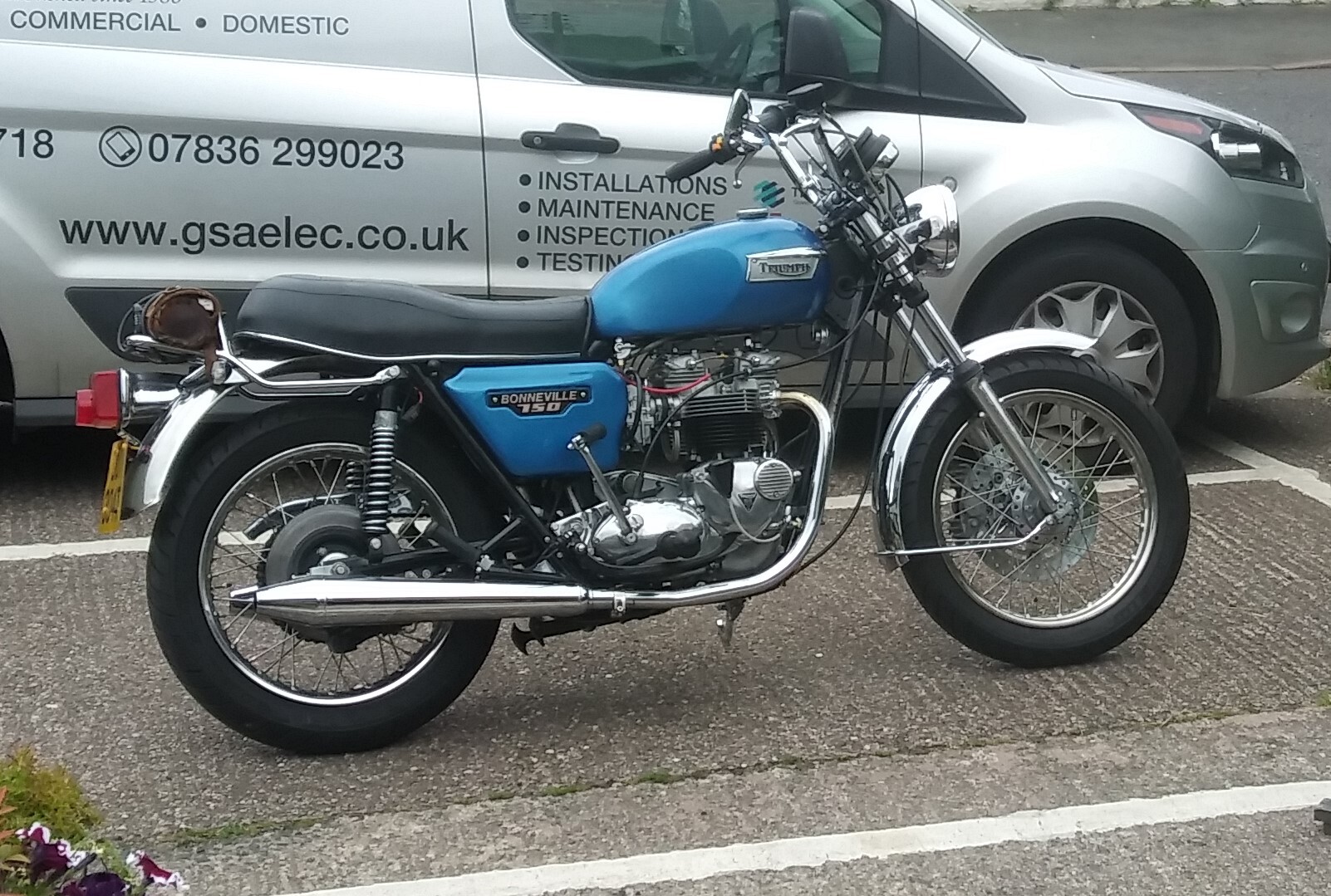

    Welcome to the family. yes just ride it and be happy. Do hit the upload a file button bottom right corner and show of the bike to the inmates.
