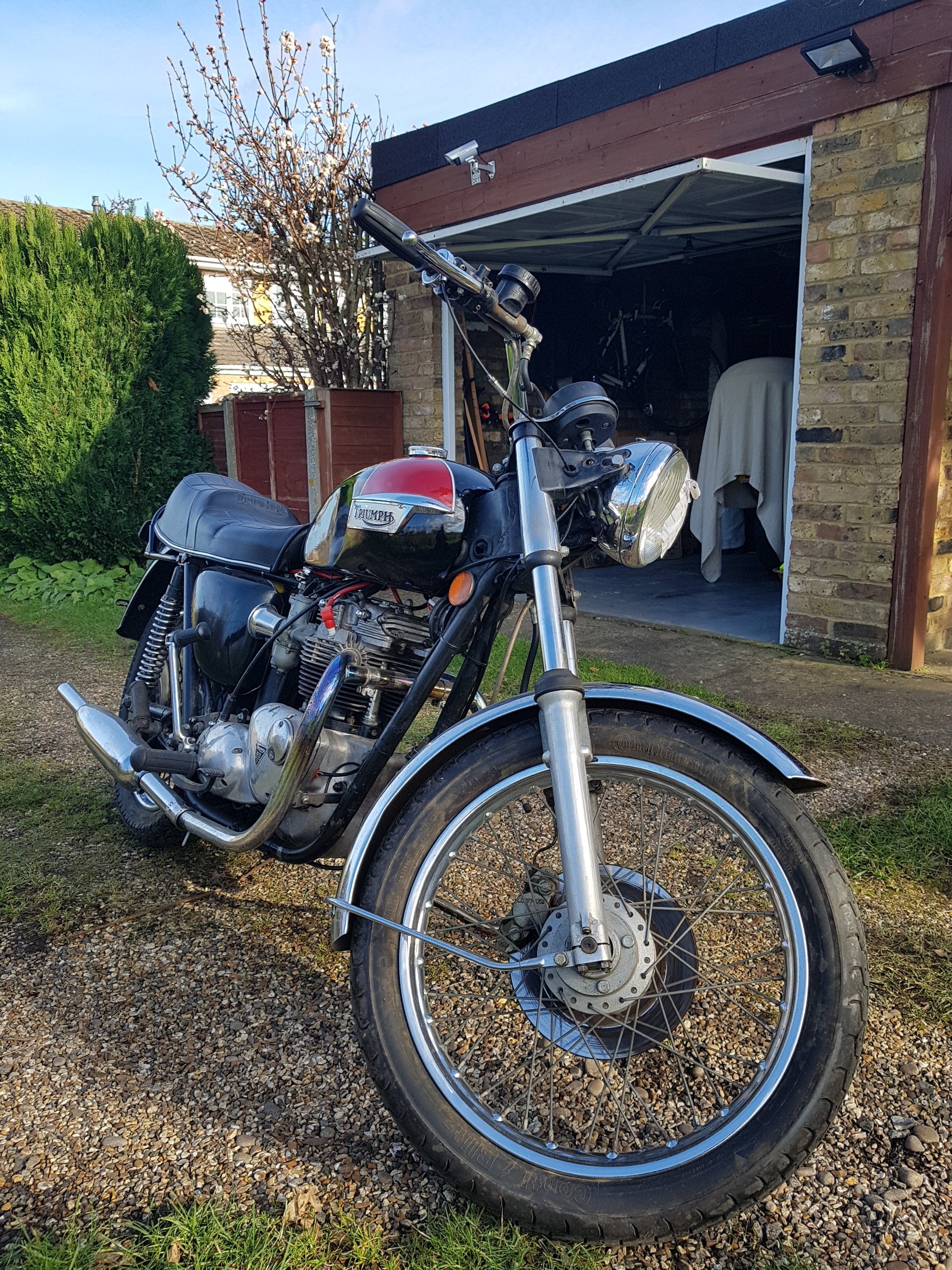

    Hi. I'm new to this forum so forgive me if this topic is an old one! I'm working on a T140 that I brought over from the States. Engine has good compression, sparks and fuel, and the seller sent me a video of it running. I'm do a total strip down and refurb. So my question is ... bottom end. Buy tools and do it myself, or give it to a Triumph specialist? I've worked on many triumphs when I was (a lot) younger, including a race Rickman 8 valve outfit, so I'm reasonably qualified. But I no longer have the pullers etc, and have lots to do on the rest of the bike. I'm happy to do the head and barrels, just thinking about the main lump. Primary drive sprocket needs replacing in any case. I'm in Windsor, Berkshire. Any recommended local engine specialists you can mention? Thanks

    Thanks everyone for the comments and encouragement. maybe I was being a bit lazy! As you say, I've had numerous Triumph twins (and other brit iron) apart in the past, so it's not a mystery. I'm pulling the clutch off anyway as it's glued together, and once that's off I might as well do the primary sprocket. I suspect that the mains are in good shape, but it would be good to check before reassembly. Hopefully I can get the sludge trap out! Here's the "before" photo.

    Nice bike. What miles are on the bike and does it need a strip. If low miles i would just run a flushing oil and let that do the job. Then run a good 20/50 for around 100 miles and do a change. Welcome to the family.
