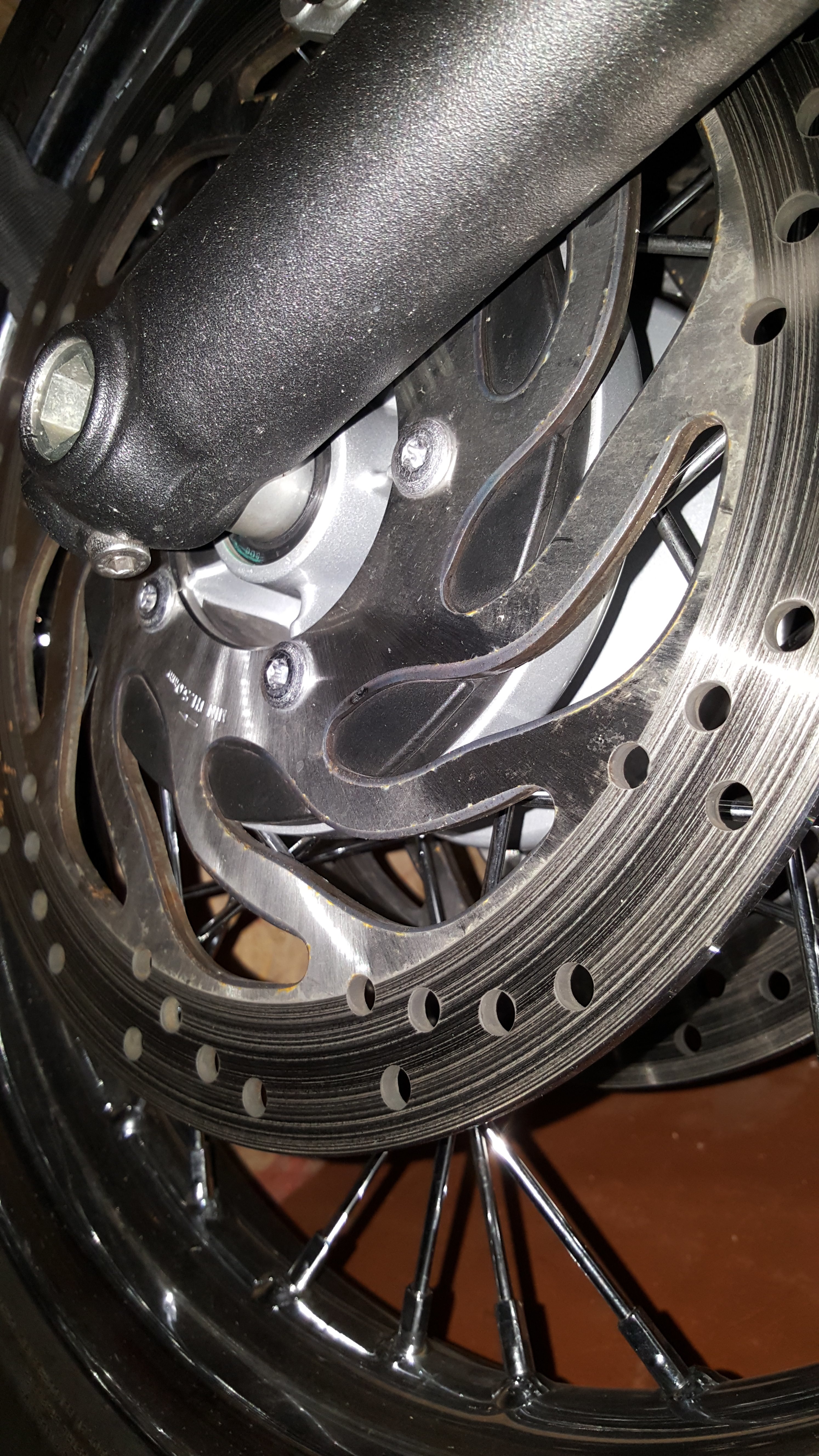

    I had horrible brake squeal at the front when I first got my bike. The dealer replaced the front wheel with a modified one under warranty. The modified wheel has a sound absorbing pad between each disc and the spokes, see images, the black disc is the cure. 20181227_175949.jpg 20181227_175959.jpg Seems Triumph could not cure the problem which was noise reverberating through the spokes but they have removed the noise!
    If any T120 has this fault and is within warranty, see your dealer asap.

    Interesting, see its kind of a fix, lets hope the absorbing material is impervious to oils, road muck, sun etc.
    Also a point to make is I have never heard this problem with other wire wheels, could it be that the type of spoke they use. Does anyone have stainless spokes fitted?
    I've recently read that Triumph stated that you ride the bike and brake hard to remove the glazing on the pads which is the cause of the squeal.

    Morning Cupoftea, I asked the salesman about the spokes when I bought the bike, he said they are not stainless, too brittle apparently

    I agree that any disc brake can squeal depending on various conditions, however, this was in no way acceptable. The noise was terrible, embarrassing in fact, especially in a narrow street with the amplification effect.
    When the dealer told me they were going to replace the wheel with a modified one I wondered how that could cure the brake noise.
    Well, I don't think it has, instead, they have isolated it via the modification.
    In order to do that they have had to redesign the wheel to accommodate the modification without altering the overall appearance of the wheel.
    I my case the new wheel, which incidentally was supplied complete with discs and pads, has cured the noise issue, and an added bonus, the brake is better too!

    I’m a bit mystified by the front disc brake squeal reports to be honest. I’ve got a 2016 T120 with an unmodified wheel/disc. It squeaked for about 50 miles around the 500 mile mark and nothing since several 1000s later. The only time it squeaks is when I’m rolling it backwards down the drive with the brake lightly squeezed - not really a problem. The front disc squeal doesn’t seem to be a ‘reliable’ problem on all bikes. If it was a problem I would have gone back to the dealer pronto, but it’s not so I haven’t.

    Well....I did say it wasn’t a problem and I was prepared to live with it but when I mentioned it to my local dealer that there was an occasional squeak he contacted Triumph and said they would replace the front wheel under warranty. No quibble stuff, quite impressive really,

    Hi Gazzatriumph. I must have got lucky with my dealer / person they dealt with at Triumph as my wheel was replaced without quibble on a 2016 T120 last month. I must say this level of service builds my loyalty if I had your experience I wouldn’t feel so well disposed towards the brand. Hope you can get something sorted.
