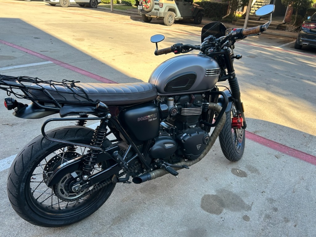

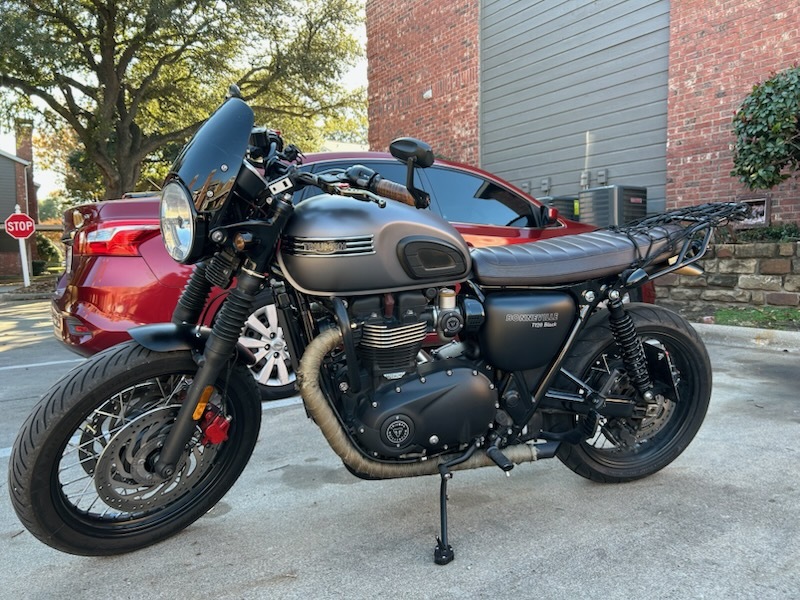

    I went with British Customs Slash Cut Exhaust Tips.
    Full access to chain and wheel, no issues with center stand, looks great, sounds even better.
    The peashooters are classic and iconic and provide a refined -even subdued- sound. There is an identifiable note or pitch to the hum which i think a lot of enthusiasts/traditionalists love.
    The exhaust tips will effectively eliminate that pitch, but unleash a really nice rumble and bark that is not too loud but infinitely more fun. It will not be as loud as a Harley, and does not idle obnoxiously, but when you open the throttle, it's sure to put a sinister grin on your face >:)

    It means I didn't have to touch the center stand whatsoever and had zero problems installing the tips. However, mine is a 2018 and yours is a 2023 so maybe there is some slight variance.
    Feel free to reach out to the good people at British Customs to address any concerns with your specific year. They also have an installation video on YouTube

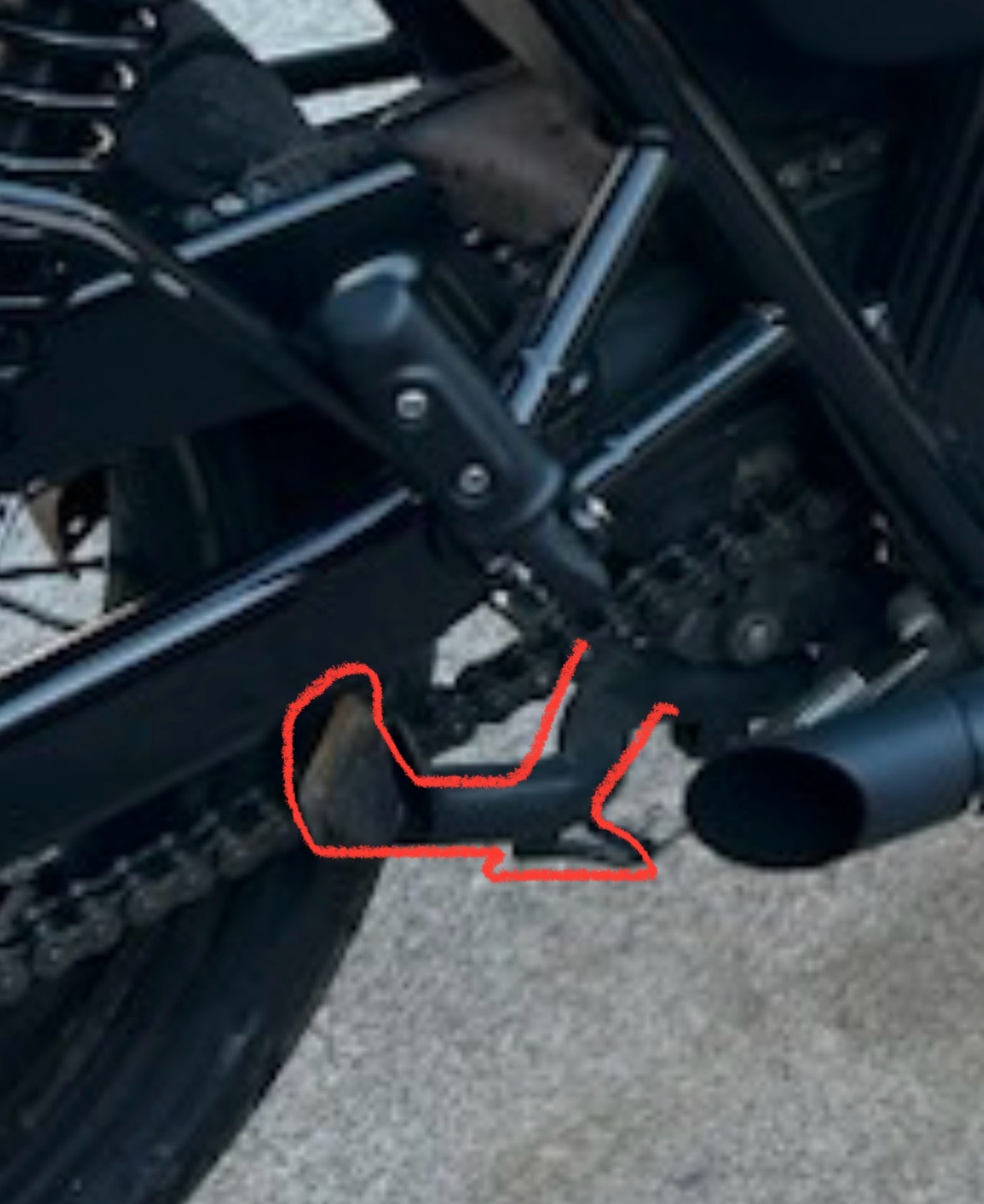

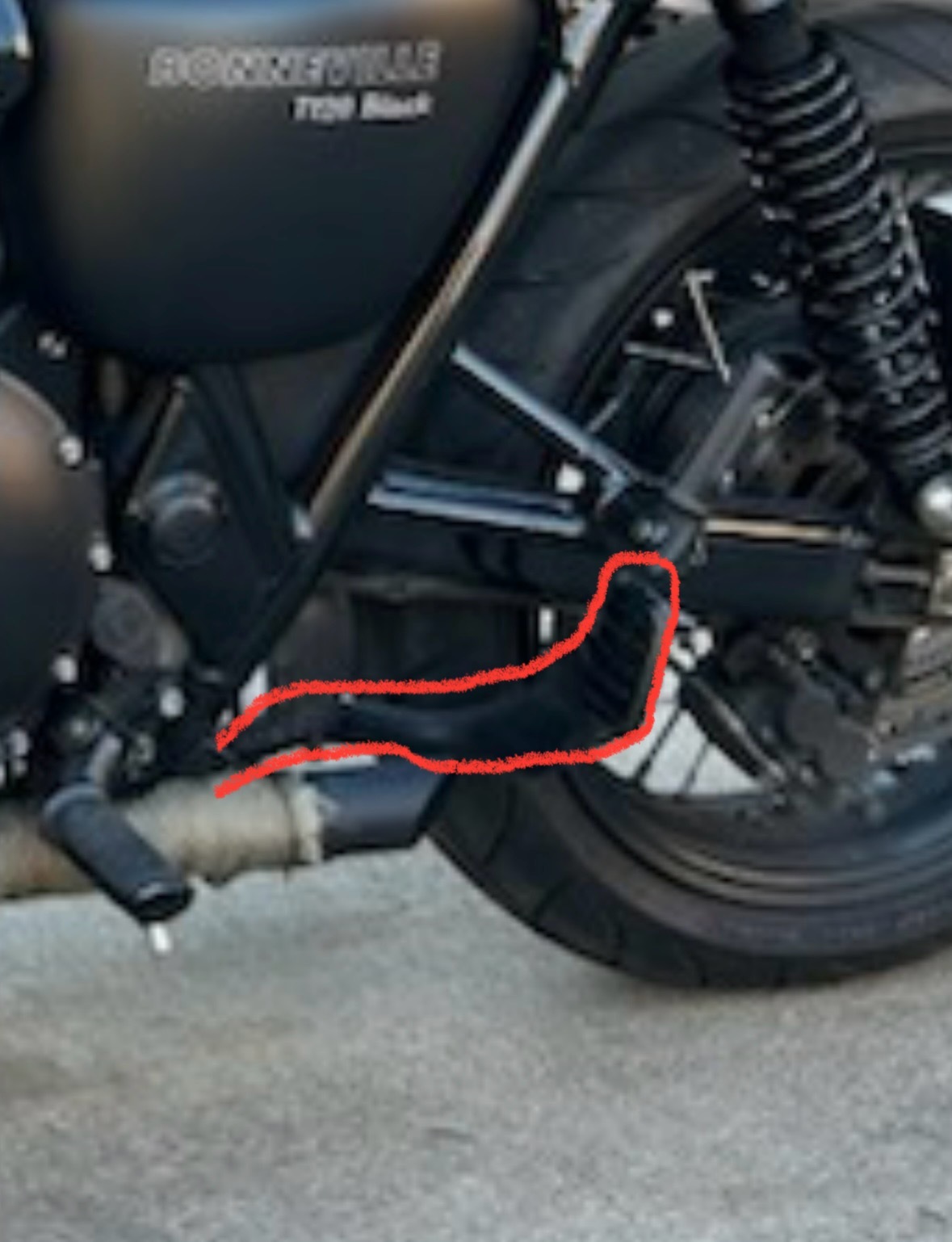

    Ah, perhaps a misunderstanding of the issue. When you take your bike off the centre stand, what stops the stand in it’s raised position?
  7. Jamesian21
    Jamesian21 Member
    Apr 15, 2024
    49
    Texas
    Looks like the coolant reservoir
  8. learningtofly
    Sep 25, 2018
    2,555
    James, I dont see a centre stand on your bike - at least not in the photos you've shared. Are you sure you're not referring to the side stand?
  9. Boothman
    Boothman Elite Member
    Jul 26, 2023
    1,065
    Wigan
    Look again @learningtofly - he has a centre stand in the two photos shared above

  11. Boothman
    Jul 26, 2023
    1,065
    Wigan
    #11 Boothman, Oct 4, 2025
    This help …..
