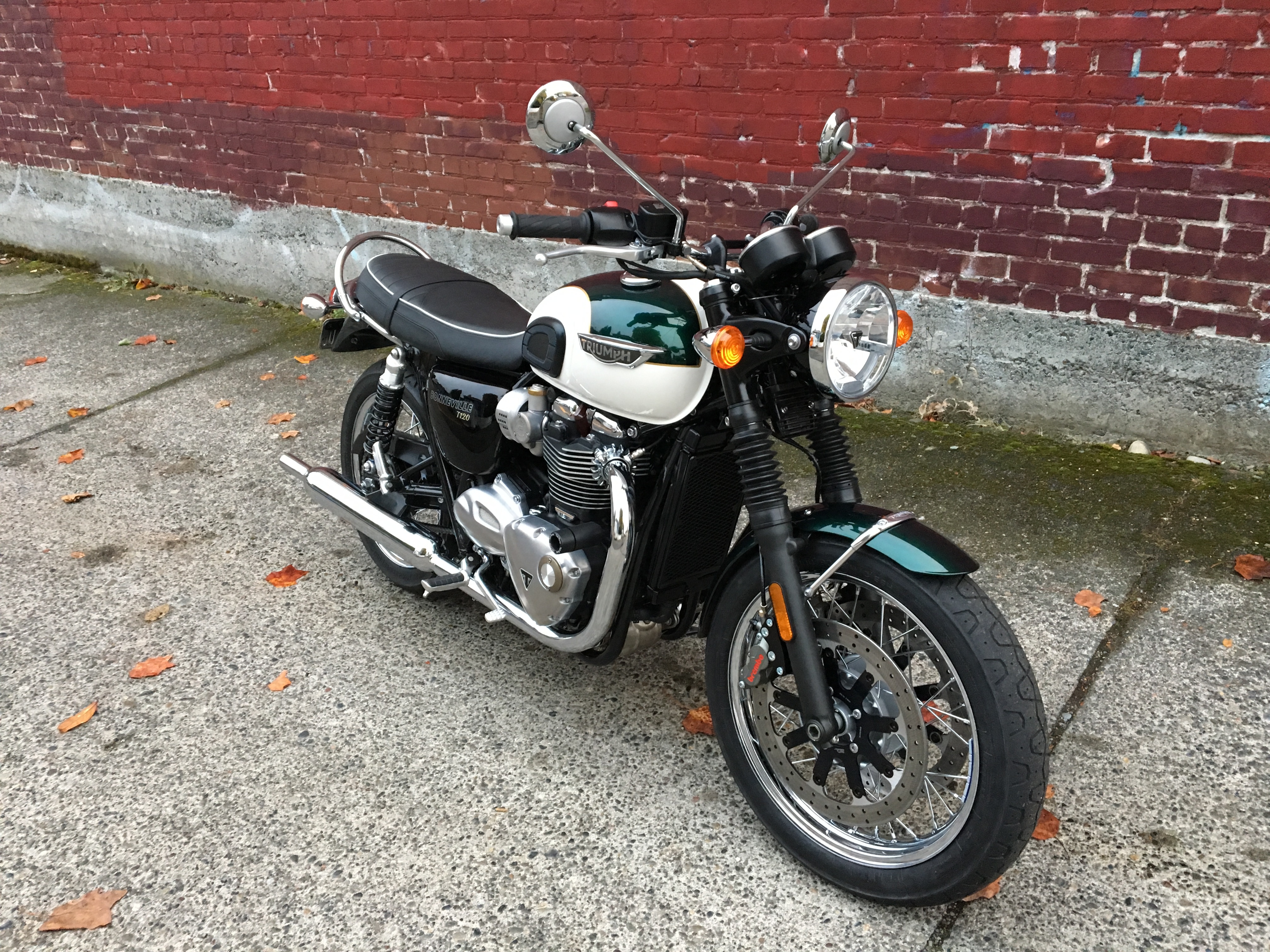

    I mounted the Free Spirits uograde kit to my T120.
    The OEM kit on my bike was slightly numb feeling, and the initial bite was wooden. But after using it for 500 miles I had acquired respect for it. The OEM brake equipment is nothing special but it stops well.
    The Free Spirits rotors and Brembo caliper kit are better, but won’t change your life. I’d say it’s a ten percent improvement. Initial feel is better and the bike stops HARD. I’m glad I did it, but it’s one of those things that makes you wonder if this is God’s way of telling you that you have too much money.
    Before and after pics:
