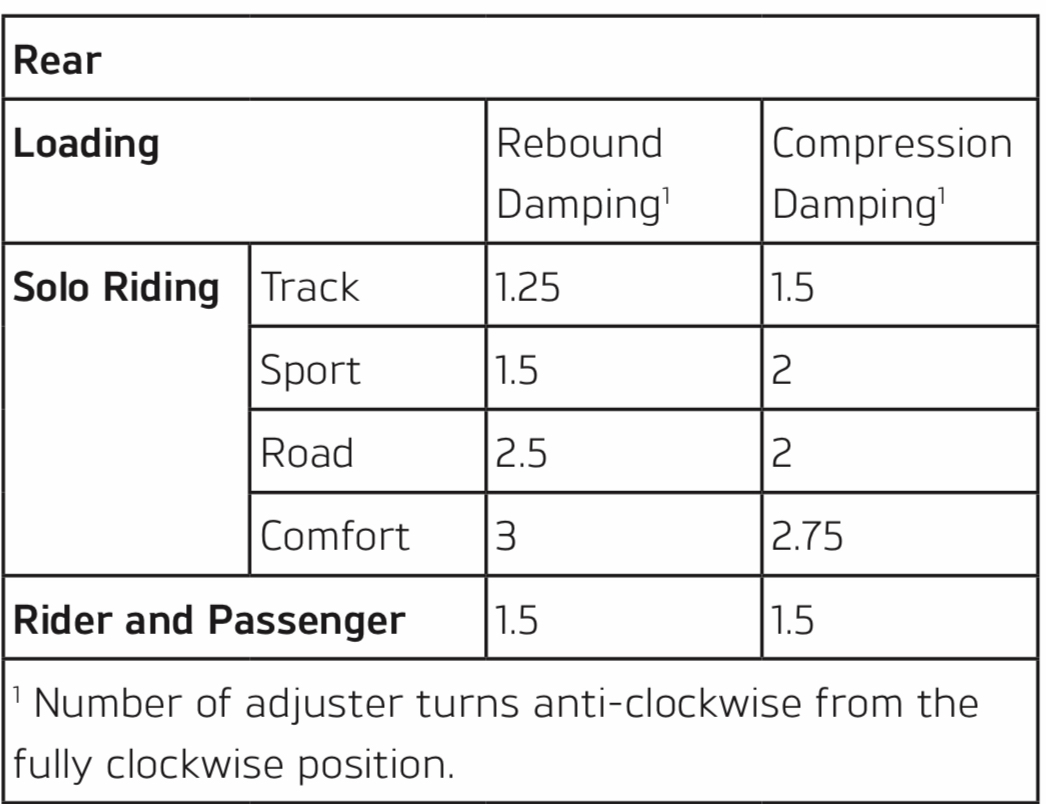

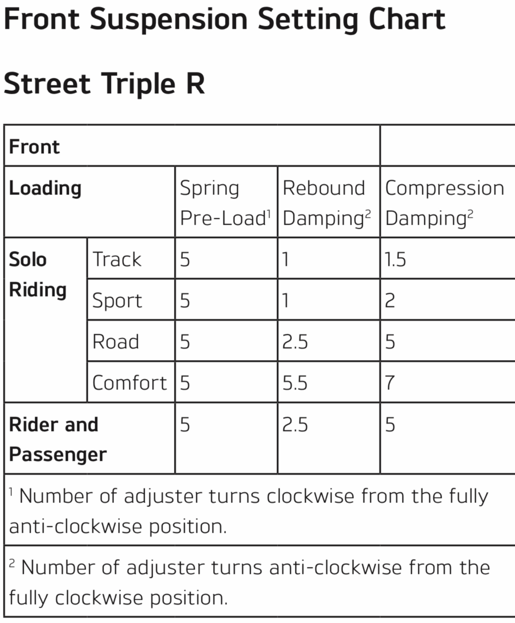

    I found the factory settings (Road) too harsh. I only go 66kg in normal clothing so adjusted the settings to Comfort. Certainly an improvement but have yet to go through the full routine. You will find that the rear preload is already at the minimum setting.
    From the owners handbook starting on page 153 you will find the suspension settings and how to adjust them. The following are excerpts from the manual.
