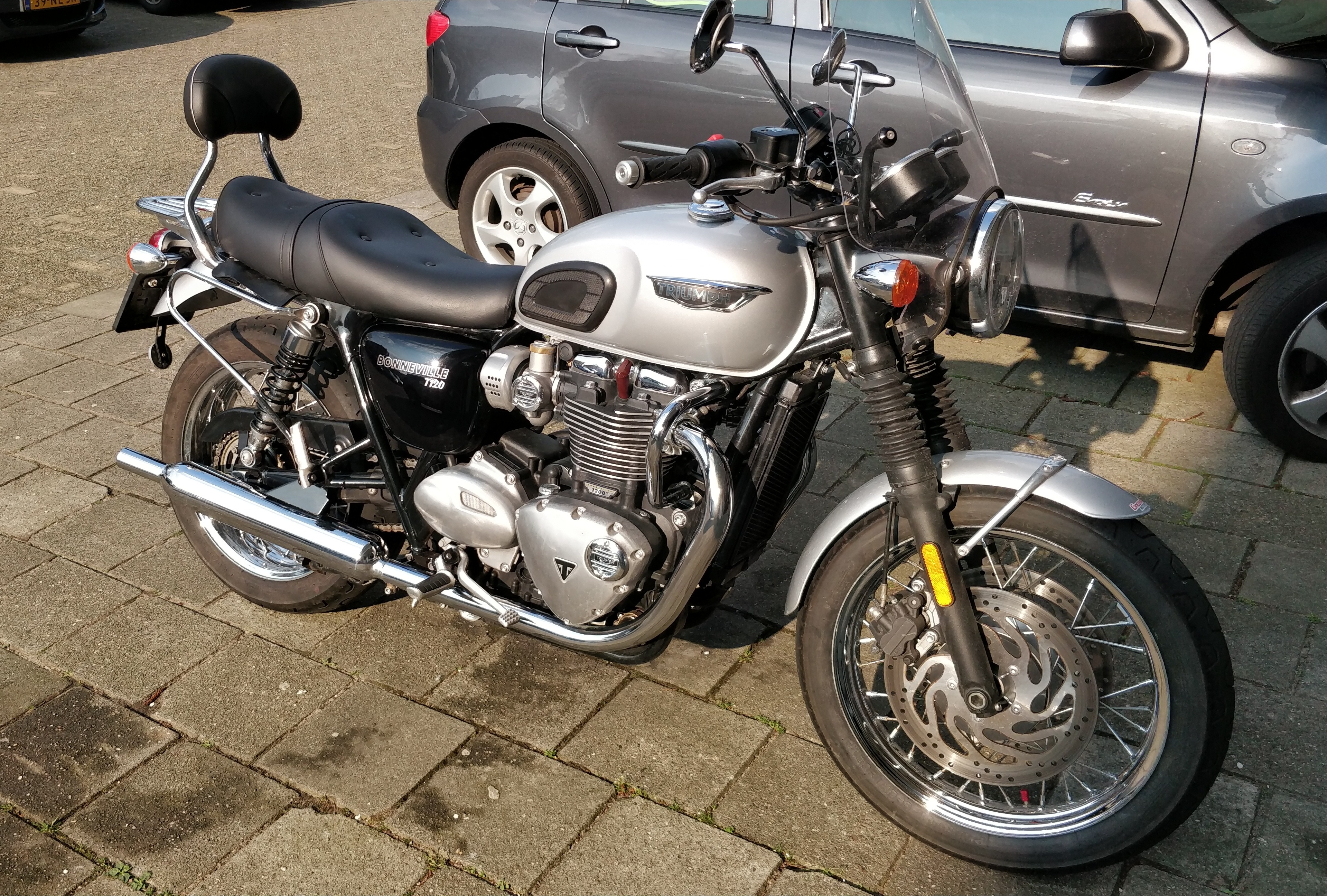

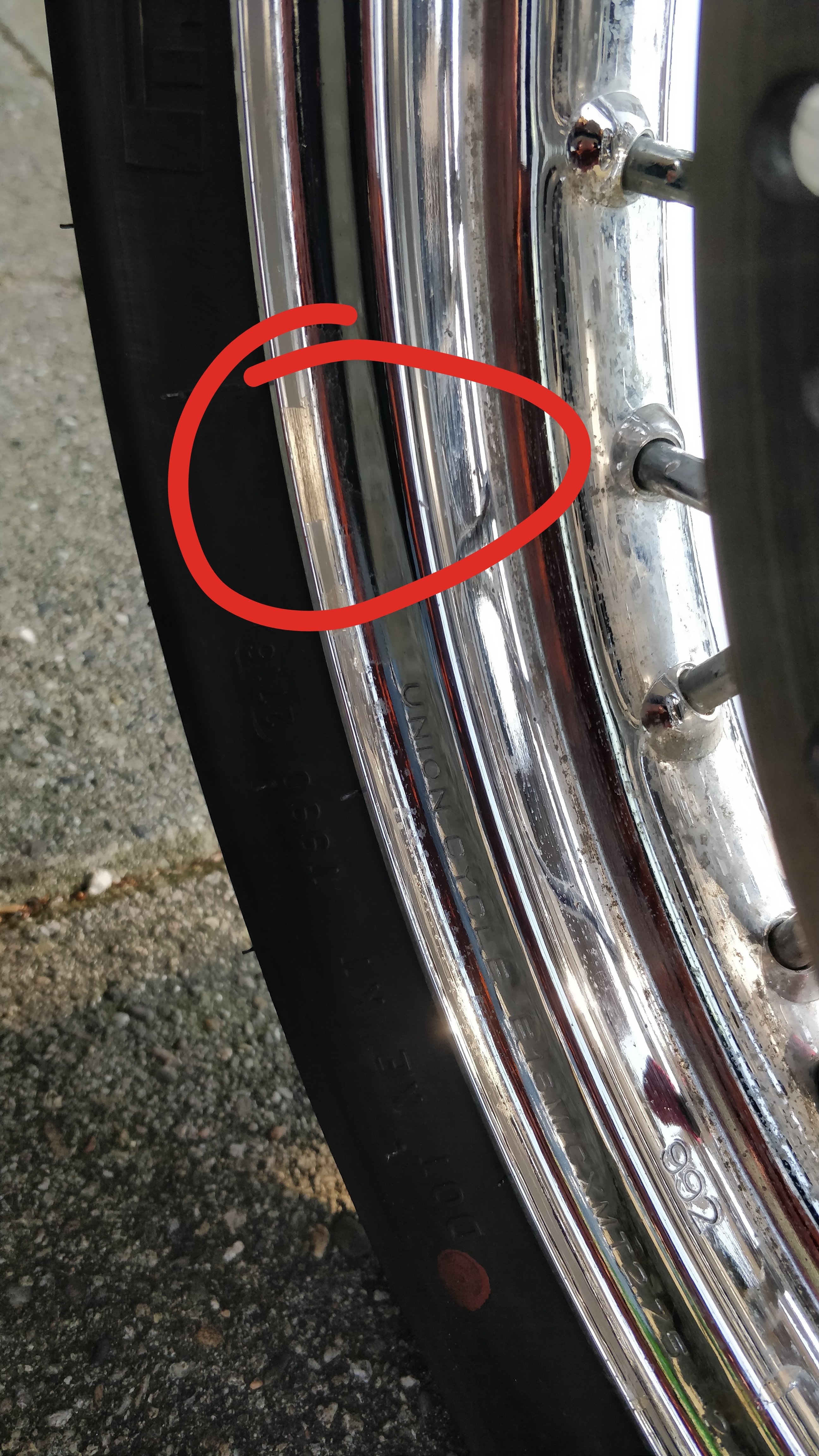

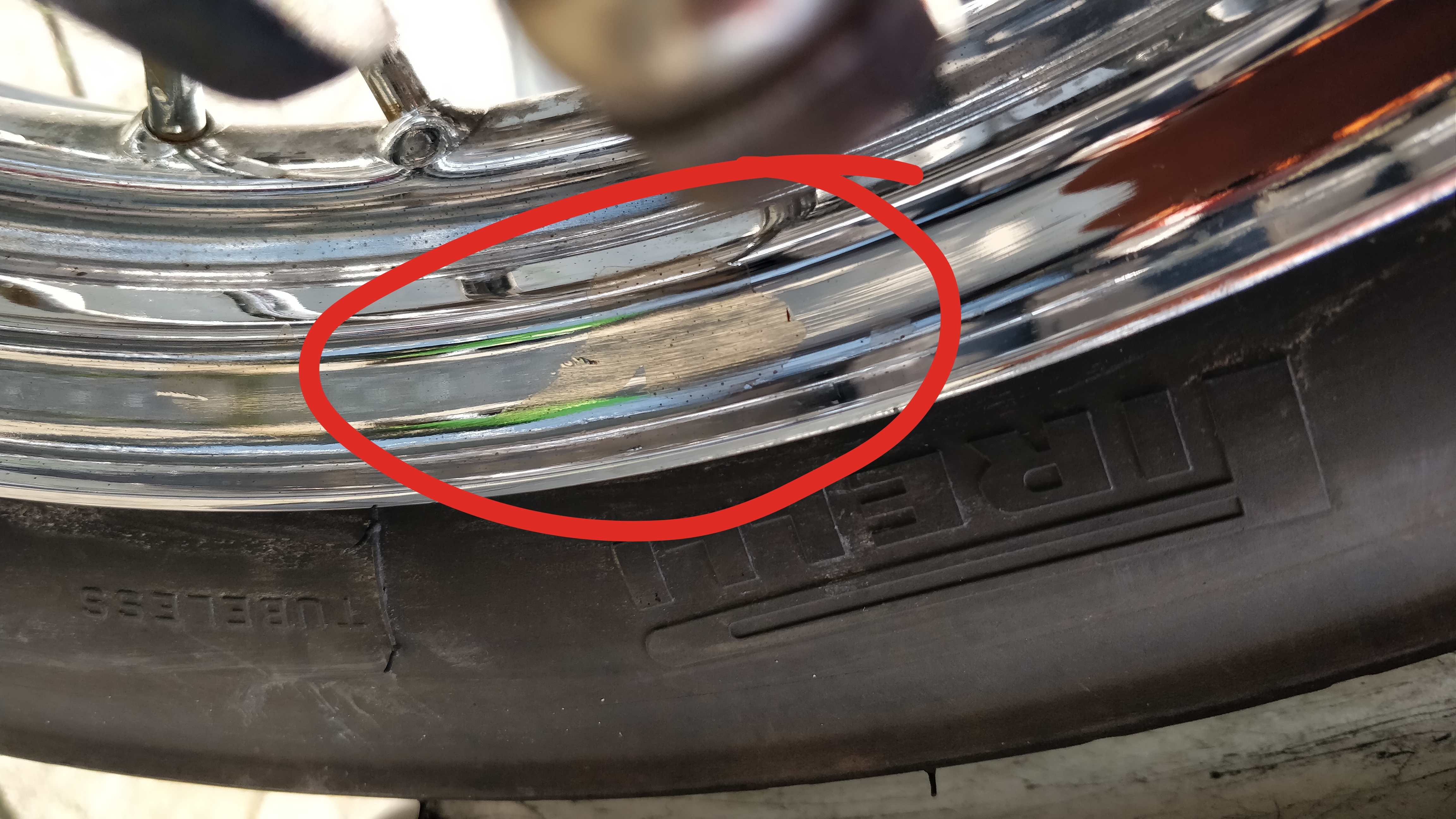

...at least, that was the plan. So I'm all packed and ready to go, got her out the garage, try to get her going but... nothing. No nice sound of my Bonnie starting. What did I miss? I'm already feeling stupid on my bike, getting my helmet off. Turns out, after 2 months in my garage, the battery died. And on top of that, also no petrol. So first things first, I went out to get some petrol. Needed to buy a jerrycan and some cables to give the battery a spark (so glad the diy shop is open on a Sunday cause all other shops in the area where I live, are closed). Back at my garage I filled her up. Got her outside and thought, let me wash her first, than I can really enjoy the ride. We'll that took me longer than I expected, haha. Also the battery was sooooo dead it took some time to get some life into her. So 2-3 hours later (cleaning, and acting like a heart surgeon with my car as a lifesaver) I finally sat down and rode off. When I came back, I decided to polish her to finish the job. From top to bottom, but at the bottom (the rims to be precise) I saw that the chrome came off! What did I do (wrong)? Cause it was only warm water with a teaspoon of soda and a sponge. Or was it the dots of rust (that I tried to rub of) that did the job? Better question, how to fix it? So not only her battery died, she is also shedding. hopefully it isn't contagious All in all, I enjoyed today. Little adventure, made me wonder if I should take a jumpstarter with me on holidays? What do you guys take with, in case of emergency on your trips?
ElectrAbigail. Well at least you got you ride in. And yes all my bikes live on an optimate charger when not on the road. I have never ever been stuck for a jump. Couple of times in the past I have let parking lights on and alarm but someone always pulls over and they give me a jump start. Your chrome is a whole new story. Those rust spots have multiplied under the chrome and lifted it. You ride a bike in salty weather or bad rain you must treat those rims. And lay a bike up make sure those rims are cleaned and treated with a wax polish. Only thing you can do now is re chrome not cheap or find new wheels. Ride Safe Joe.
Abigail, sorry to hear about your problems, if the bike is only year old then make sure you take it back to the dealer, that chrome plating should be good for 20 years not just 12 months.

Look, I'm really sorry to have to say this...but it's neglect. You can't just leave your bike for long periods of time and expect it to work well. My bikes live outside....but even though winter I'm out there regularly cleaning, checking ...making sure the batteries are fine..removing crud from wheel rims airing them on sunny days to keep the damp at bay. This is basic. Don't abandon your bike and hope it'll be ok. Sorry...I don't mean to sound critical but bikes aren't ok being left.
I have read other stories about chrome plating coming off on other Triumphs that have been used in winter, take it back to dealer & don't let them fob you off with rubbish that you shouldn't ride when salt is on the roads, the finish should have been up to it!
There’s no excuse for the chrome to be coming off after one year of ownership, even if it’s parked outside. I’m sure Triumph will do the right thing and replace the wheel. I don’t use my bike in the winter, but I do use an optimate and swap it between the Triumph and the VStrom during the winter months Let us know how you got on Abi

BonnieCat. That's quite sad that your bonnie has displeased you. Did you try the dealers to see if you can get those wheels changed. Because as some of the peeps have said for chrome to strip like that is a sure sign of poor quality. And also a lot of that corrosion is coming from under the chrome so its worth a try. Regards Joe.

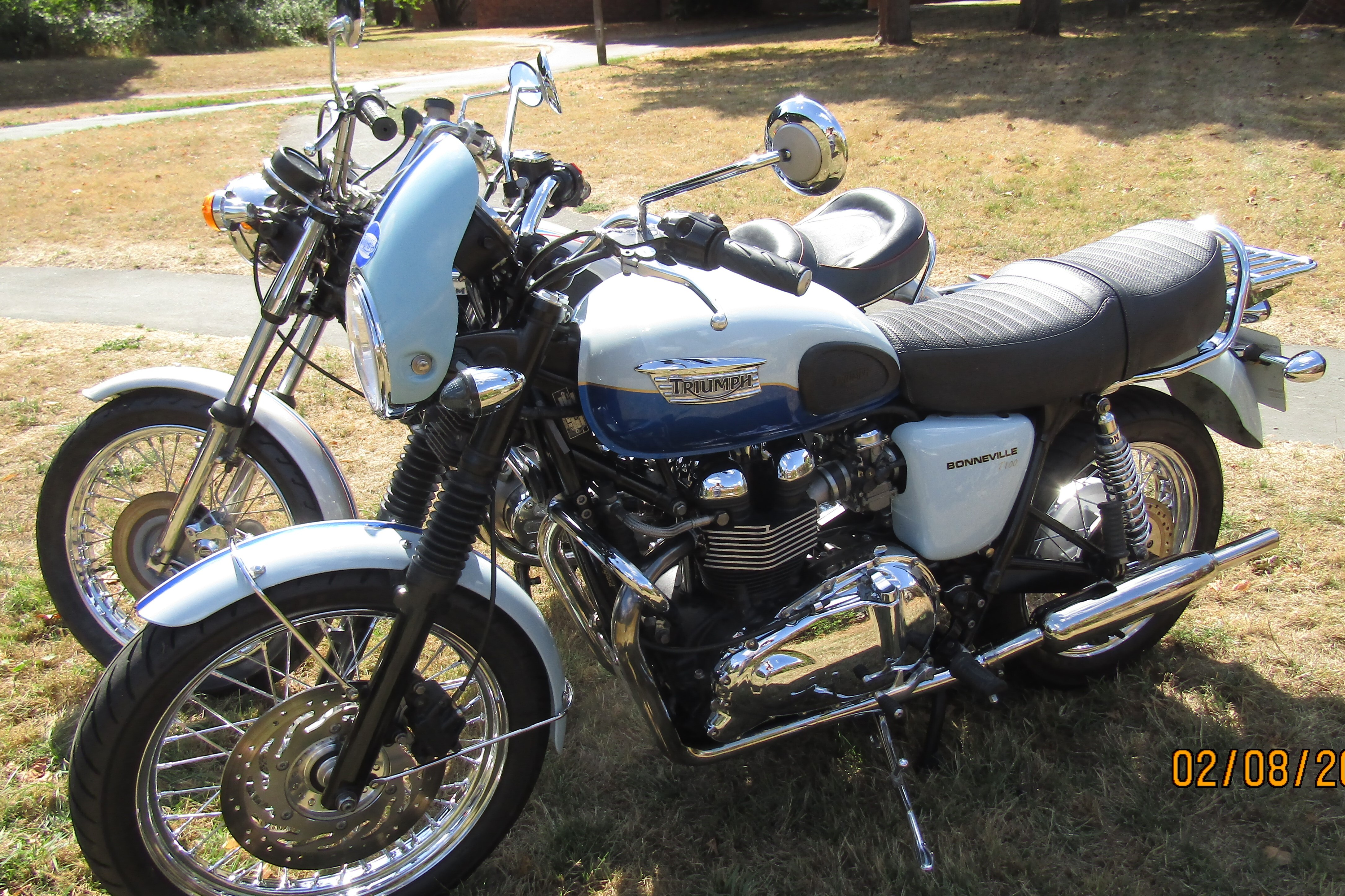

BonnieCat. Yes just me being an idiot. It was ElectrAbigail Wasn't it. I have said on here a few times. R K Leighton do a fantastid job on seats. Don't know how much to post it but I usually get all my seats rebuilt by them. They do exactly what you want. That's the t100 seat they did for me and I love it can ride all day on it. They even phoned me a couple of times to check if I would be happy with various options they were thinking about. I chose this one. Regards Joe.
