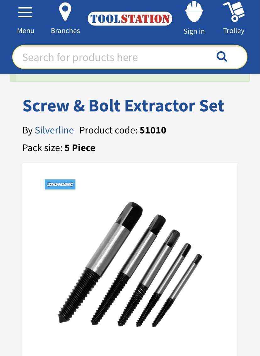

  12. andypandy

    Stuart595.
    Yes I have used the easy outs and they are a bad idea. They tend to snap and when they snap in the bolt you won't even be able to drill. I still use them but if a bolt shows extra resistance I take them out. As said here before i would rather drill or Dremel the head of the bolt and try moulgrips.

    Those easy outs are not that easy to use. Is there enough clearance at the corner to use a Stilson (pipe wrench?) I have used them on vehicle brake bolts where heat has accelerated corrosion. Leverage tightens them.

    Cheers, Joe,
    I guess I’m looking to approach things in stages, and the ‘if it looks like snapping stage,’ may be a valid part of a spiralling journey to drilling the head off and risking warping the head from the sudden release.
