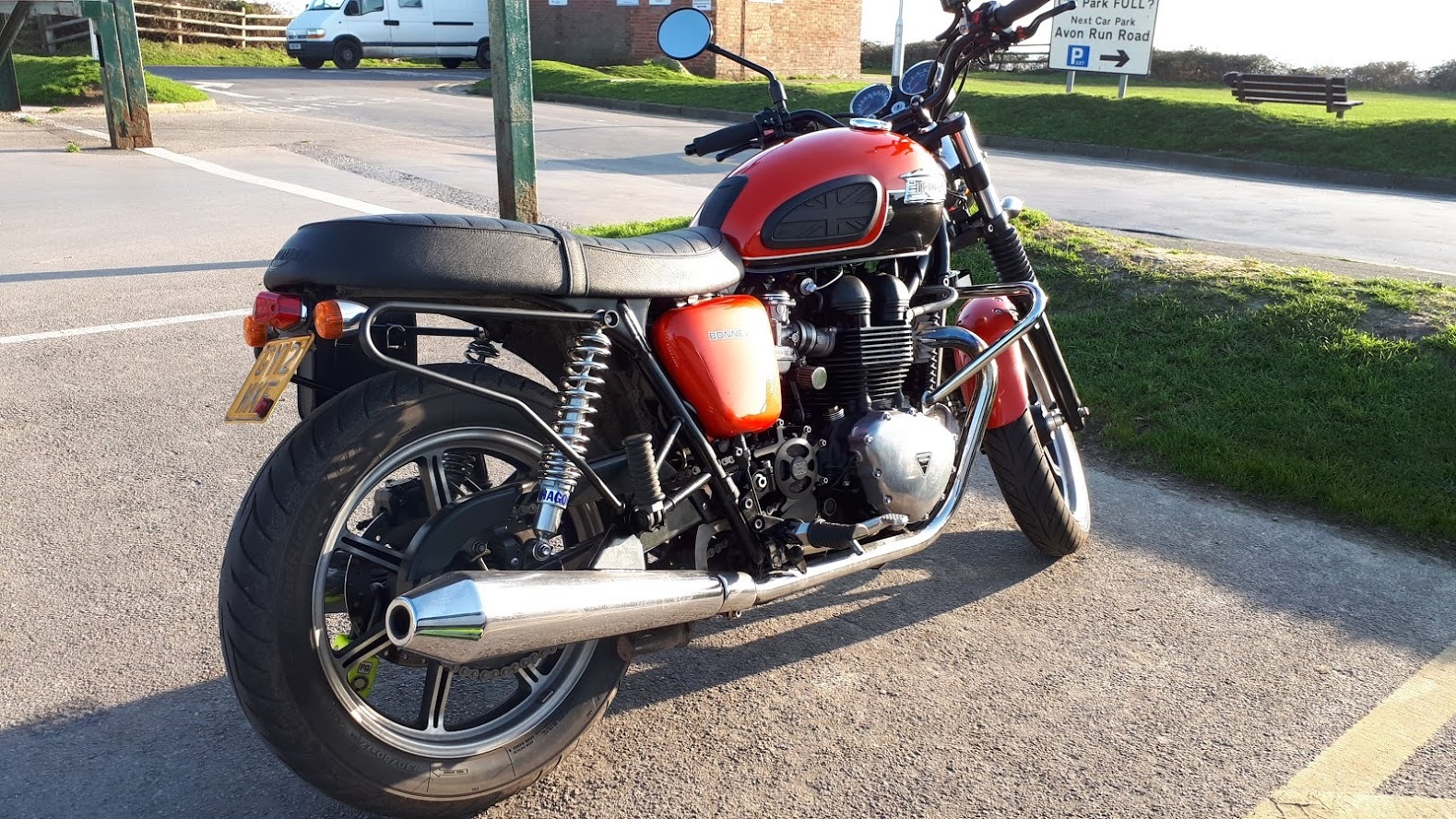

    Okay folks, I got the Tec rails (thanks for the tip) and Lomo bags. All fitted and working nicely. I made a 400 mile round trip to see me Mam in East Yorkshire and only thing I can complain about was I packed too lightly. These bags are huge and will be be ample for a few weeks away. Bit fiddly fastening them on, had to make sure no loose ends as I only used the supplied straps (I may get some security straps. Here's some pics below. I'll let you know how they are in a month or so but so far very pleased. Affordable, good quality/ well made. Only down side is now I have storage space I've been sent to the supermarket a few times to stock up, think I'll take the bags off until I'm ready to ride out.
