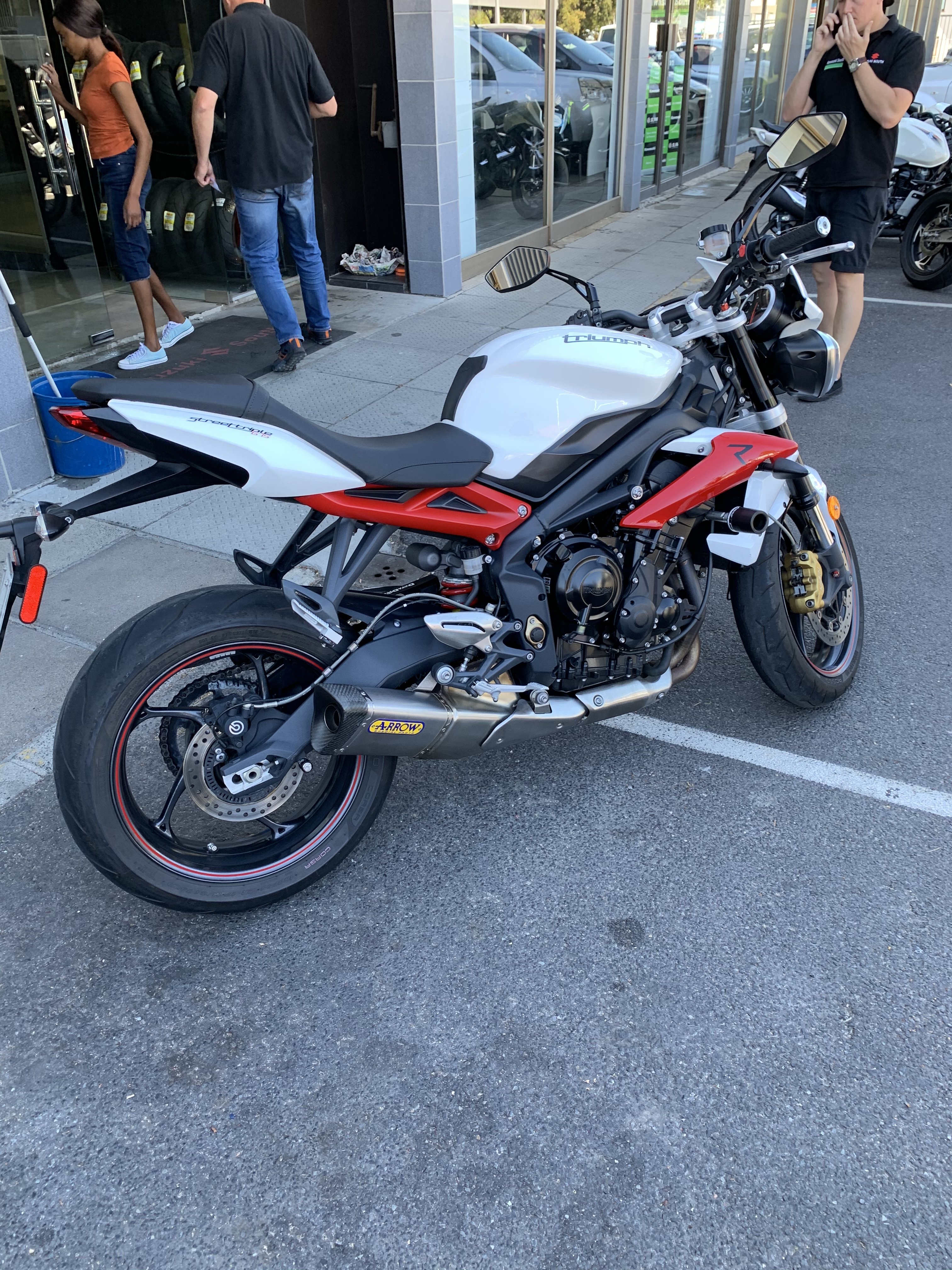

  4. joe mc donald
    16,072
    Alex Flay
    Welcome to the family. Do hit the upload a file button bottom right corner and let the inmates see the steed. Like Yorkshire man said that seems to be the norm. If you are a fast rider drop a couple of pounds in each tyre. Gives better grip and as the tyre heats up it comes back to normal.

  5. Alex Flay
    Alex Flay New Member
    Dec 8, 2019
    17
    Cape Town

  9. joe mc donald
    16,072
    Alex Flay.
    Real cool machine. thanks for sharing the pictures.
