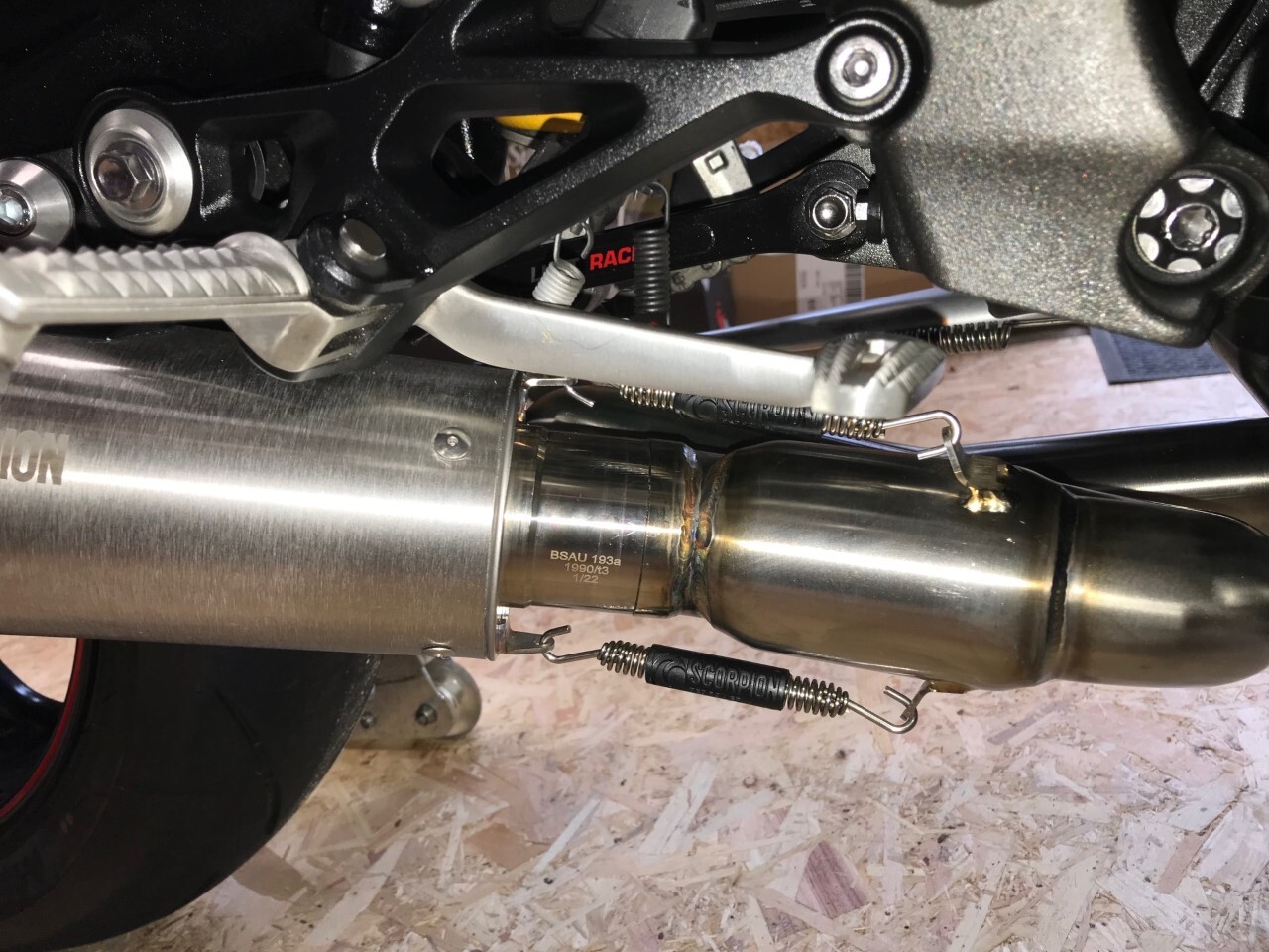

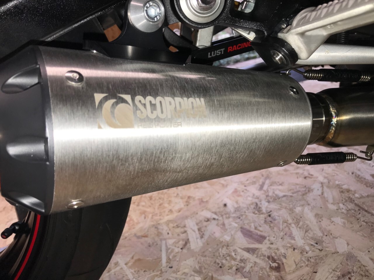

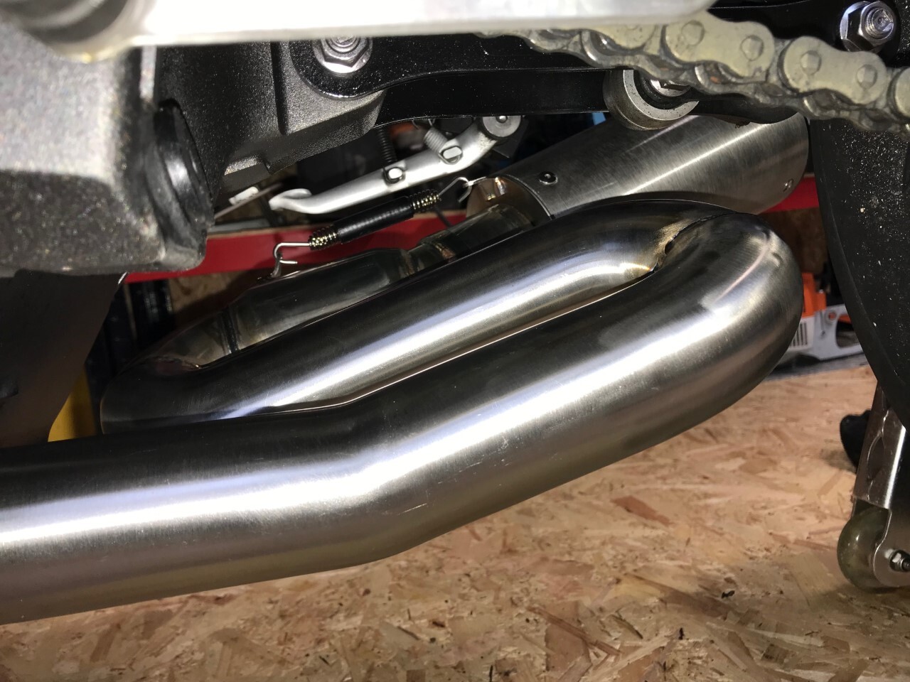

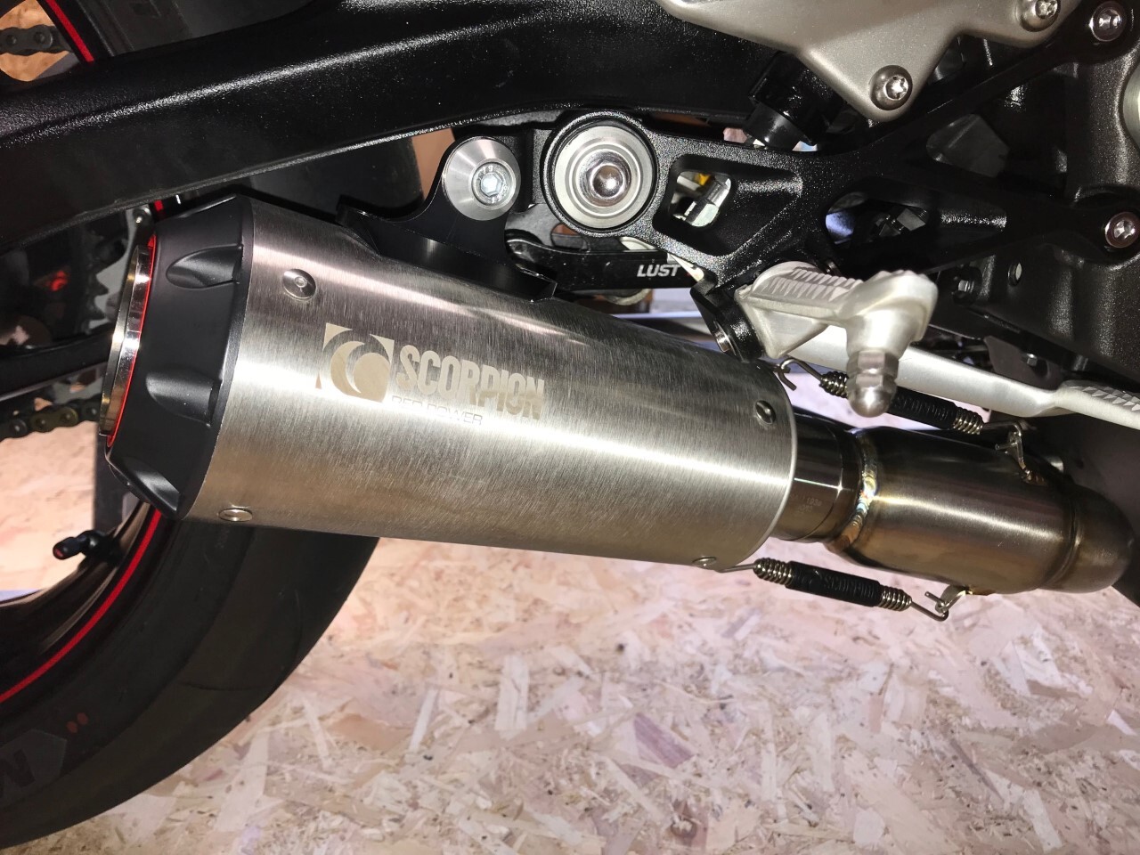

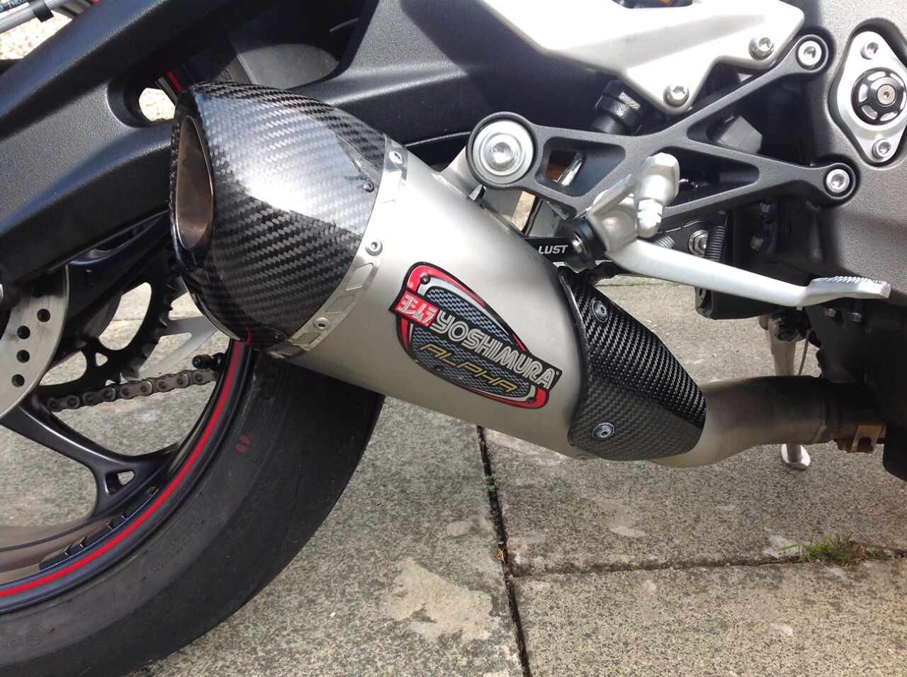

    I decided to have a change of exhaust on my 2020 STRS, I removed the original factory exhaust and fitted a Yoshimura when I bought the bike new in 2020. I just fancied another change, and having looked at various aftermarket systems and more importantly the build quality, after weighing everything up I elected to buy a Scorpion, the build quality and finish is excellent, in my opinion it is built better than the Yoshimura, it weighs a little more, however that said it has an S shaped link pipe that really sets it off, the material is a thicker gauge, the removable baffle allen bolt is a lot easier to to access that the Yoshimura, it was also £300 cheaper, all in all I am more than happy with the new system, and it sounds good, though I have yet to test it out on the road.

    Good choice and a nicer looking pipe than the Yoshi :cool:

    I definitely prefer the aesthetics of the new Scorpion, @Iceman. I've always fancied those exterior spring thingies. That's a technical term. ;):joy::joy::joy: What would those be called? Hope you're as happy with the new system on the road as you are with all the improvements you described.

    I had the Yoshi on mine, but that does look good.

    Retention springs.
    Allows flexibility resulting in less stress, which with heat cycling adding to the mix leading to expansion and contraction, reduces the chance of cracking.

    Every day is a school day; knew the name, but no idea of the purpose!
