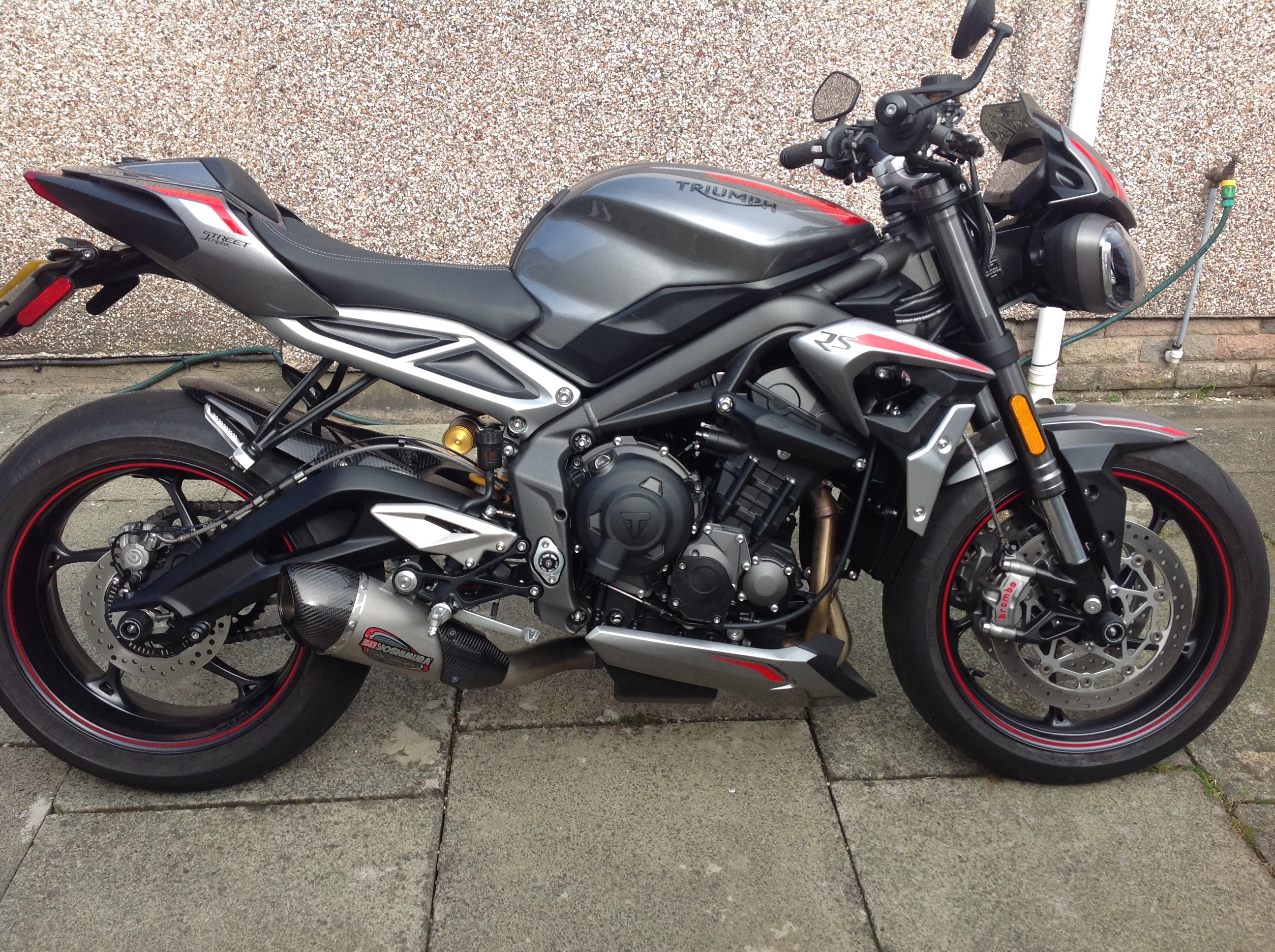

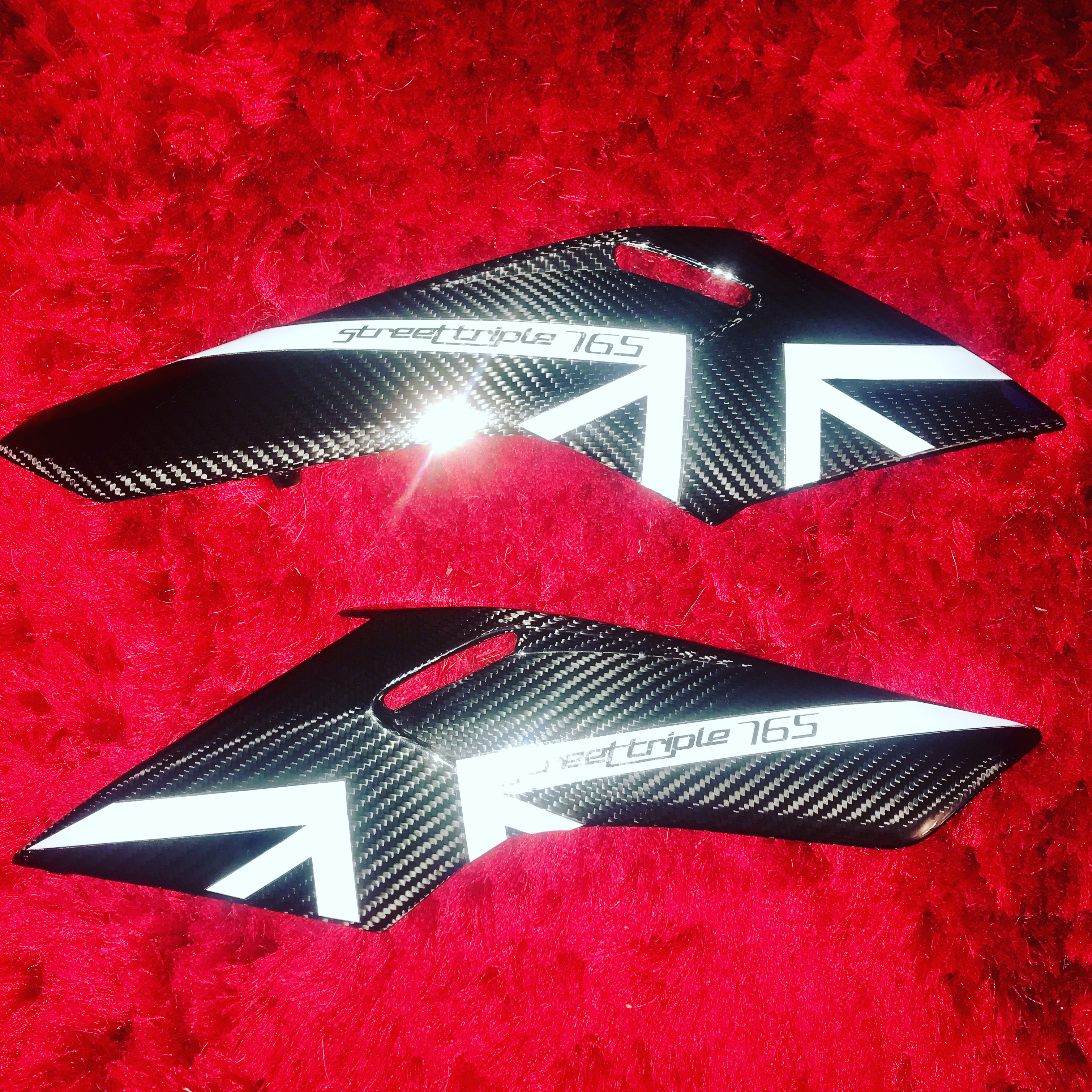

I’m having trouble uploading pics as it keeps saying the file is too large but I did manage this one of the belly pan before I fitted it. Have to give a big shout out to Carbon FBR, his stuff is awesome as is his customer service

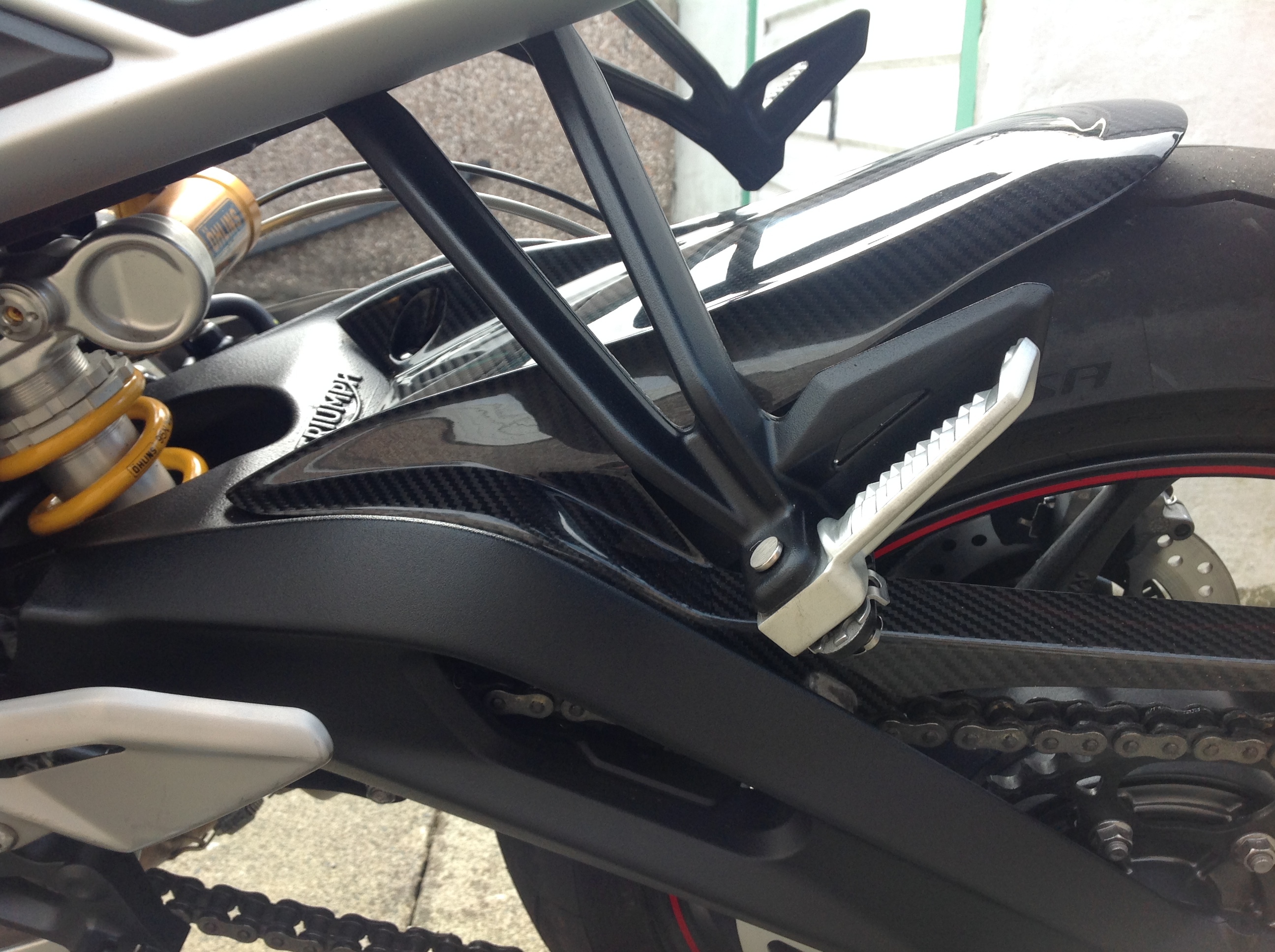

Yes CarbonFBR based in Scotland do great products, I bought an extended rear hugger from him a while back, his products fit spot on. looking at that belly pan has motivated me to order one
You can get 10% off if you enter CFBR2110 at the check out or it may be CFBR1021 .... anyway, one of those codes is right lol. It's worth it for over £20 off!! The decals were from Crispy Designs but word of warning, I queried whether they would fit before I ordered and was told yes but when they arrived they didn't, the reply to my further query was "they are not for aftermarket products only oem" which is rubbish as the belly pan is the same size. They come on a very thick sheet of vinyl which is rough cut to the size of the belly pan and would look rubbish stuck on as a whole. I cut all around the white pieces and custom fitted them myself. The end result was worth it if you don't mind the faff but I wouldn't order from him again tbh.

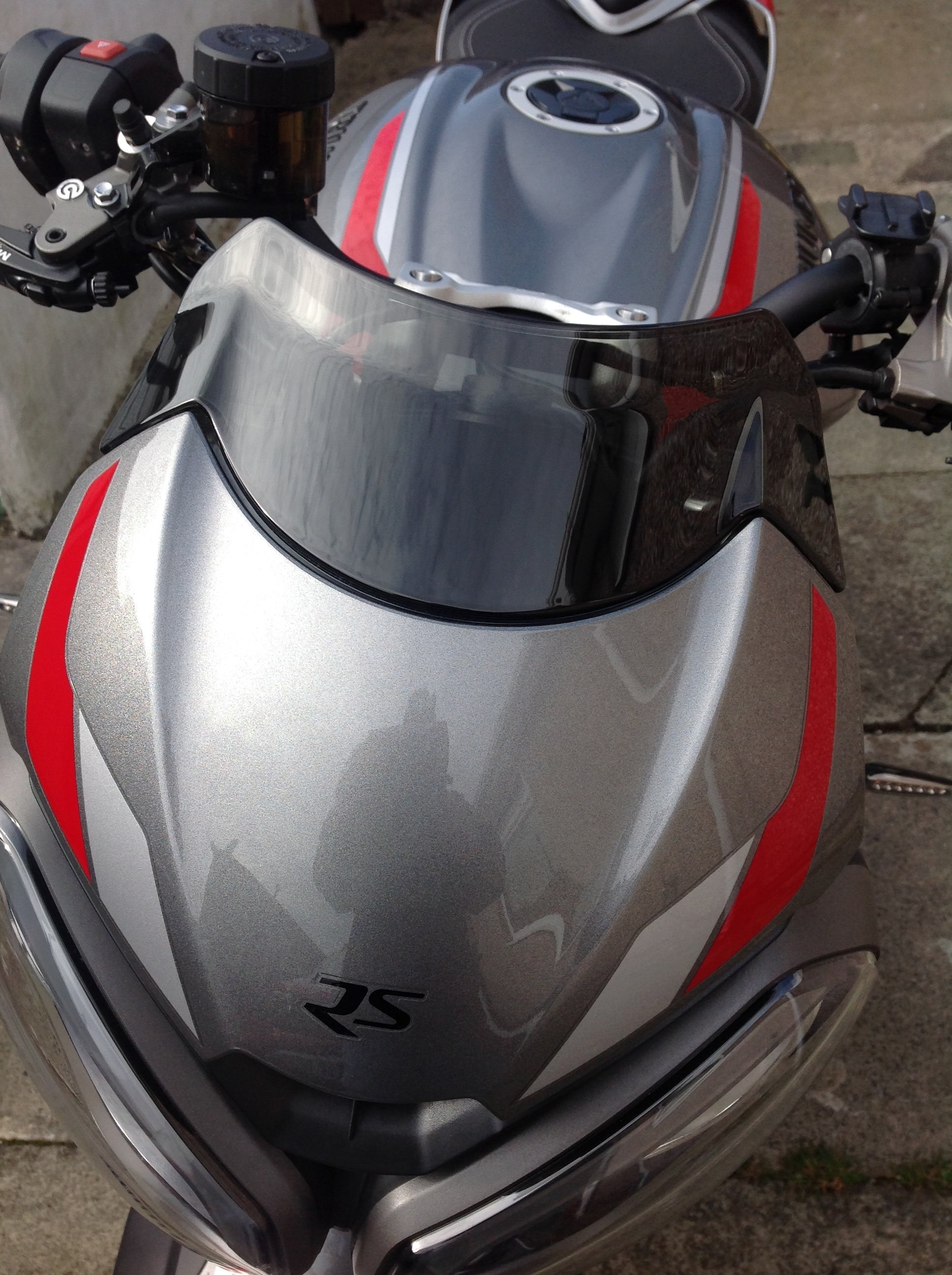

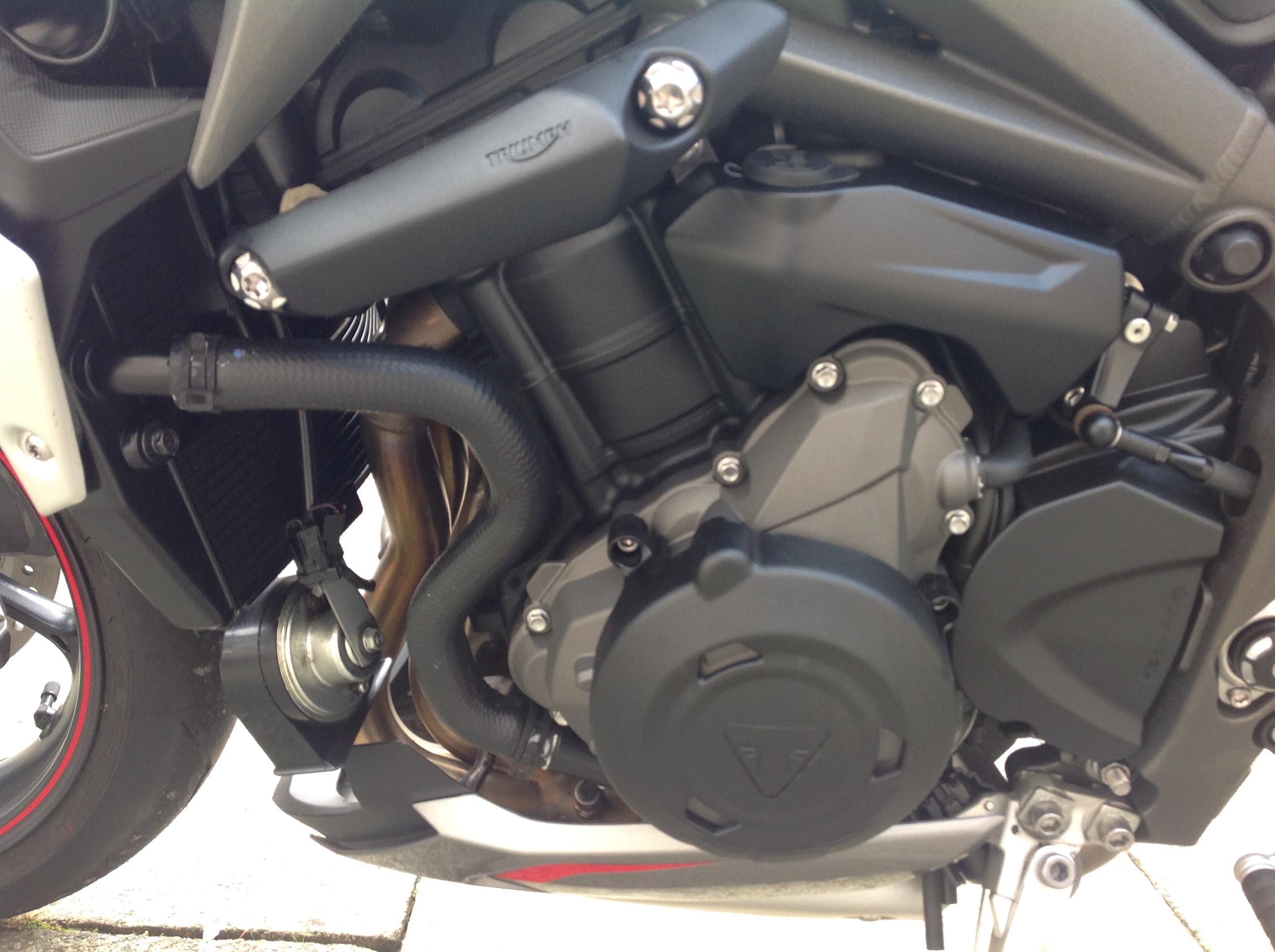

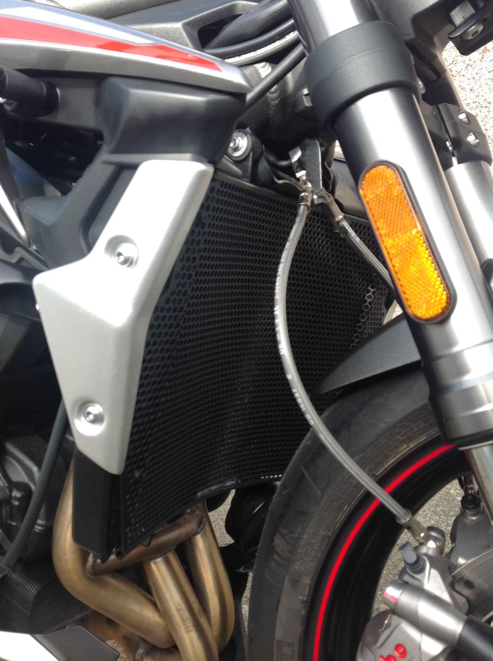

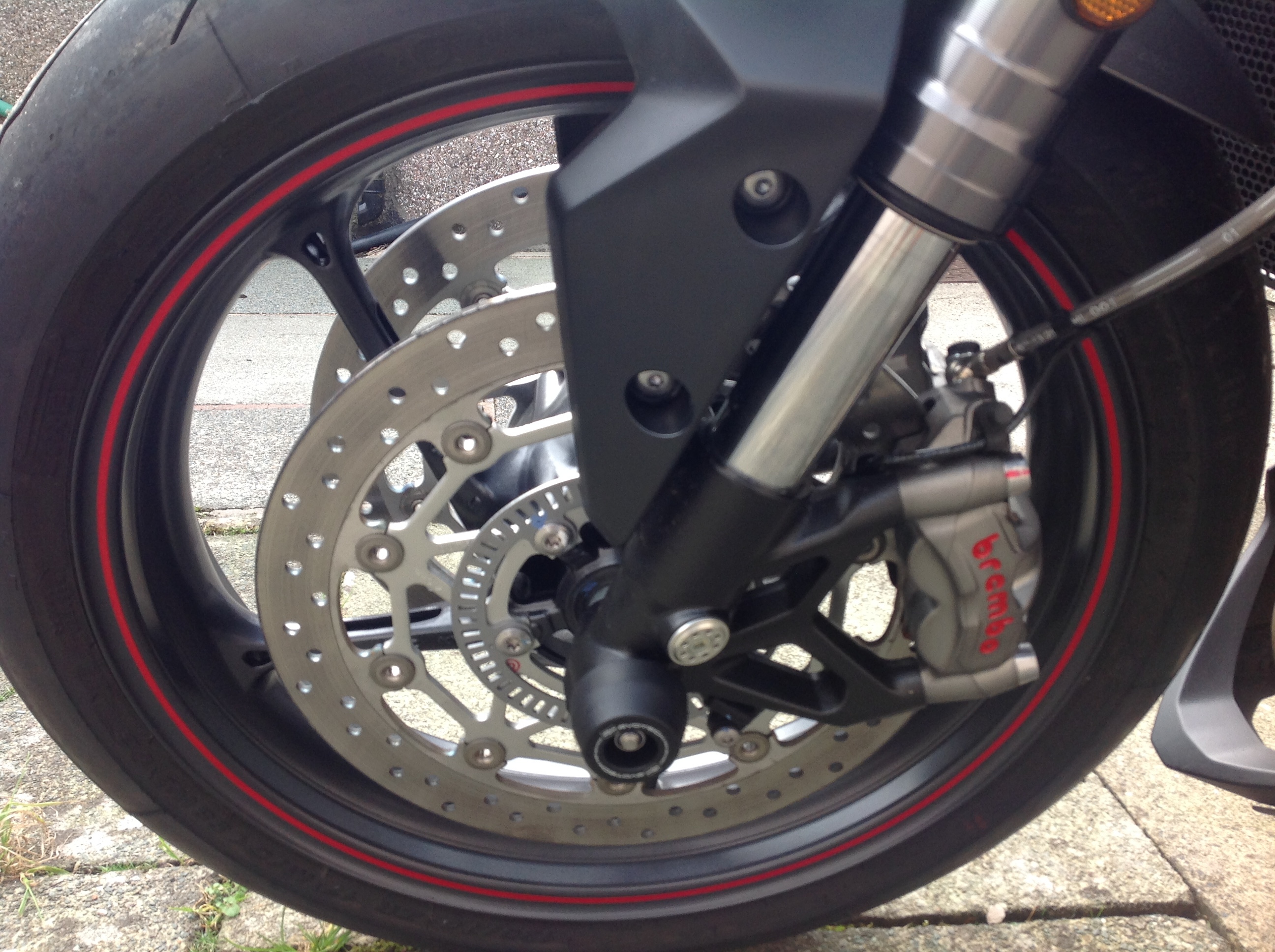

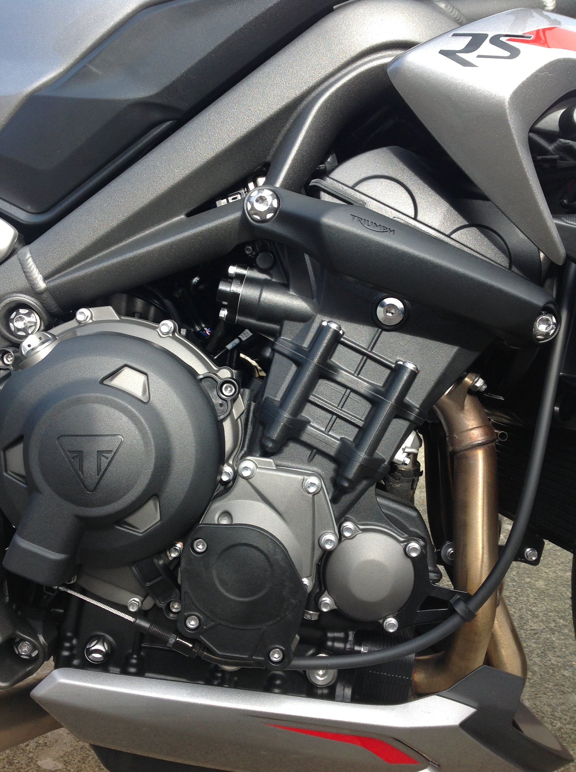

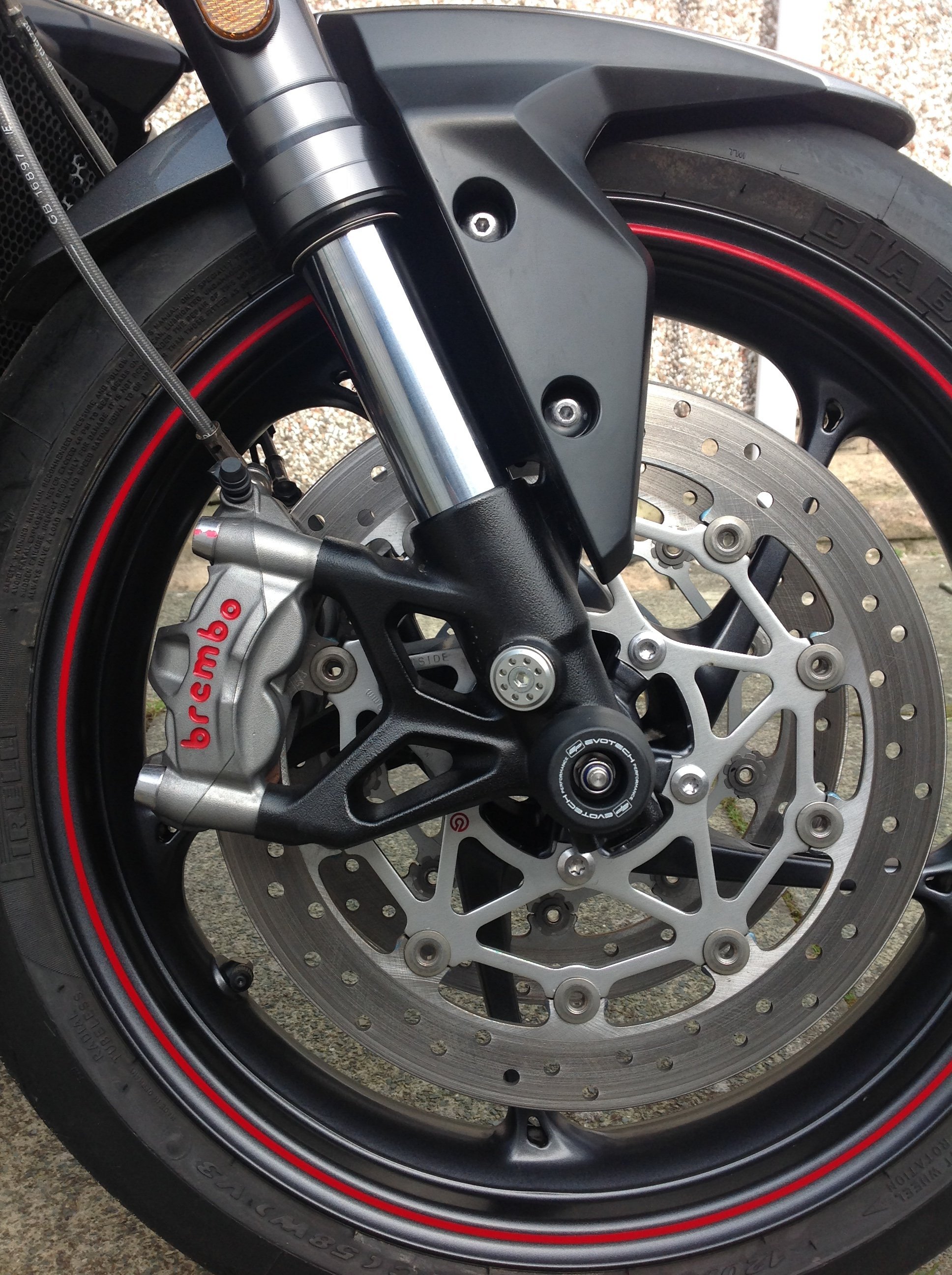

Very nice. I decided against the carbon hugger and chain guard as apparently there is a bolt behind the wheel you have to take out to fit it so I just bought an plain extender which looks fine to be fair. I also got cheaper crash protection but seeing your Evotech ones, they look so much better so I may have to upgrade! Is the flyscreen Triumph? That also looks better than the Powerbronze one I think but I'm not changing that again as some of those bolts were a nightmare to reach!! Apparently my rad cowls should be here tomorrow so when they're fitted I'll put some more pics on.
Hi Anne yes the flyscreen, engine cover protectors, tail tidy, crash protectors, paddock stand bobbins and heated grips are all Triumph items, Evotech supplied the front and rear bobbins and the radiator cover, the horn is a mini sound bomb, and the hugger from CarbonFBR, it also has the connectivity system, great with the Go Pro. You will have to post some pics when you have time.
