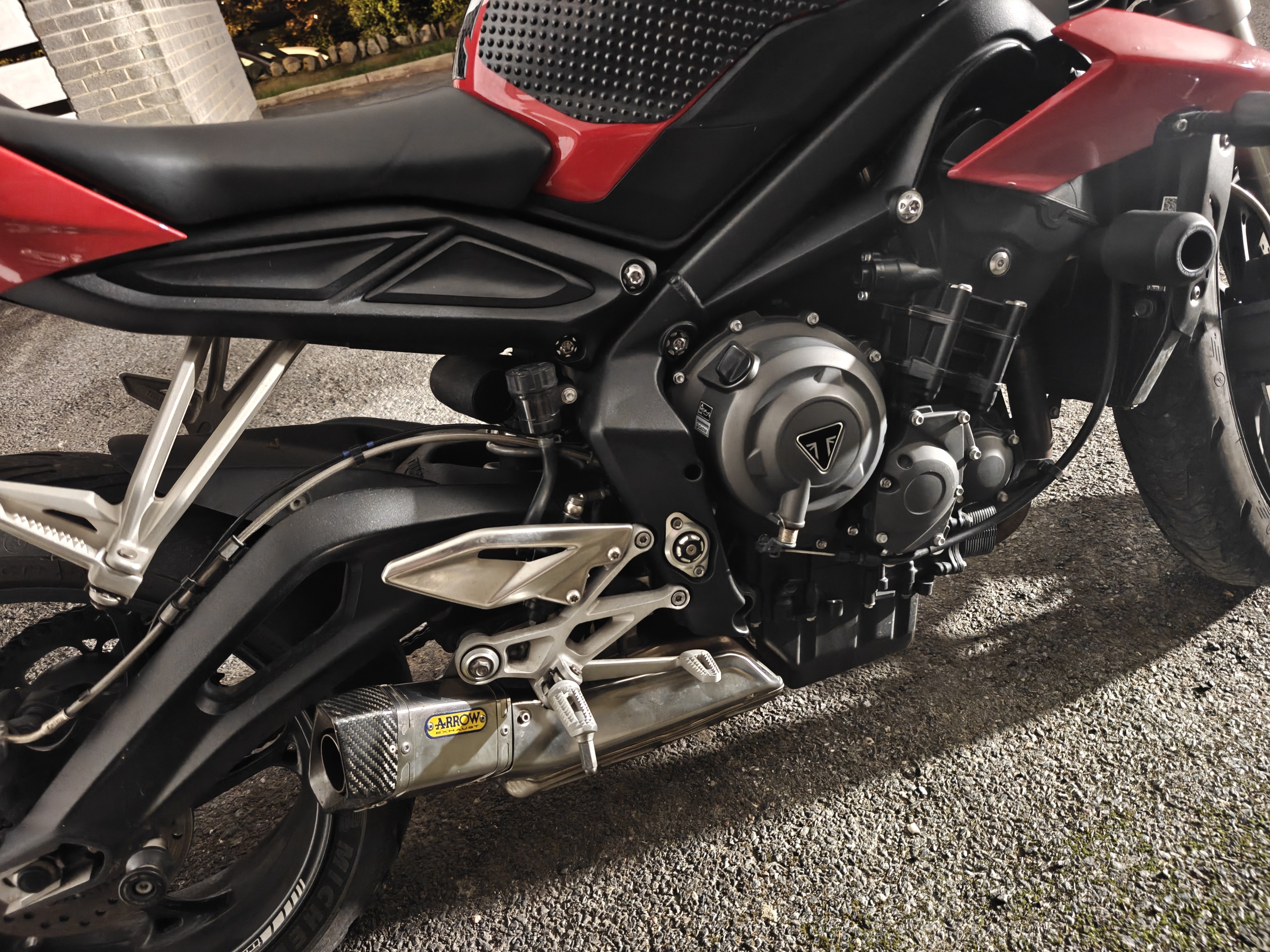

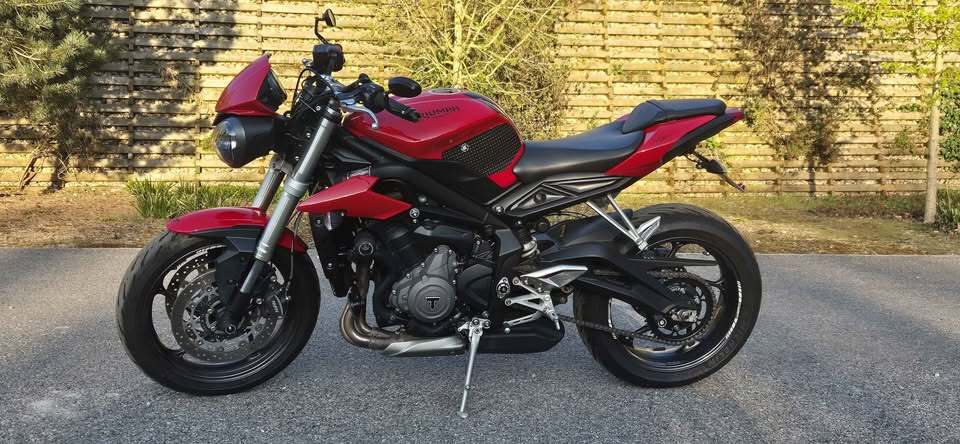

    I have added a picture of my bike to the original post... I also recently purchase the direct replacement Arrow exhaust for ~£200 from eBay, it is the EU version with non-removable baffle. Definitely makes a difference in the performance the way power is delivered... sound etc
  10. jimbobaggies
    jimbobaggies New Member
    Nov 13, 2025
    12
    Devon
    And now with added photo of Arrow exhaust
