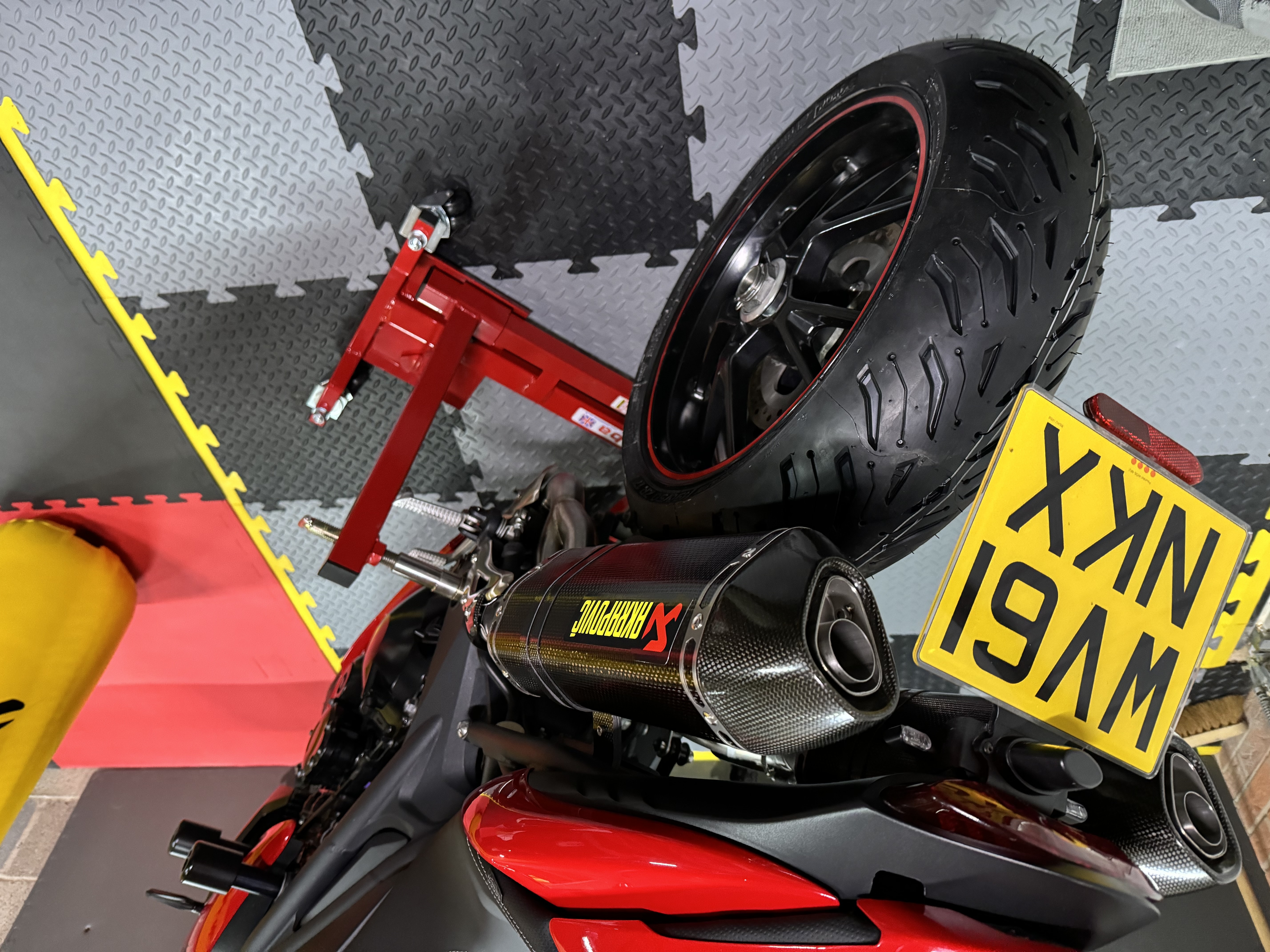

    I had Michelin Road 6 on my speed triple 1050 last year, and the plan is to put these on when i need to change the tyres on my 24 RS, they are great tyres, just need a little warming up in winter,

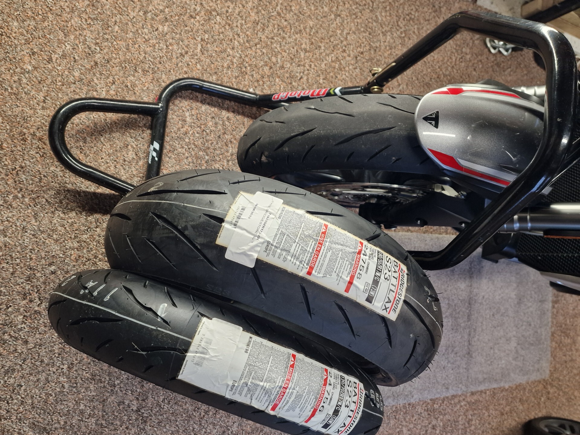

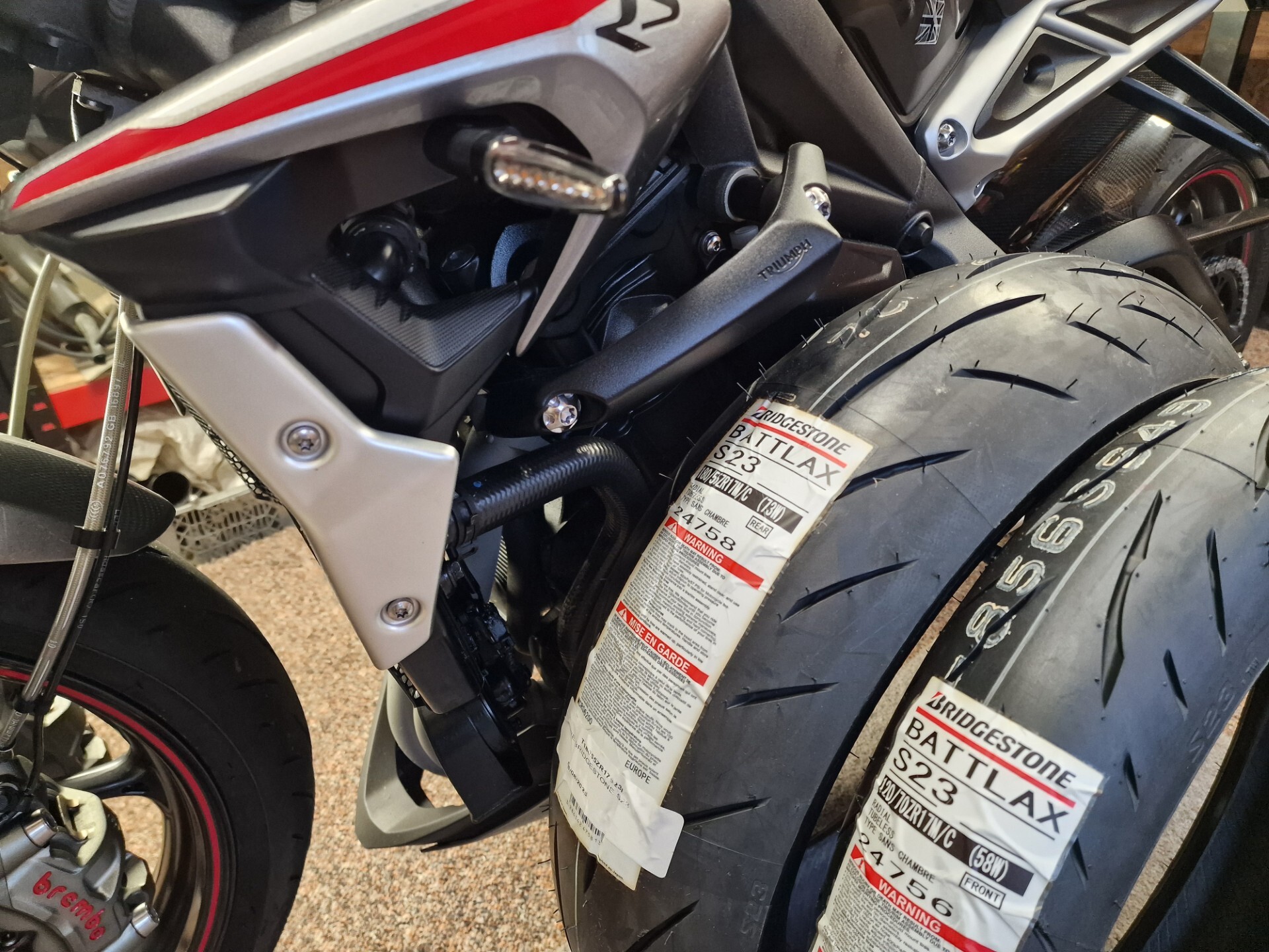

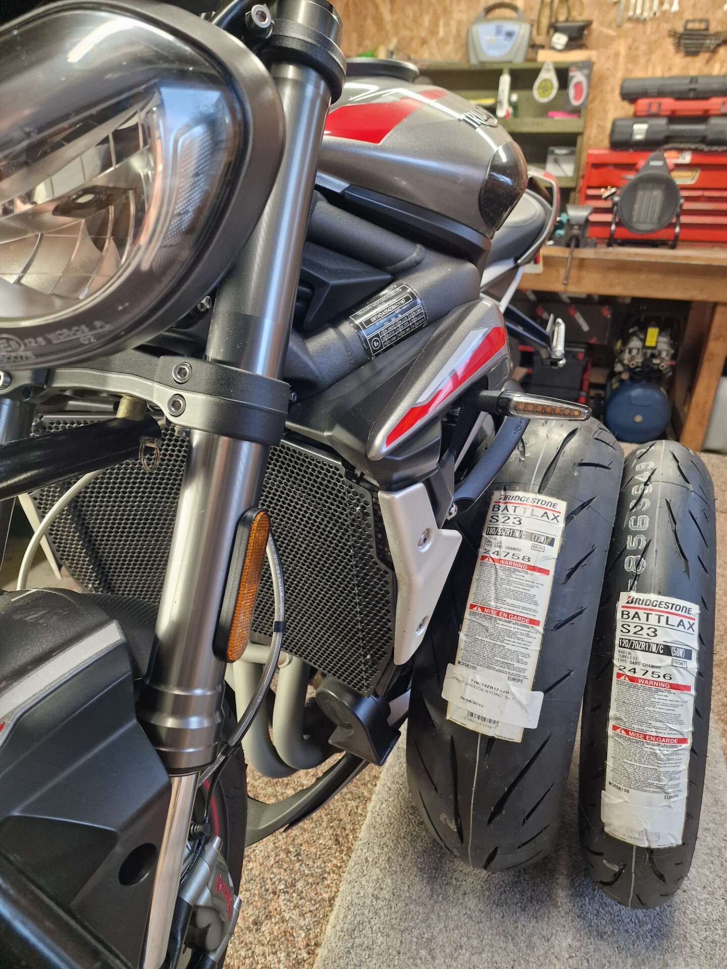

    Personally, I would only fit a rear tyre of the same make and type, don't mix 2 different makes or profiles, the 765 models need a suitable tyre and a lot depends on your riding style and intended use. Delamination is serious and not something usually seen on 765 STs, do you mean the tyre is down to the carcass rather than delamination, either way a new set is definitely in order. I am putting a new pair on my own STRS 765 this week, and am replacing them with identical Bridgestone S23s. The current tyres on your bike are a strange choice for such a bike, but if they suited you and the bike that's good. Ride safe with whatever tyres you choose.
