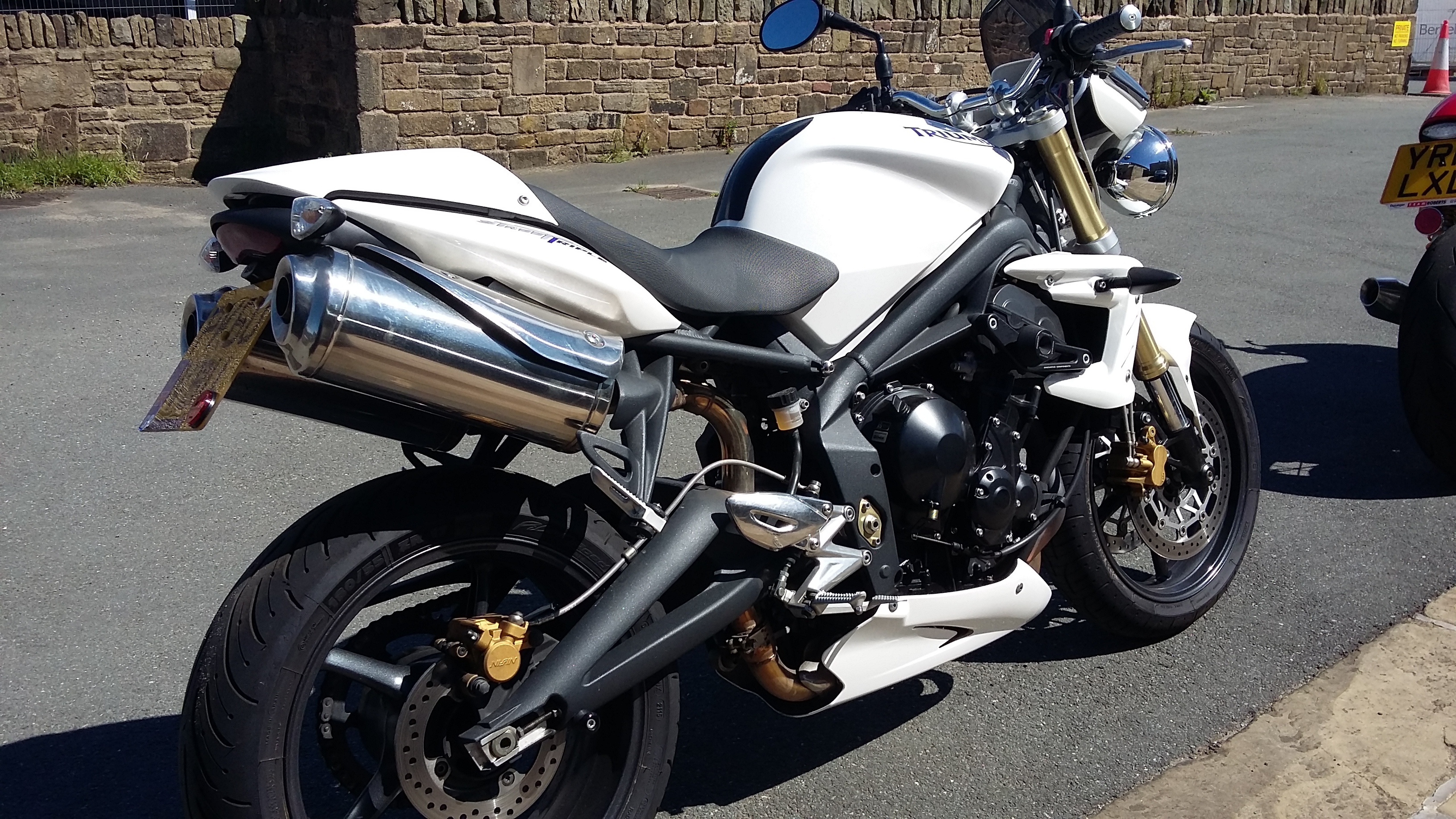

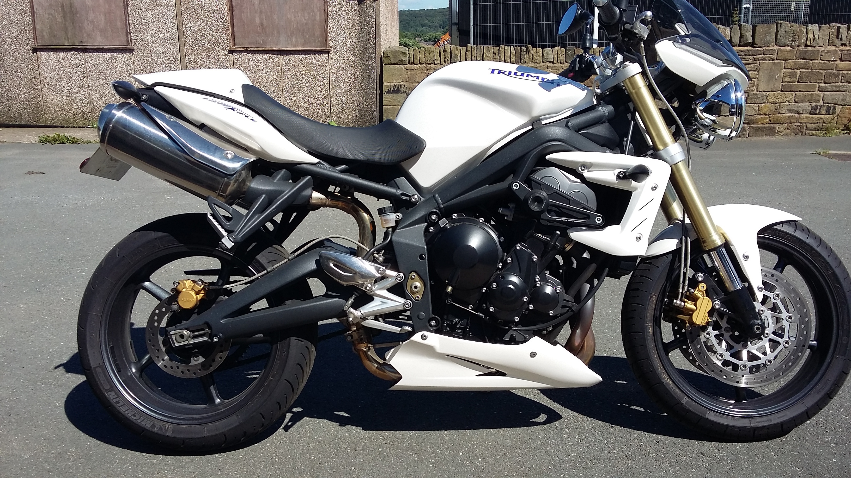

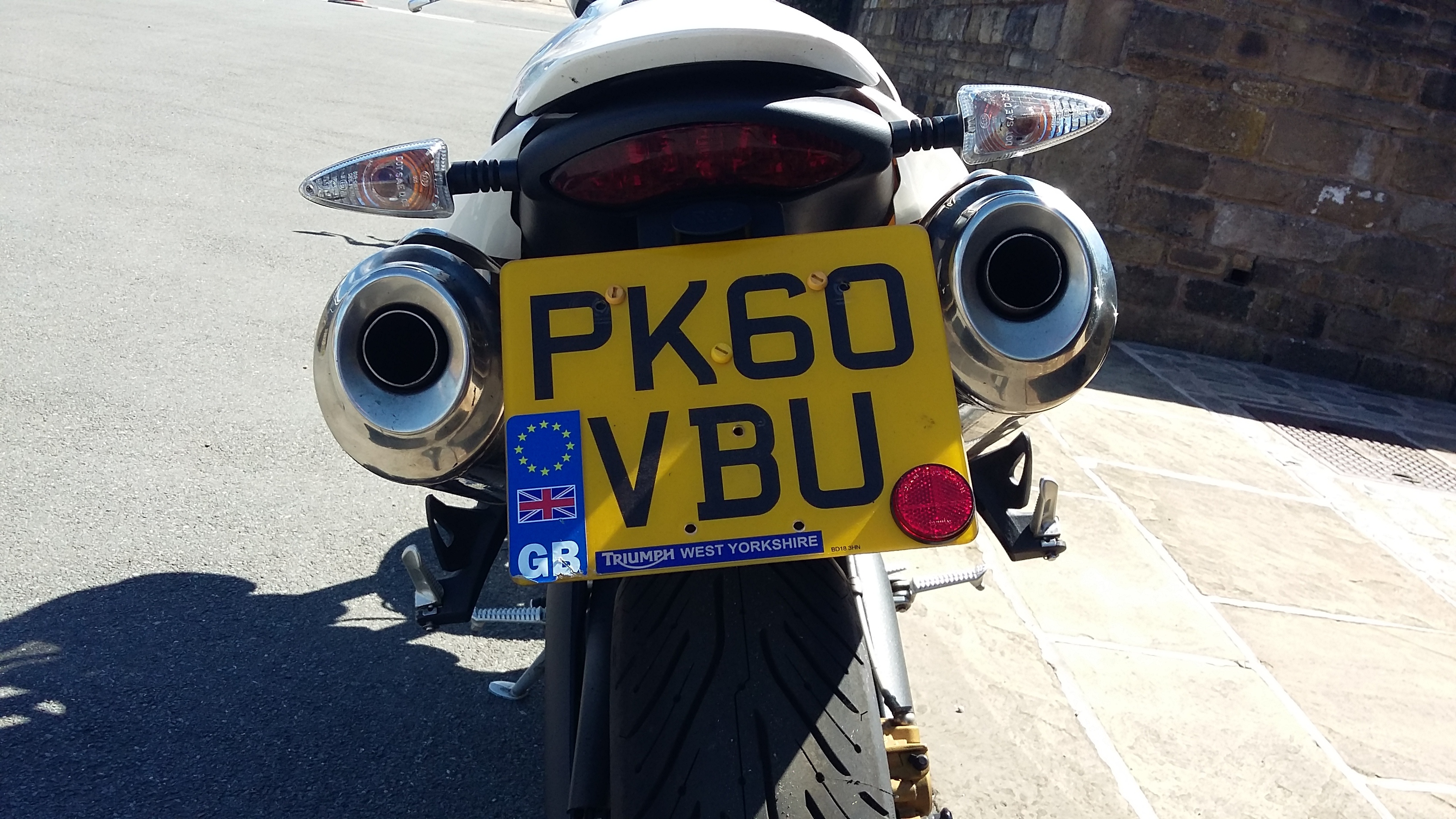

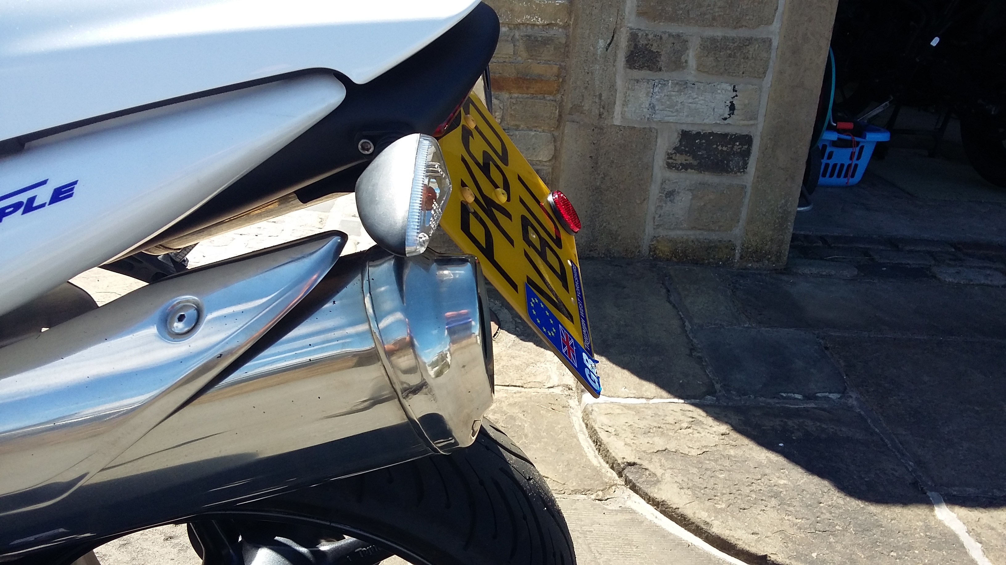

    Finally took the plunge and fitted the R & G tail tidy, including the spacers for the silencers, which are standard. Have also used the standard indicators and all worked pretty well. I'm not the world's best at electrics but wiring up the number plate light, tail light and indicators was easy.
    The spacers for the silencers were OK but the silencer brackets needed a little judicious bending. I have re-used the standard number plate which is 240 mms wide and now there is about a 1 cm gap from the number plate to the silencers so all should be good! Thanks all for your help.
