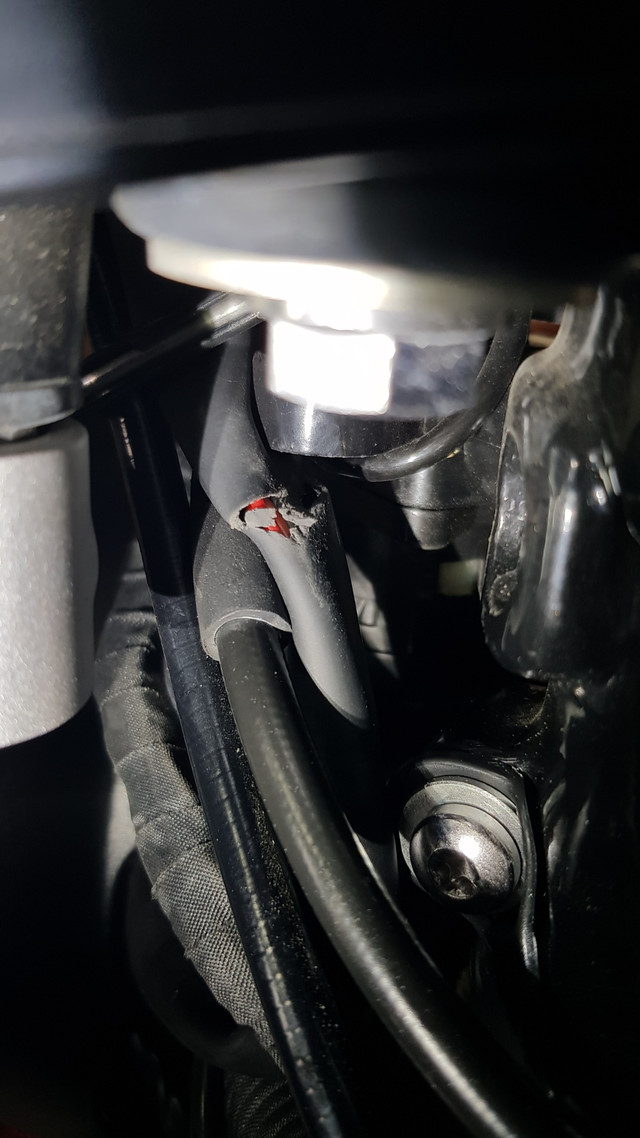

    SS, when you turn the handlebar to RIGHT, press and will cut the sleve and internal wire cables. You will notice that the LH control cable have some play if you turn to left, center, but not to right, and that´s the issue. With km´s you will get damage (and if you turn to right handlebar usually, ie, every time you get the bike to leave garage, ie)
    It´s a bad design (again) and routing. The brake and clutch cable will press and cut (even the brake line, in the rubber protector will be marked too, or cutted, with the key plastic touching under it)
    check your, if you have marked where it will break, or if it´s yet broken, or if you get the internal wires damaged.

    2019 model and 2400 miles. It has cut through in the exact same spot. down to seeing the wires inside the harness.

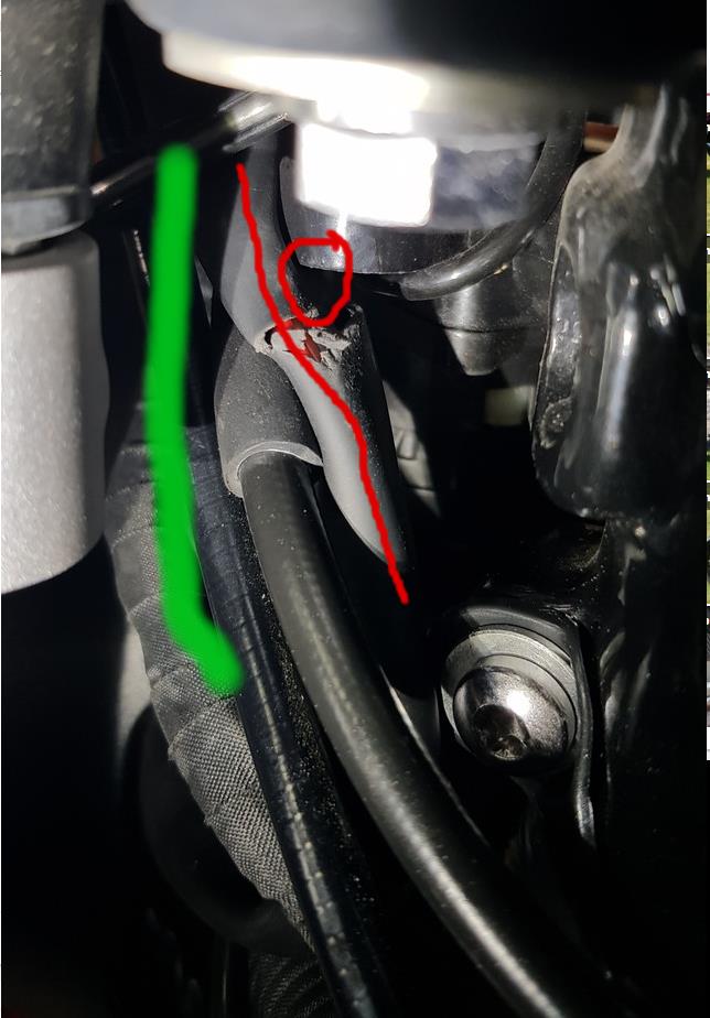

    THERE IS AN ISSUE, and all 2019-2020 bikes have it. In fact, 2021 model IS ROUTED IN DIFFERENT WAY. I´m not refering to the headstock main wire loom, this is absolutely differente, only the LH control lights cable to the headstock... now it´s router OVER the brake line (this is causing damage pressing it, because it´s under, to the metal).
    look here new 2021 solution. and now... what are they doing for actual bikes? maybe wait damage when you get 10.000km or more... because these bikes has very low milleage. They must recall ALL BIKES and change the route. They know it and know the failure.
  11. Walko
    Walko Member
    Nov 19, 2020
    6
    World
    red... actual WRONG route, all with contact when turn handlebar to right (red cable PRESSED and damaging, free with handlebar center or left).... and surprise... NOW, new route for 2021 models... green, out of the issue.
    now is time to solve the issue in ALL BIKES with a recall... or simply wait to it happens to you, and maybe electronic failures, doesn´t start... and you have to pay a new LH lights control about 300 euros with the cable. Now I´m waiting to replace the part (no parts avaliable... great triumph), but if my bike was ok, fast I would remove the actual position and move to the new.
    more clears, this is where the issue happen, or will happen, move your handlebar to right and check if this happen, that´s were is cutting and damaging (only with handlebar to right)
    and now the cable in 2021 model goes there (reasonable, I hope this time they checked it solve it... but even that, check WELL the rubber over the brake line and maybe you will notice cuttings, but ok, brake line is metal and is only the protector.
