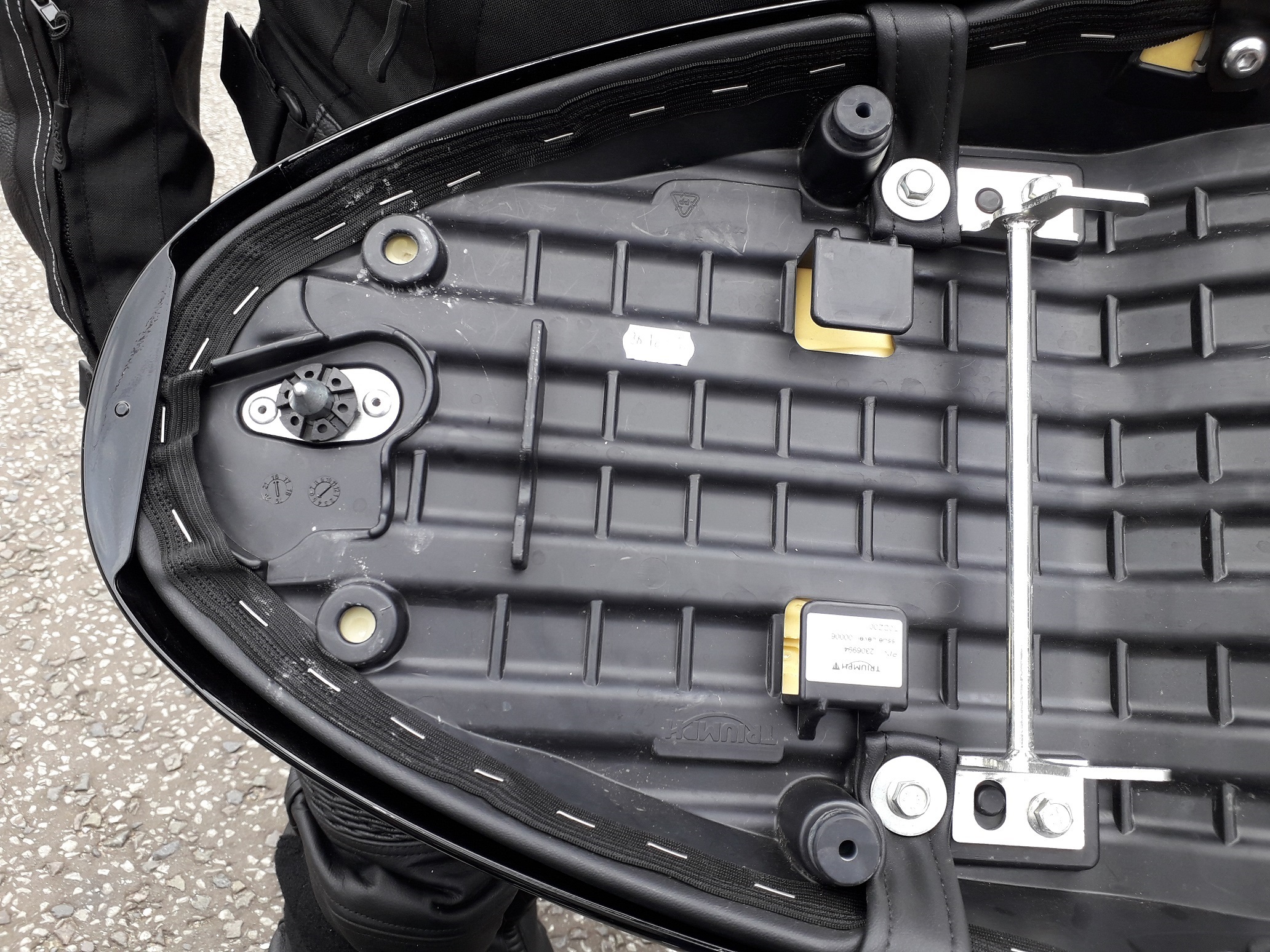

    Triumph don't do a luggage rack accessory for the Street Cup, but with a little adjustment, the one for the Street Twin fits a treat. The fittings and frame location are exactly the same. You just need to remove the two rubber bungs at the back of the seat. The customer who I sold the idea to reckons it makes no difference to the ride comfort one up. No idea if it would affect the comfort of any pillion, but who cares anyway ;).

    That’s interesting. So it’s just the two rearmost rubber stops that had to be removed? and did they have to be cut off or unclipped somehow?
  3. Yorkshireman
    3,401
    They are just a push fit, a large flat blade screwdriver or a blunt knife will bring it out.

    Thanks nice and simple then. :)
  5. Yorkshireman
    3,401
    Yep, just keep yer fingers clear while prising it off, I accept no responsibility for slashed/mutilated digits :eek:
