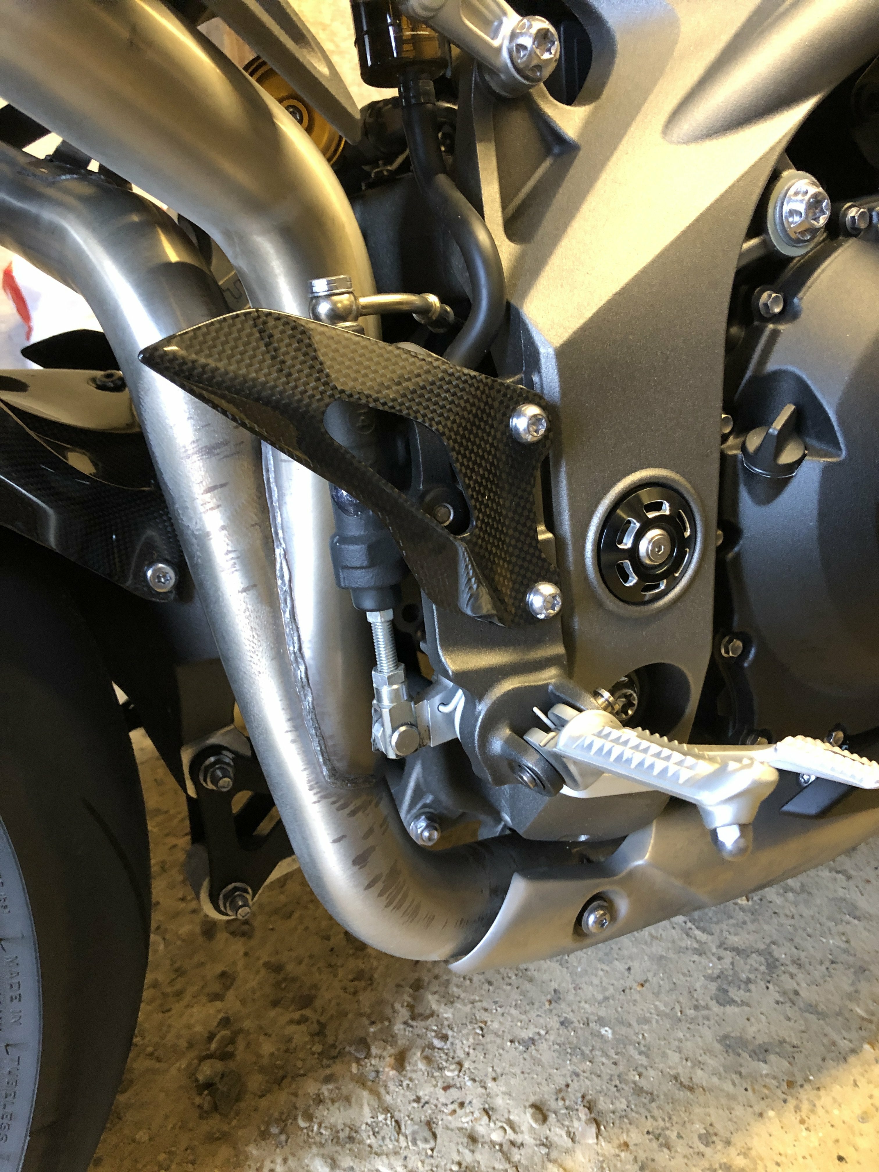

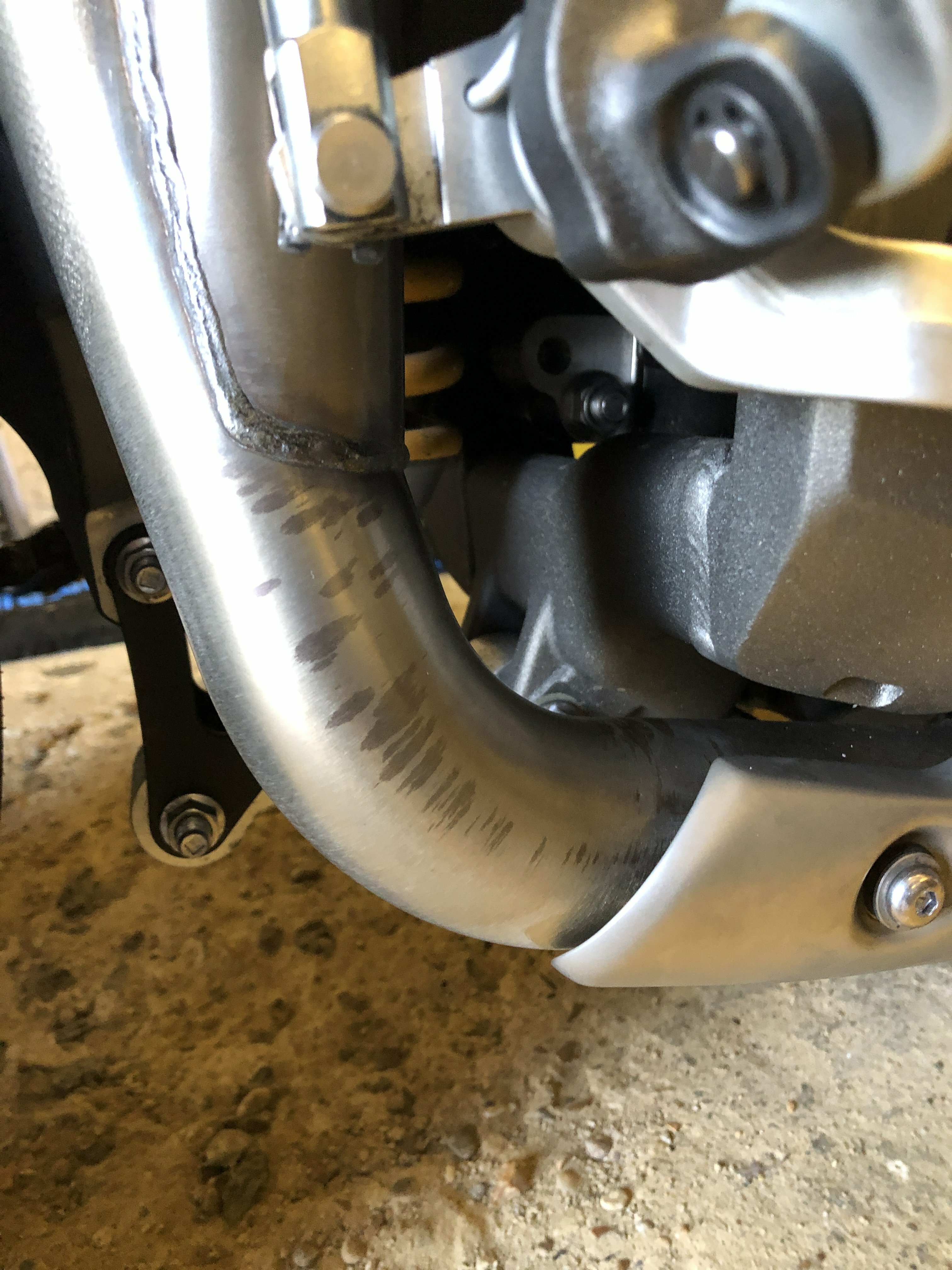

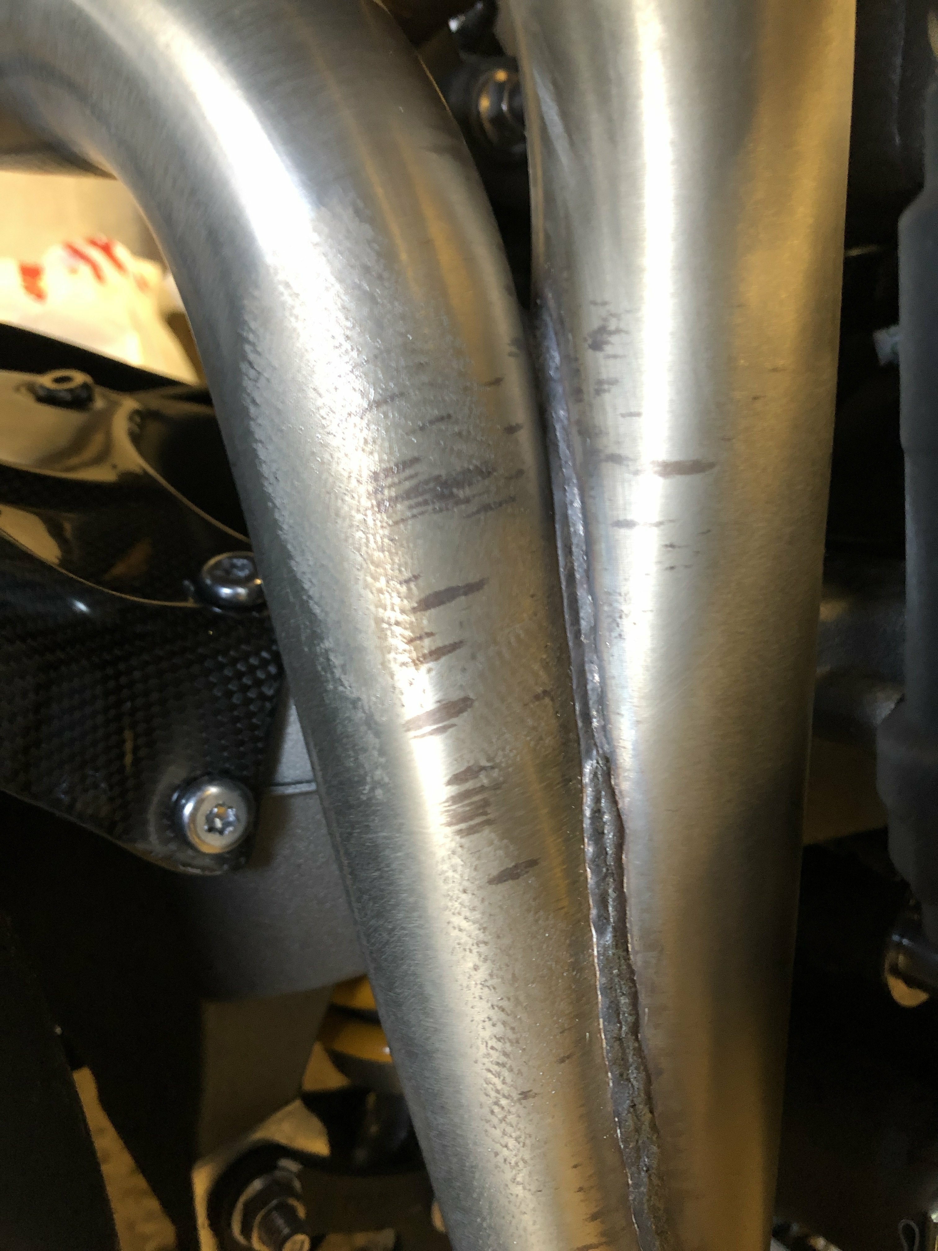

    Speed RS bought brand new and done about 1,500 miles. Put it away for the winter with no problems but this strange pattern has appeared on the exhaust pipe. It looks like it’s been sprayed with something but it won’t wipe off or polish off.
    Anyone seen this before?

    When you say it won't polish off, what polish have you tried?
    Solvol Autosol usually works well but try it somewhere out of sight to prove it's suitability.
    Do you have any overflow or breather pipes feeding into the air stream in that area?
    I have seen a similar pattern from a coolant bottle overflow when the motor is revved hard.
    Stainless steel is not corrosion free and some chemicals will stain or etch the surface.

    I’ve tried autosol but had no affect whatsoever. The bikes been sat there since November and not ridden although I did fire it up just before I noticed the marks and let it run for a bit so will check for any overflow pipes around that area!!
    I have let it run loads of times before but never had an issue!!

    I am assuming these pipes are Stainless steel but it comes in many grades. One of the correct grades for exhausts is 321 but often pipes are made from the more common, i.e. cheaper 304 grade. Your standard takeaway extraction hoods are from 430 grade. To look at they are both visually simar but the Nickel content (amongst other alloys) is massively different which will affect it's corrosion resistant.
    Hydroflouric acid would bring the staining off but I'm not sure the resulting appearance would be pleasing. This is very nasty stuff, read up on HF acid burns, eats bone, so I am not suggesting you try it.

    I've used Cillit Bang (really) on mine in the past with great success - but Harpic Power Plus contains 9% Hydrochloric Acid and is highly likely to get those marks off.
    Just make sure you wash it off thoroughly :)

    May I suggest that these marks may be as a result of pipe bending clamps during the manufacturing process?

    Mine looks the same. There aren’t any overflow pipes in that area, they are on the other side under the side stand. Can’t remember when it first appeared. I use fine wire wool, the sort plumbers use, and solvol. It doesn’t completely remove it but it does look better after a good polish.

    Just another thought - I only tried the Cillit Bang trick once (which was enough) and wouldn't want to use it too often.
    For preventative maintenance, I regulalry use a microfibre to apply ACF-50 to the pipes and cans, which does a brilliant job of helping to prevent further tarnishing. It smokes for a 30 seconds when you first start the bike, but that's nothing to worry about (even if it looks alarming) :)
    The ACF-50 causes a very (very) slight straw colouration, but it's even and not particulalry noticeable. There were some spots on my downpipes that the Cillit Bang didn't remove...but they eventually disappeared completely after a few applications of ACF-50 over time.
    I've found that applying a polish (I use Peek metal polish in a tin) has the same yellowing effect. If you do use polish, go easy or use wire wool as others have suggested, to prevent shiny patches.

    Dont leave the Hapic on for too long. You have been warned.

    Pretty much what it does to a stainless steel sink - it removes tarnishing and rust spots, presumably by eating it away (hence not leaving it on for too long).
    I wouldn't use it as a regular treatment, but given that using a polish also removes metal, I don't see it as particularly aggressive.
    I've used it once and my pipes are still there. It's not like the caustic Alien blood you see in the films ;)

    It will change, dull ,the finish on Stainless Steel.Its acid. Edit it works well just was off and dont leave too long.

    I’ve had god results with wet and dry on the pipes, gets rid of marks and bring it back to shiny silver

    Triple is right though, if you do use a stainless polisher get it off quick and don’t use it regularly. It eats the steel along with the stains. And don’t get it on the plastic bits or engine coatings.
