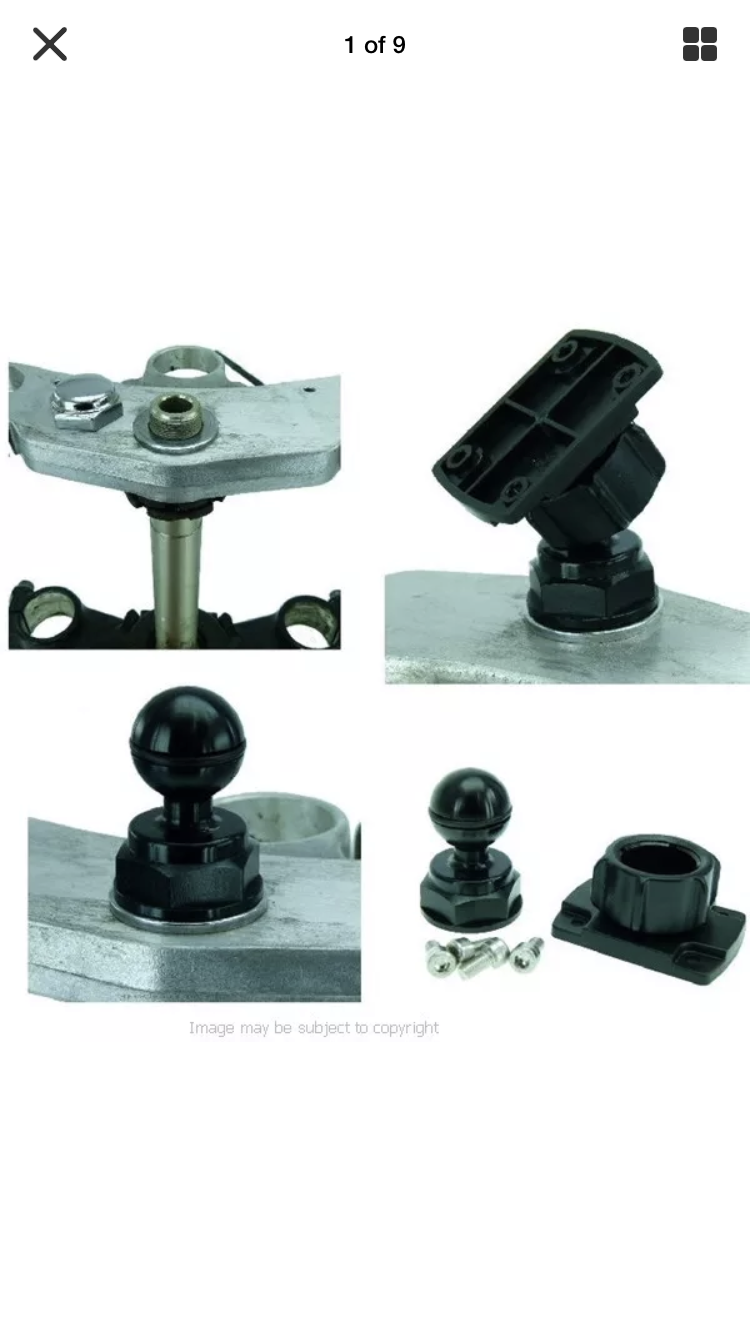

    Does anyone know what thread the stem nut is on the thruxton r? I want something like this to mount my sat nav.
    The ones I’ve seen listed on eBay, only list the thruxton and not the thruxton r, and none of them know what thread the r is.
    Spoke to dealer and he reckoned it’s M25 but doesn't know the pitch.
    The bonneville and thruxton are listed as M22x1.5 pitch

    Hi Andy,
    Thanks for that. Just need to see if they do the correct size for it now then o_O
    I thought the pitch would’ve been at least 1.5mm, the same as the M22x1.5mm on the bonneville and thruxton

    hi, you can drill the oem top nut, tap new thread a fit a ram ball thats what i am doing . or buy a new top nut £12ish and do it to that way and have spare
    top nut torque 90nm
