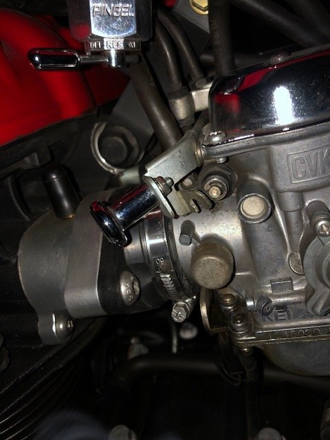

    Hello all,
    I am a brand new Rider and I purchased a well maintained, garage kept 07 bonnie (carbed) recently. I rode it 400+ miles and it started and ran perfectly. Last evening, I did a slow tight u turn at the top of a street on a hill and dropped it onto it's left side. I dont have engine guards but the only thing that was damaged, oddly enough, was the choke knob. It was pushed a bit to the left, disconnecting the knob from the actual choke. Bummer.
    However, after picking it up and parking it, I was able to start it again no problem after about 20 minutes to get myself home. I parked the bike at my house, there was a minor bit of rain, I cleaned and wiped everything down and covered it for the night.
    Today I have had issues starting it, and keeping it running.
    1) I can still utilize the choke by pulling it out with my fingers/nails
    2) The battery seems to have been drained by leaving the USB battery tender plugged in for the past few days
    I am charging it currently with a Noco Genius G1100 trickle charger, it took 4 hours or so for it to go from 25%-a blinking 50%. I tried starting it at blinking 50% and it started with the choke out idling at 1000 rpms. after 20-30 seconds i gave it gas, the exhaust popped and it died.
    I am curious if the drop messed up the carbs, spark plugs, or whatever or if it really is a circumstantial battery issue. Any tips would be appreciated.
    I plugged a USB 'Battery Tender' in with a chord earlier this week and never unplugged it until today when charging the batt.

    Attached is a picture of the choke damage. I can still engage the choke by grabbing it with my fingers; and I still have the spring. I will take it to the garage and bend back the chock knob and try and fix it that way.
    I guess i'll find out soon if it works but my concern was spark plug, fuel/air flow, or fuel supply issues after the drop. Again, it wasnt a 'BIG' drop just a little bit of a let down (literally and figuratively). The bike was down on its left side for maybe 45 seconds tops. And it started up when i picked it up and again when i left 20 mins later.

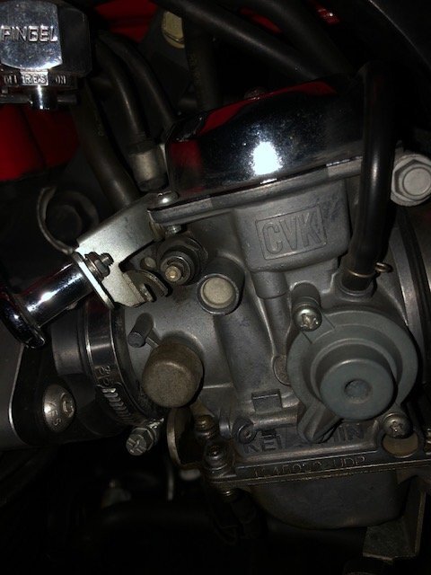

    I can see your problem.
    The sliding bar hooks into a plunger in each carb. The LH hook has detached. Consequently only the RH carb is getting enriched.
    Check it out.

    Great spot, and probably the main culprit:)
