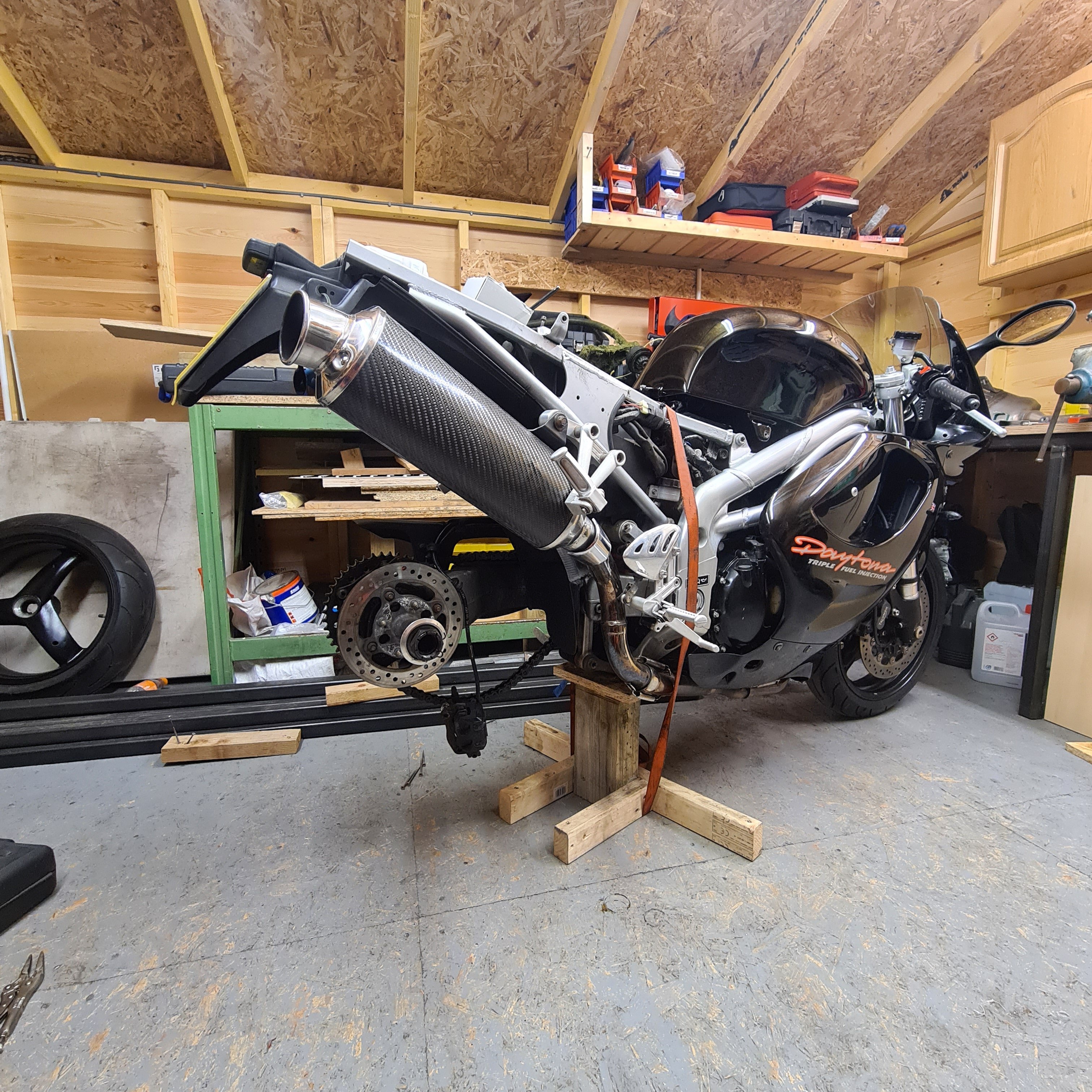

    Got the bike lifted onto the most cowboy of stands tonight, I'm in the middle of making an abba skylift style stand but figured getting the daytona through an MOT was a more pressing job so looked out my old stand for holding up my old bike to get the swingarm off. Wheel bearing is smoked so definitely needs done. Does anyone know the actual size of C spanner the chain adjuster takes? 20210324_215754.jpg

    Cheers pal, I think I'll have a look and borrow some c spanners from work around that size and see what fits and get one ordered the right size as I didn't get the toolkit with the bike
