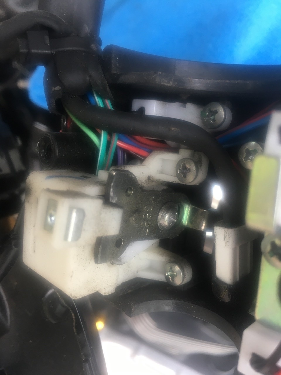

    Smallest rubber was cut in half to disable the indicator switch function.

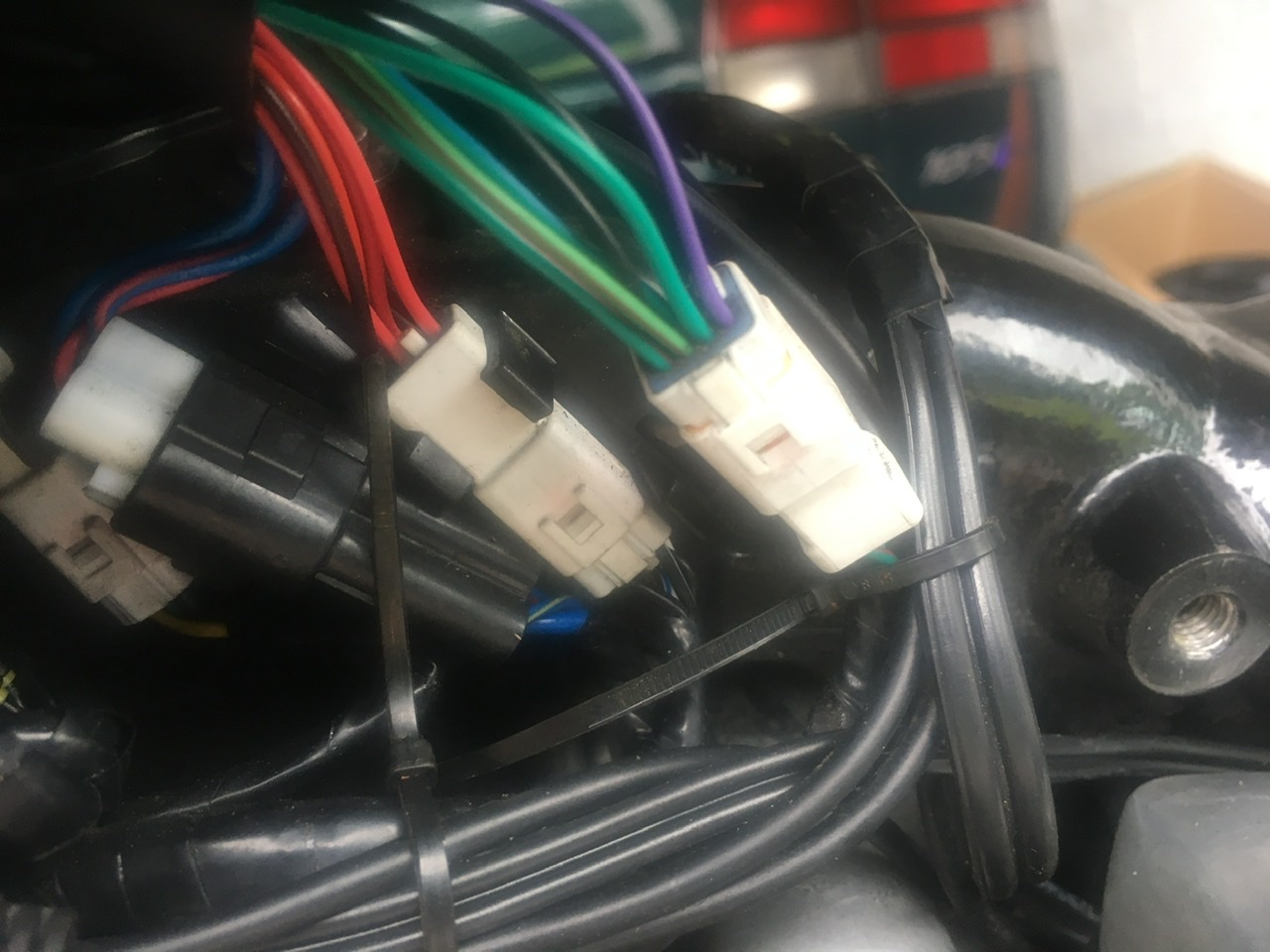

    I placed the unit under the frame (tank removed) and ran the cabling through the bikes cable tray on the left side to the control wire connectors at the back of the tank.
    Alongside the turn signal, are power and earth wires (red and black) to complete the installation.
    Removal of the switch unit allowed the rubbers to be installed in the end to force the activator back to the centre.

    Once I identified which wires, the ST2 install was simple. I would have preferred spade terminals but the bullets work ok if you hold the male for plugging and unplugging.

    But when I took the switch off the handlebars it looks nothing like the switch they show in their installation video. I can't see where I would put the wee rubber stoppers. My switch looks the same as your Speedmaster. Where did you put them?

    Aha! I've found the slots on the underside of the unit.
