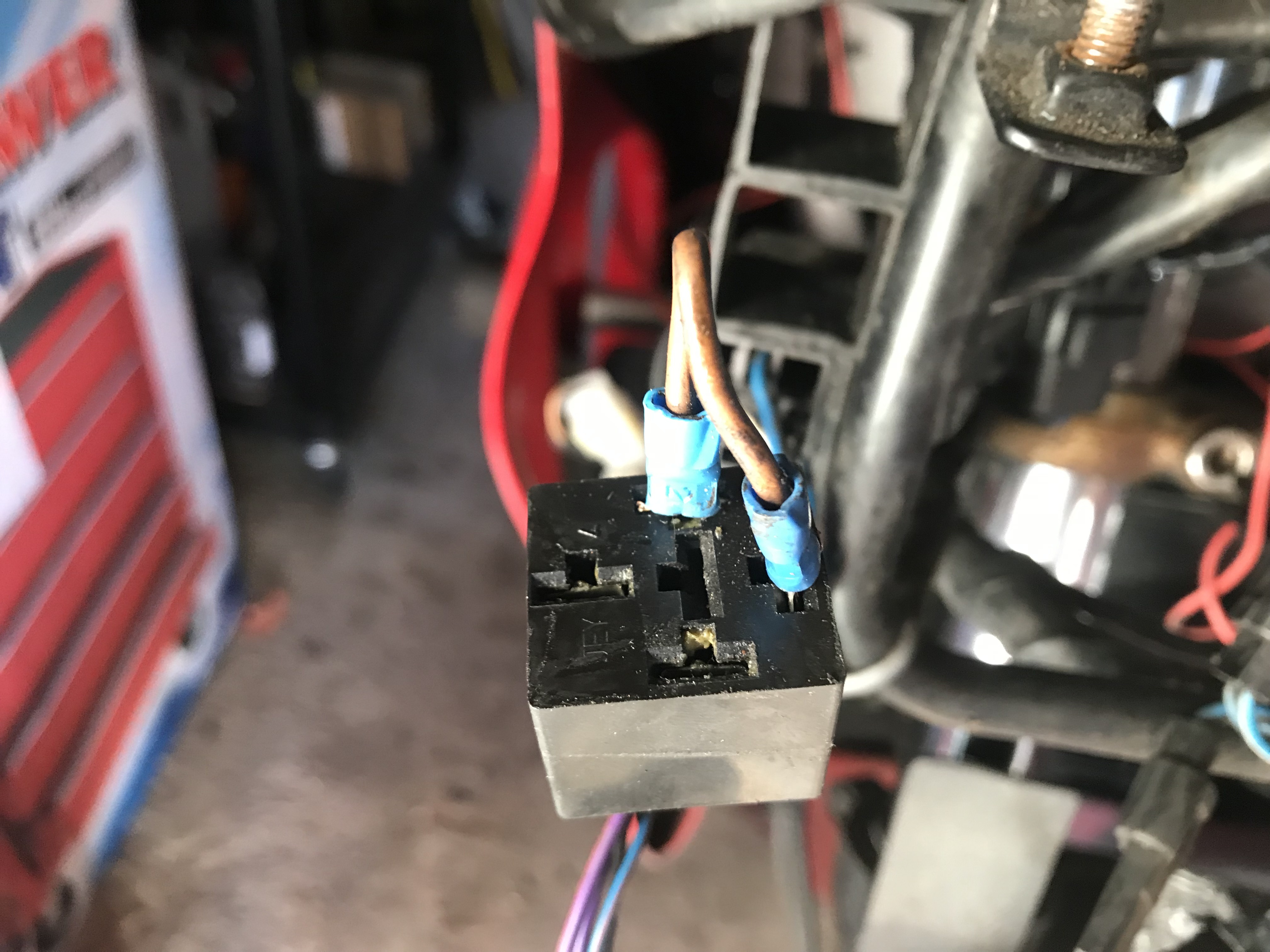

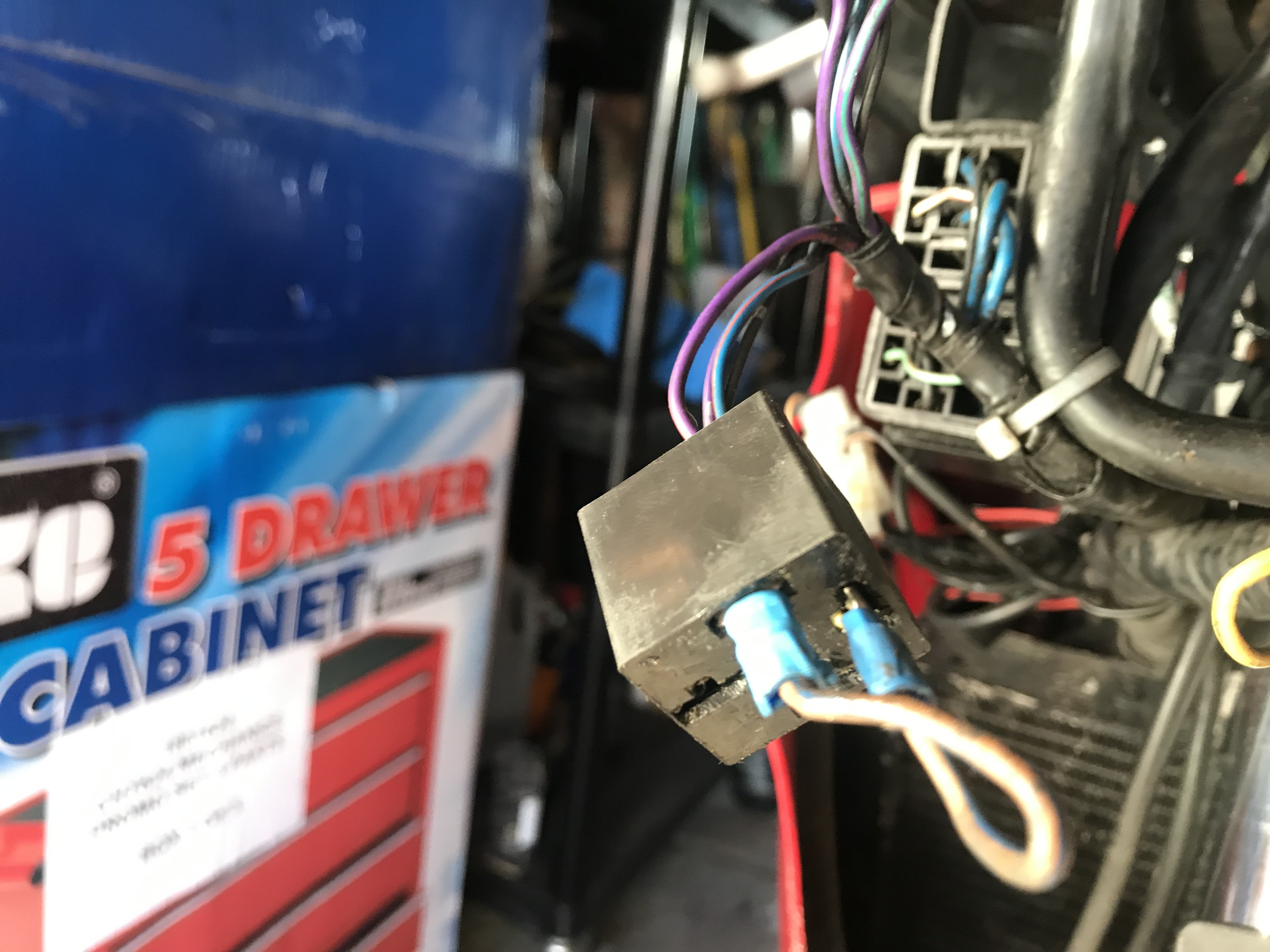

    Well I took the nose cone off to check the voltages and found that both headlamp relays were missing (see pics) and someone had bridged the supply wires with a small wire. I found an old relay plugged it in and I suddenly got 12 volts at the headlamp plugs! So off to get two relays!

    Not quite the end yet! I plugged in both relays and...... only the right hand dipped/high beam worked. I know you can get both to work so must be some more wiring to be done I think. I'm sure google will come up trumps!

    Oldyam its definitely a 99 as it was registered in April 1999 so was probably built the back end of 98. I think its going to be a cable break but finding it is going to be a pig. I did check the fuses and one of them for the dipped beam had obviously been a bit warm as it had melted the plastic a bit. Probably because of the bodge I found. No power to left headlamp but power from the relay (both).
