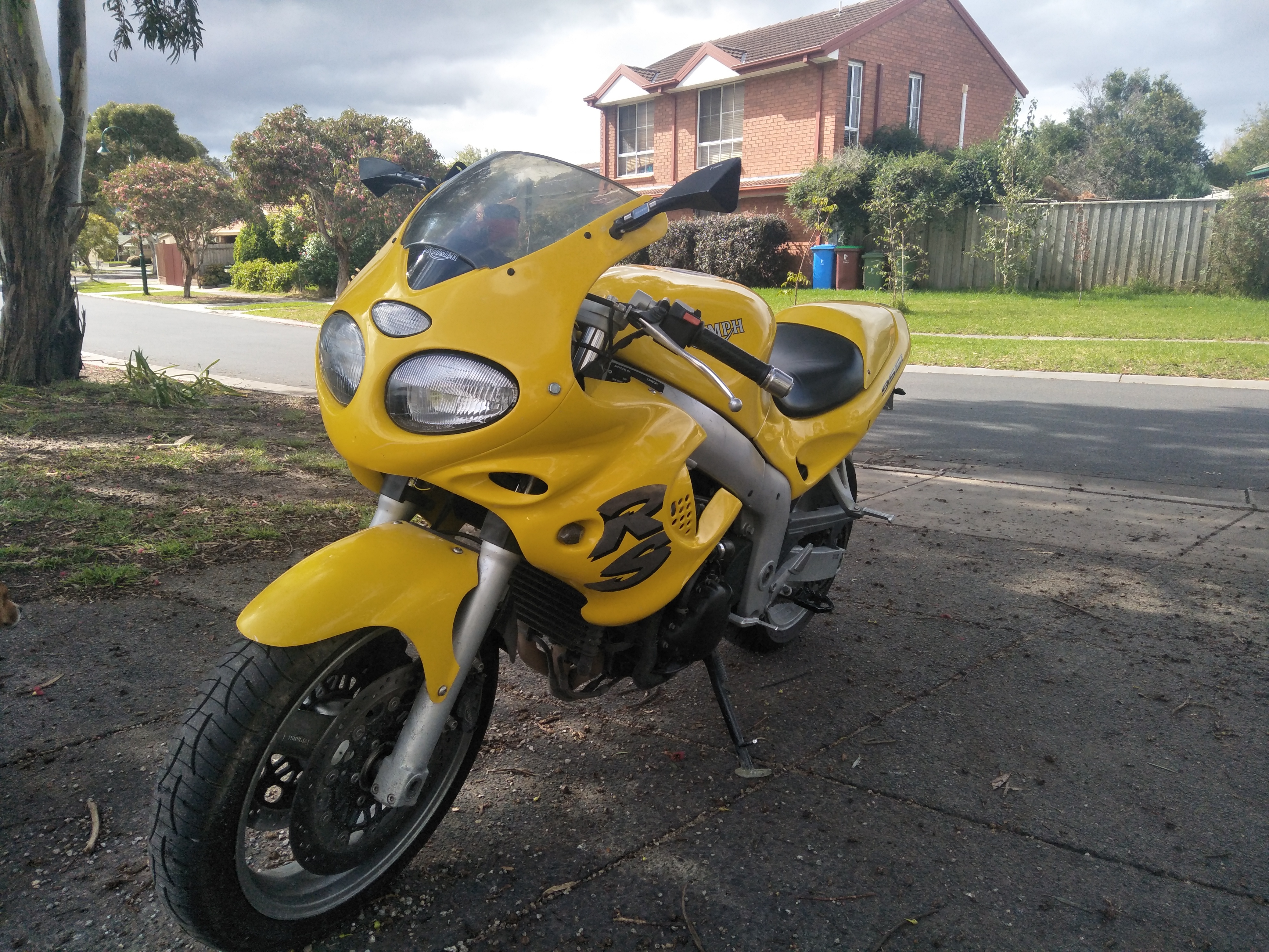

    As promised, here is my new beauty. The extra muffler came with the bike. Still have to iron out a few little gremlins. The other day it cut out on me at prolonged idle as temp rose (but below fan assist). I watched the temp readout while riding, and it seems amazingly sensitive to moving or stationary. Not sure if this is normal. Checked the coolant (OK) and oil (OK), then took it for a ride and idled until fan came on (103 deg, so OK) but the engine light is now on. Read somewhere that if only a temporary issue, the light will go out after 3 heat cycles. We'll see how that goes. Booked in for a full service in a fortnight..

    So the engine light was coming on because the battery was not charging. Surprise, surprise. Reg/ rec needed replacing. The guy who sold it to me probably thought (like most who don't research) that stator was on the fritz. All's fair as they say... Cheap st1050 ($40) one on ebay and all good. Wasn't a daytona engine btw.

    Glad you got sorted. Nice steed always does look good in that yellow.
